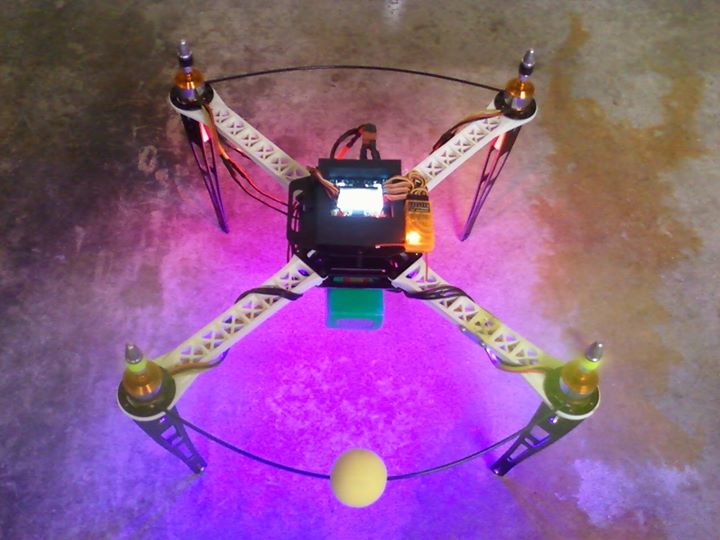

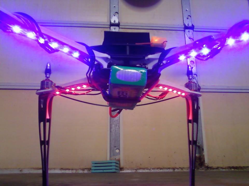

A couple of pictures of Carlos's sons quad after putting in some LED lights.
