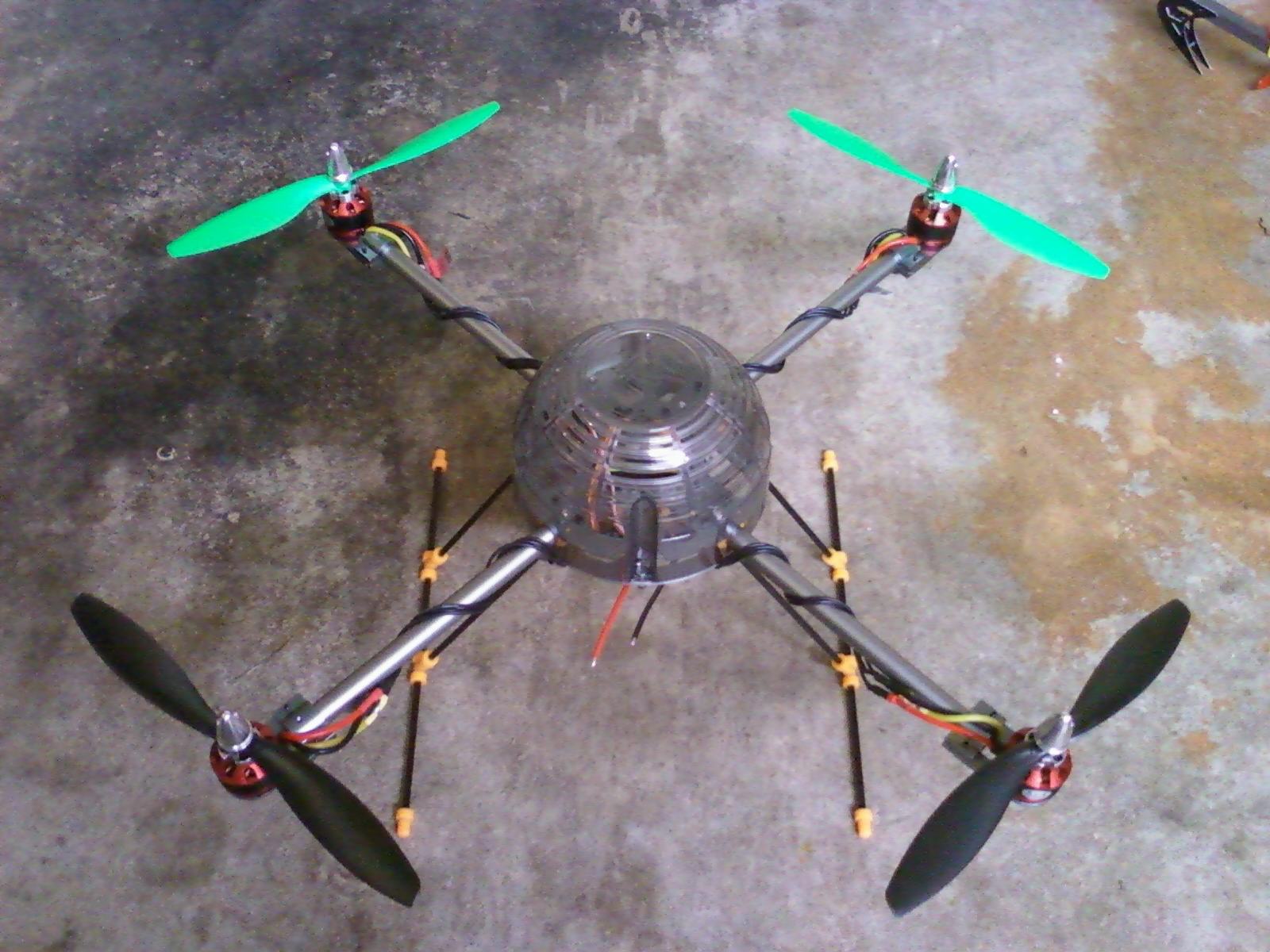

Meet H.A.L. :D
The latest quadcopter build while Carlos is on vacation.
FirePower 480 (sport) motors all around (1100kv)
4X25A ESC Block "Q-Brain"
10X4.5 props
According to the prop data... about 22A at full throttle.
(which won't be very often on a quad so it should be just fine)
HobbyKing's Ardu Pilot Mega 2.5 control board
Spektrum AR8000 w/ satellite AND telemetry unit.
Future GPS upgrade soon to come. ;)

Postby Neons » Sun Mar 09, 2014 9:18 am
looks good. Seems like it may have a strong frame. Try to get the multi well trimmed and a few flights before flying it at the gym.
I am still plagued with my 450 sport multi I flew at the gym. I had replaced all the Esc's and had a couple of good flights. Then at the gym she crashed while 1 foot of the floor and the motor toasted. I ordered a replacement mototor and after instal I plugged the battery in and the motor toasted again. I found a burnt chip in the Esc. I replaced that esc and I am waiting for another motor. Hope it is ok next flight.
I just ordered a Turnigy 9X transmitter without the module. I am installing a Corona 2.4hz DIY kit in it. I also bought a APM 2.5 v2 board. I still have to convert the battery to Life or a lipo in the trans. My DVR just came in and I have to put that in my FPV ground station also.
I am waiting for the weather before I start my long practice to fly FPV. It is best with the copter trimmed and no wind first. Drifting in a copter is hazardous.

Postby HitNRun » Sun Mar 09, 2014 12:13 pm
She seems very well designed. Good and sturdy construction from what I could tell throughout the build. Mostly aluminum with a few pieces of plastic and CF mainly in the landing gear. I want to re-route the ESC wires through the booms though, for a cleaner look. Other than that, it's just tuning the APM board and making it as docile as possible so it lasts longer than 30 seconds in Carlos's hands, lol. :D
I got his last (black) quad flying very well now. Nice and docile as well so he literally HAS to hold the stick to the side to make it crash. ;)
Strictly an indoor flyer or outdoors in winds under 10mph. (For Carlos anyway) For you and me, we could fly it in up to 25mph fairly well. It's VERY stable.
Although, when out of SL mode, it's still quite acrobatic in the air. Almost TOO much. But I recommend Carlos keep it in SL mode at all times. ;)
