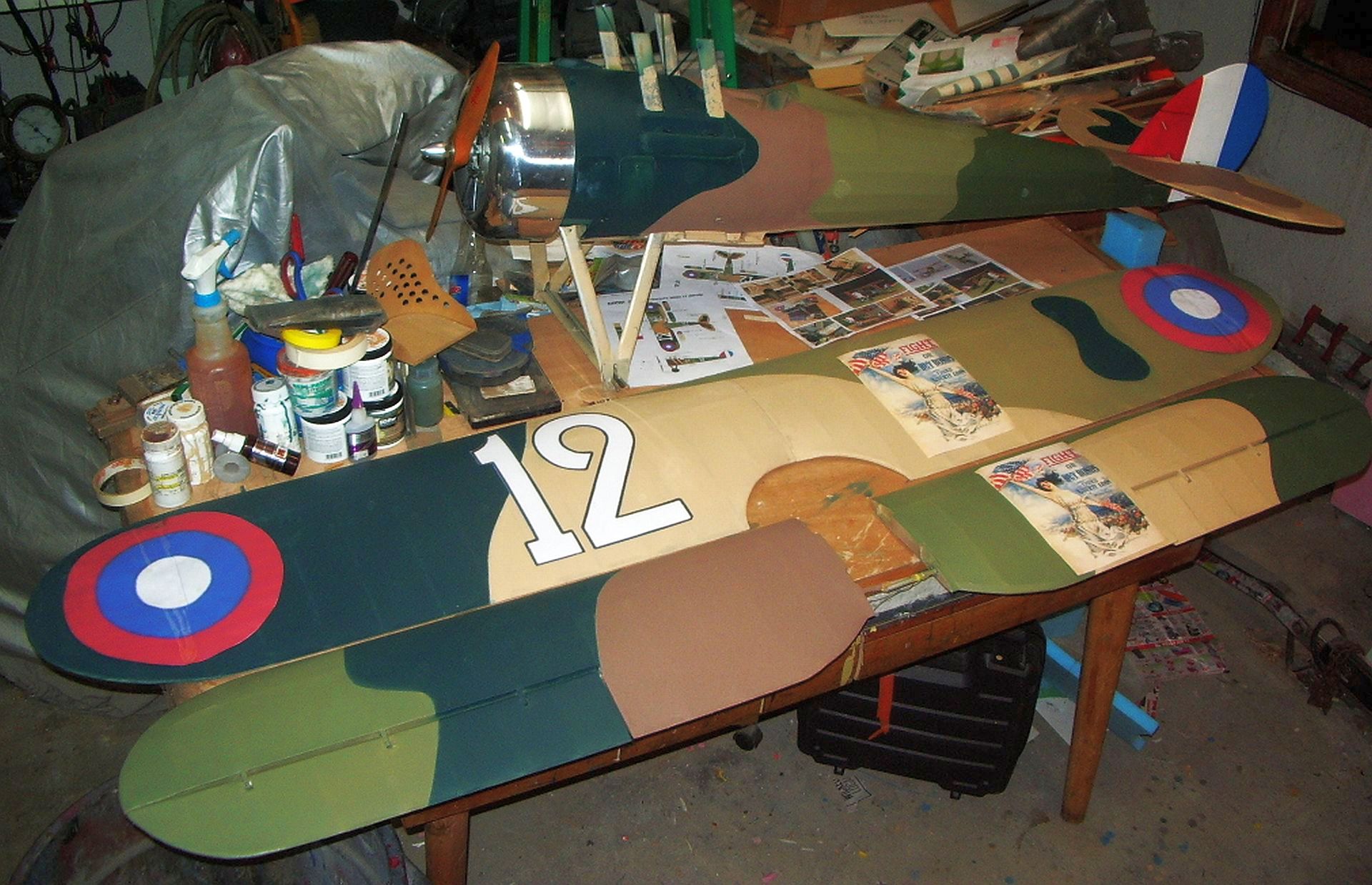

Decals placed on the Eddie Rickenbacker Nieuport 28. as the original had them.
