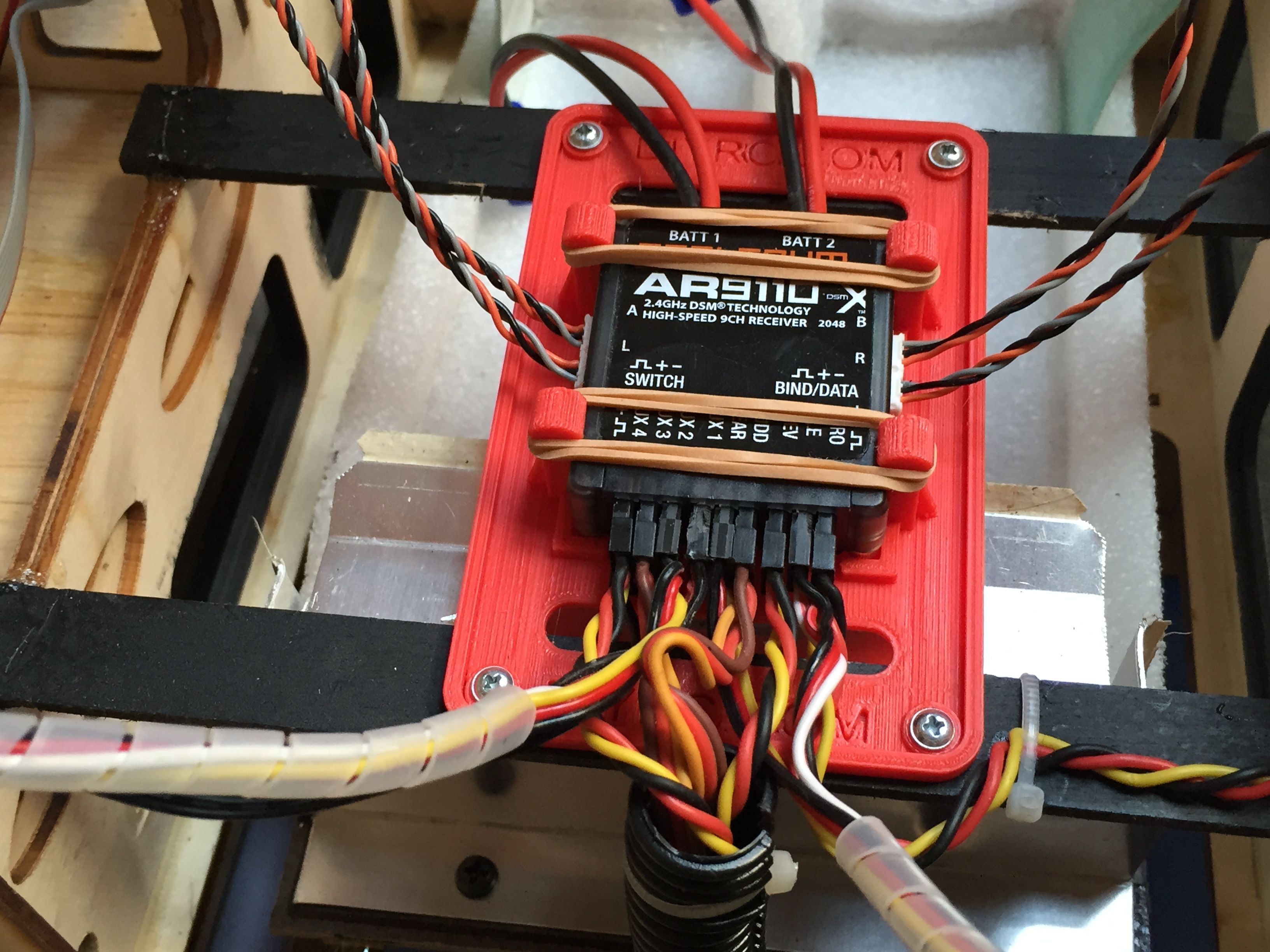

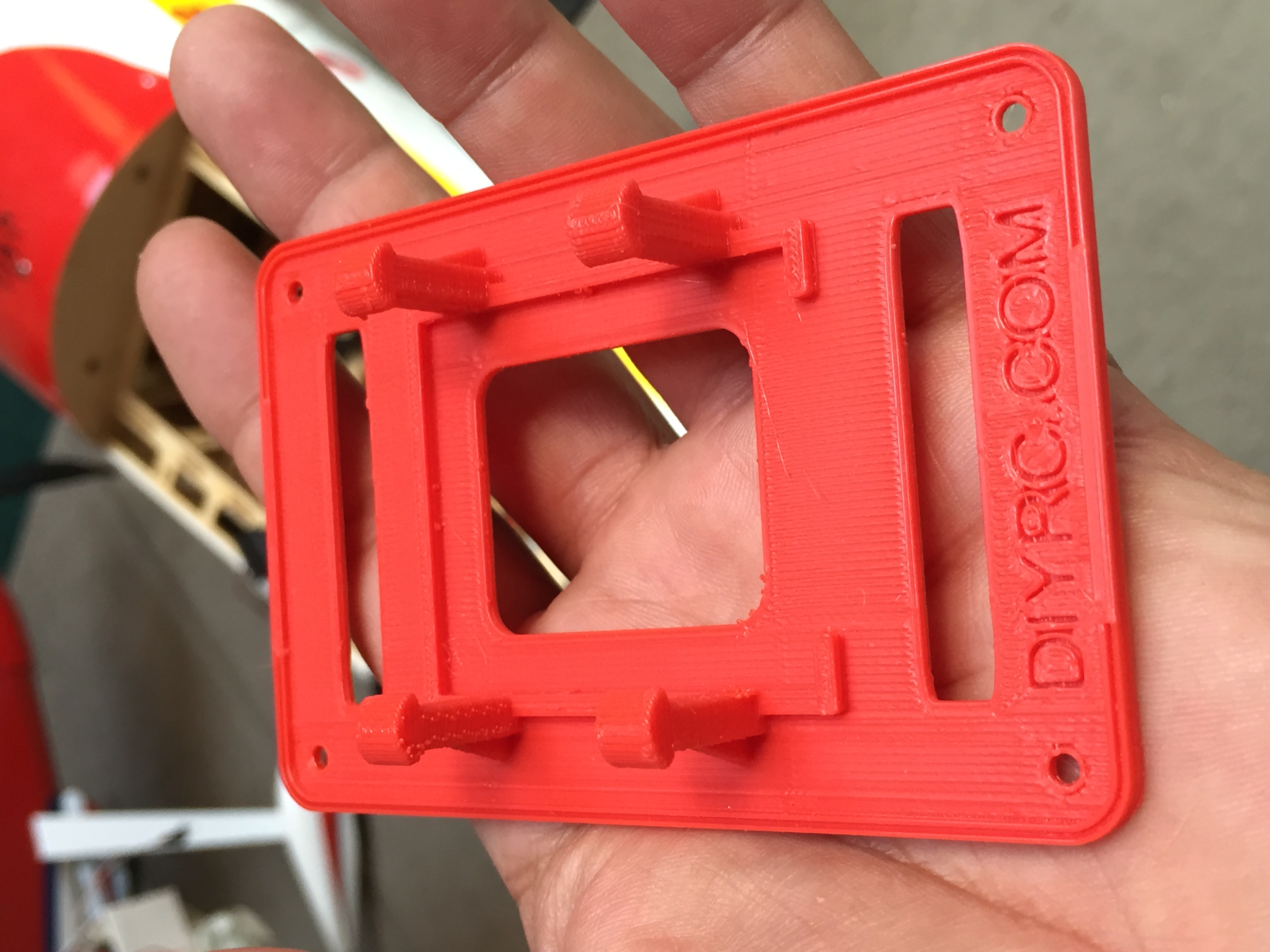

So, below are a few things I made and printed... one being a cool Spektrum receiver tray (looks like a Powerbox but it's basically a receiver holder/tray.... another is a cool servo lead clip for keeping those Hitec/Futaba leads attached when inflight... One vid below shows the printer (lapse) printing a neat charger/discharger box with 4 legs... and lastly, I attached a cool vide that shows how the servo lead clip was designed and how it works... the ideas are endless... can't wait to retire! :)
