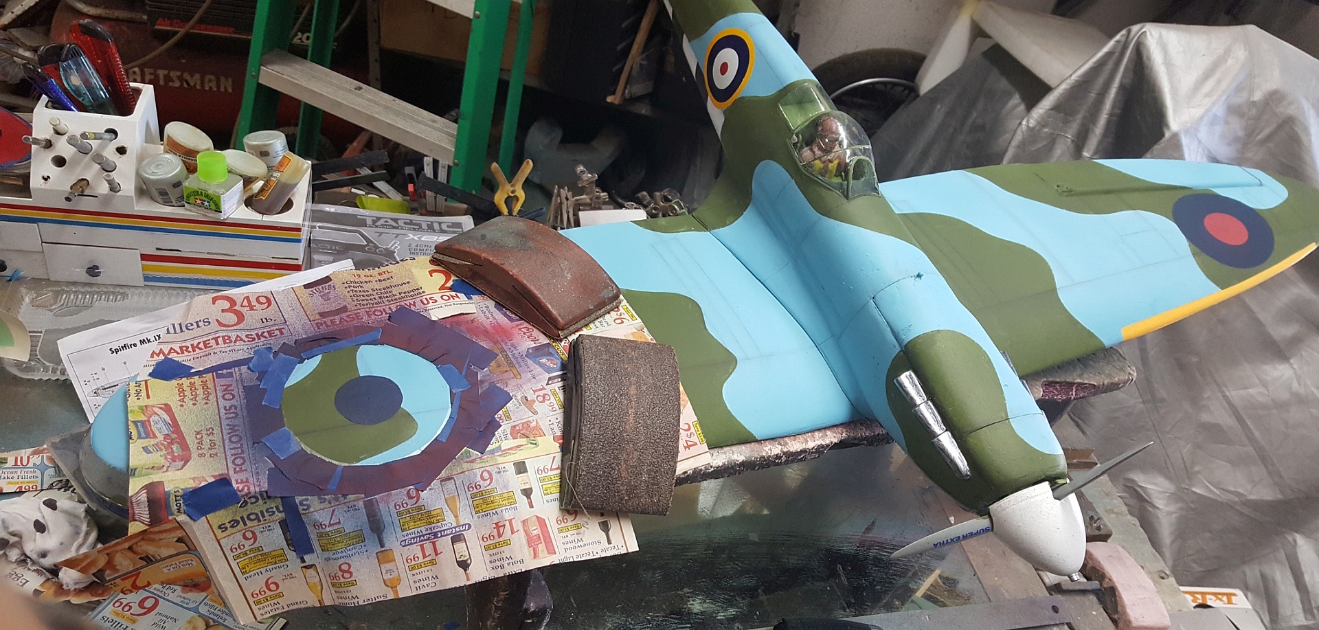

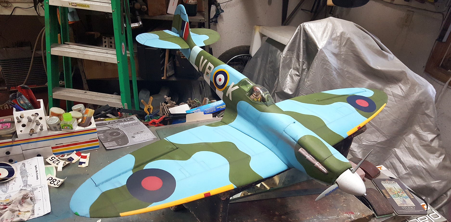

I have added all the decals that were fair condition after touching the up with clear enamel and let dry. I tested one and it was cracking apart. I to spray them to hold them together to make the transfer, The wing decals were the wrong color for the applications. I masked the wing and sprayed them on using Frisket paper.
After touching up some flaws I sprayed the exhausts and some smoke from the motor. The only thing left on top is a light satin clear coat to seal the paint from usage. I am almost finished. I have to flip the plane over and add the Invasion D-Day black and white stripes and spray the under coat color blue green sky color. Then touch up the panel lines maybe. Then I am finish with the build. I add my receiver and go fly.
