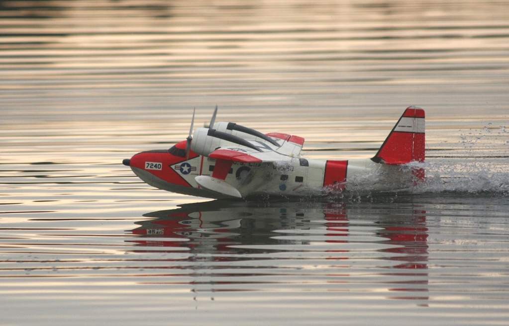

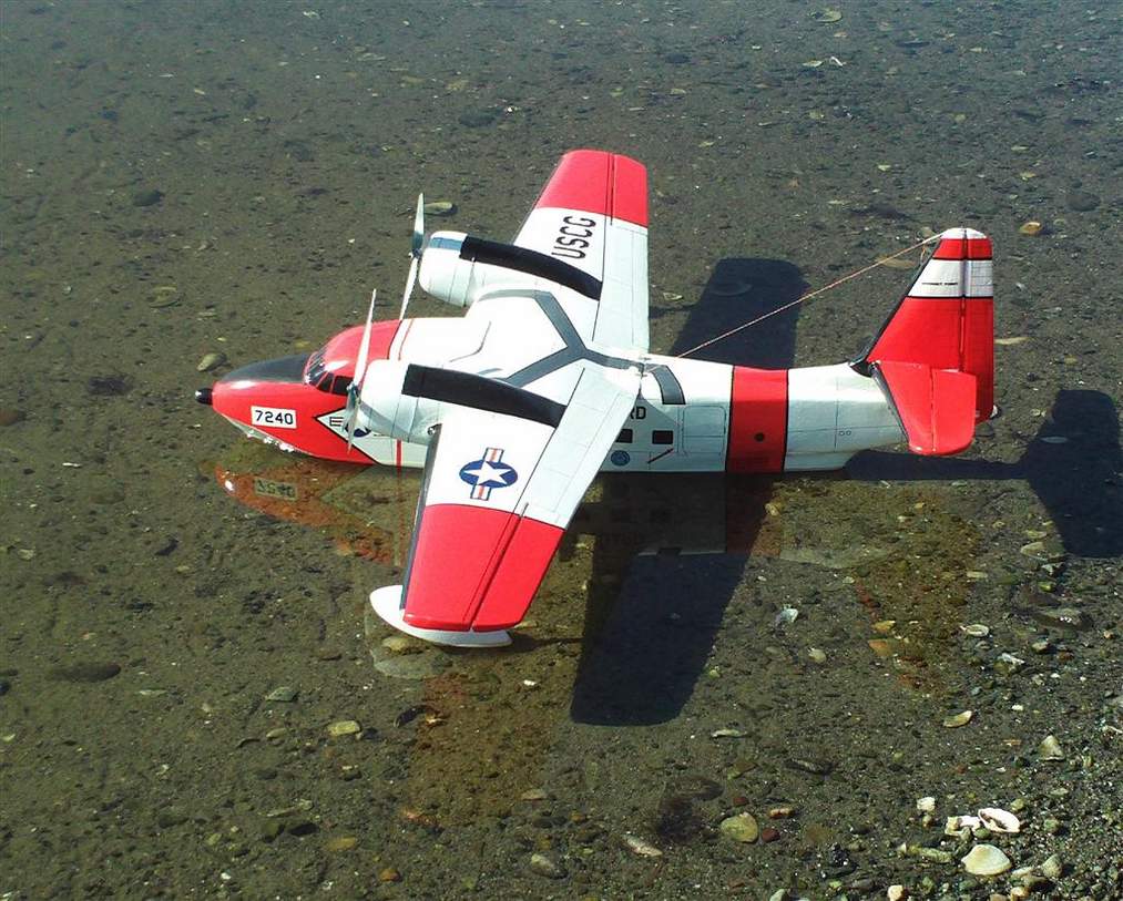

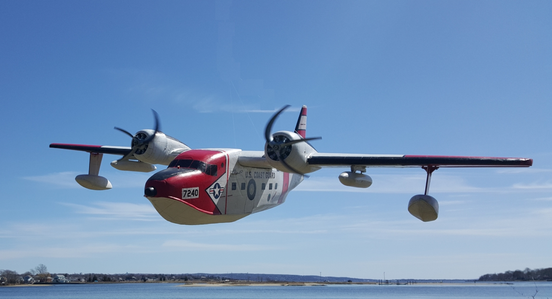

The plane has all the bugs out from the maiden now and it flies very scale like now. It is so pretty in flight. Very realistic look flying.

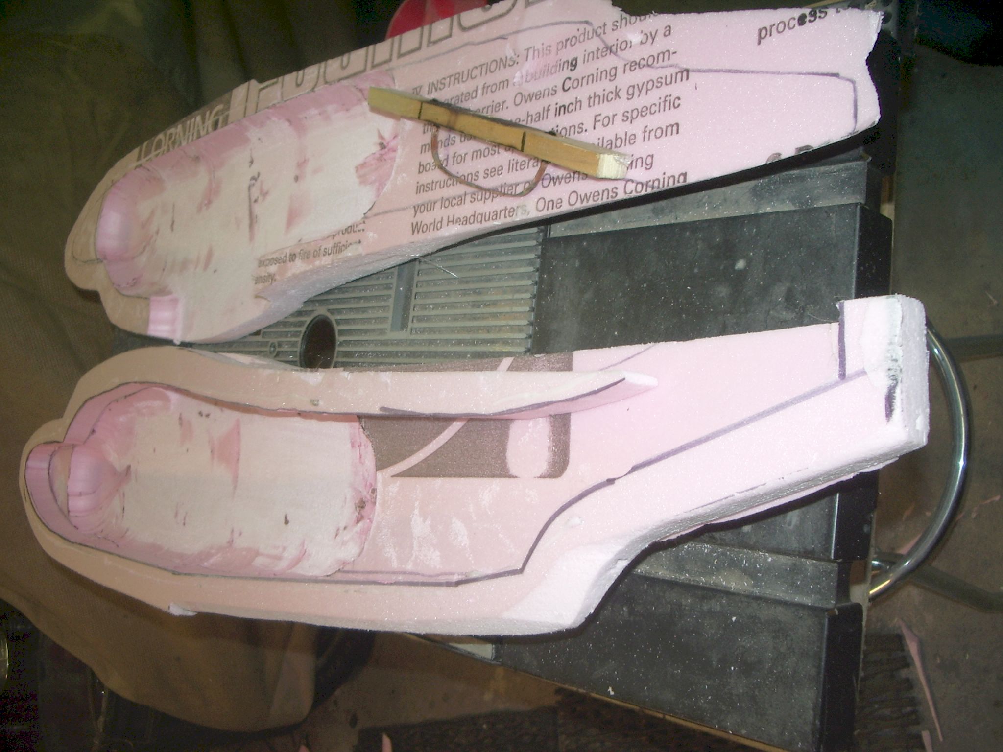

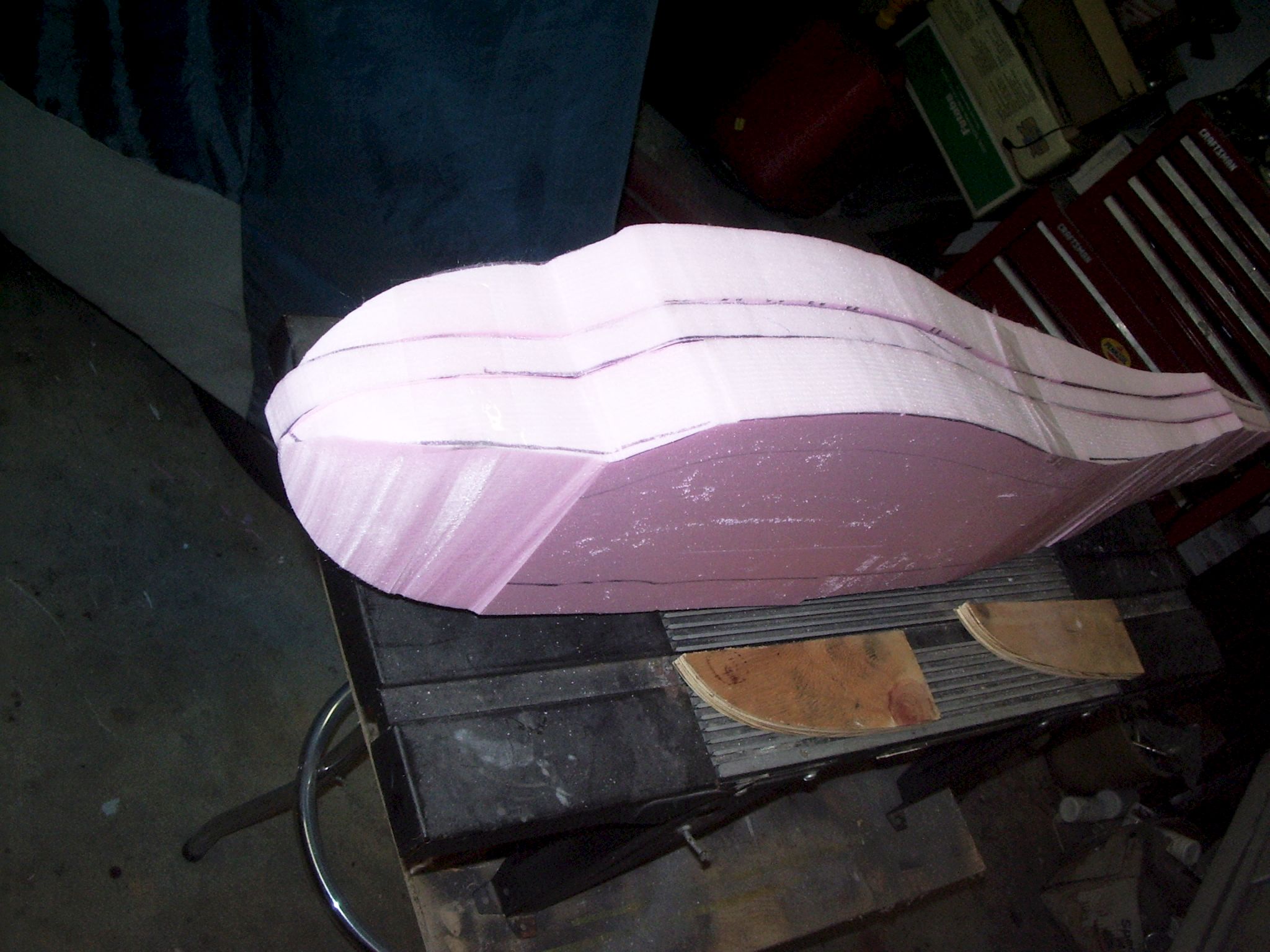

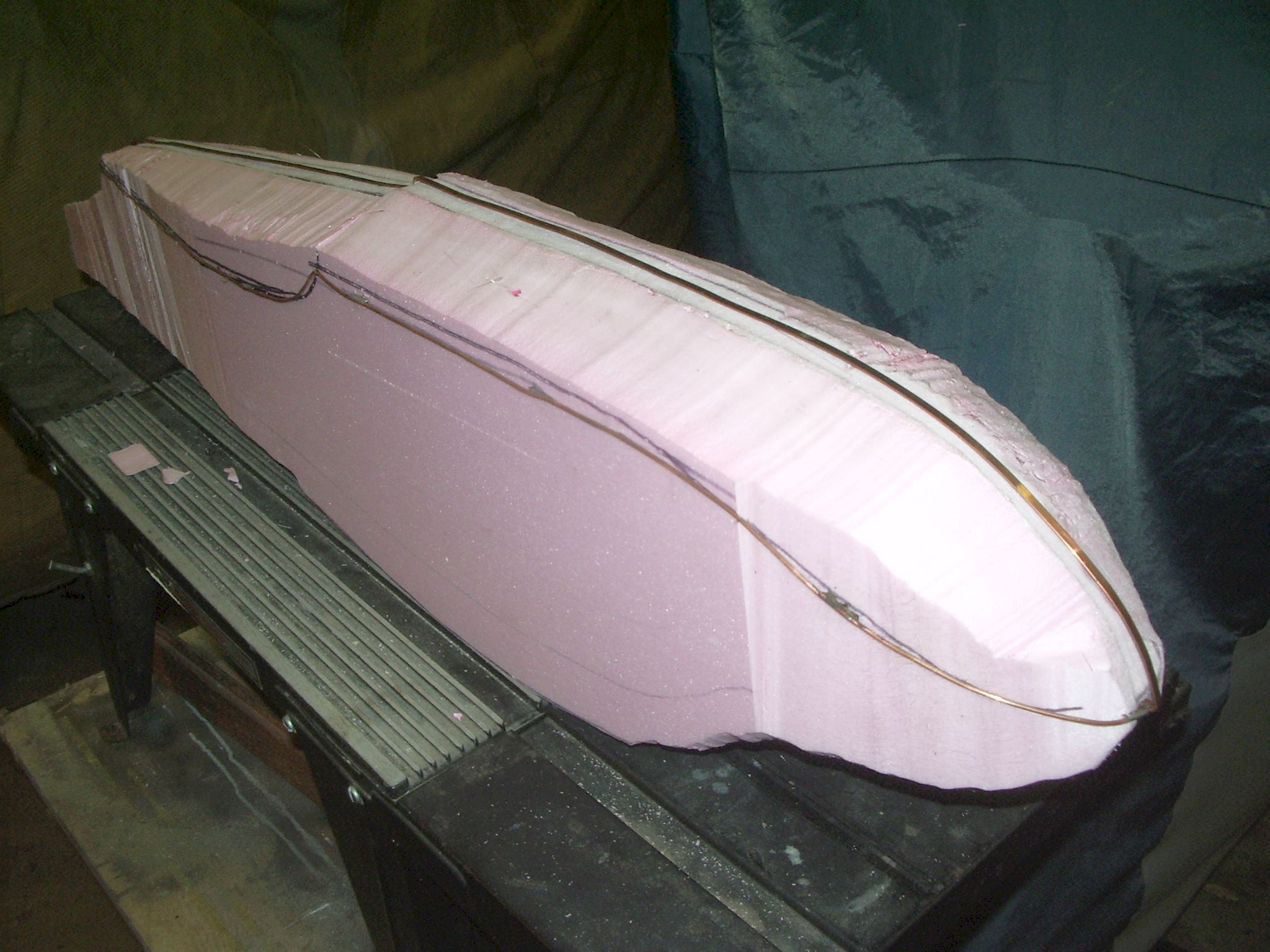

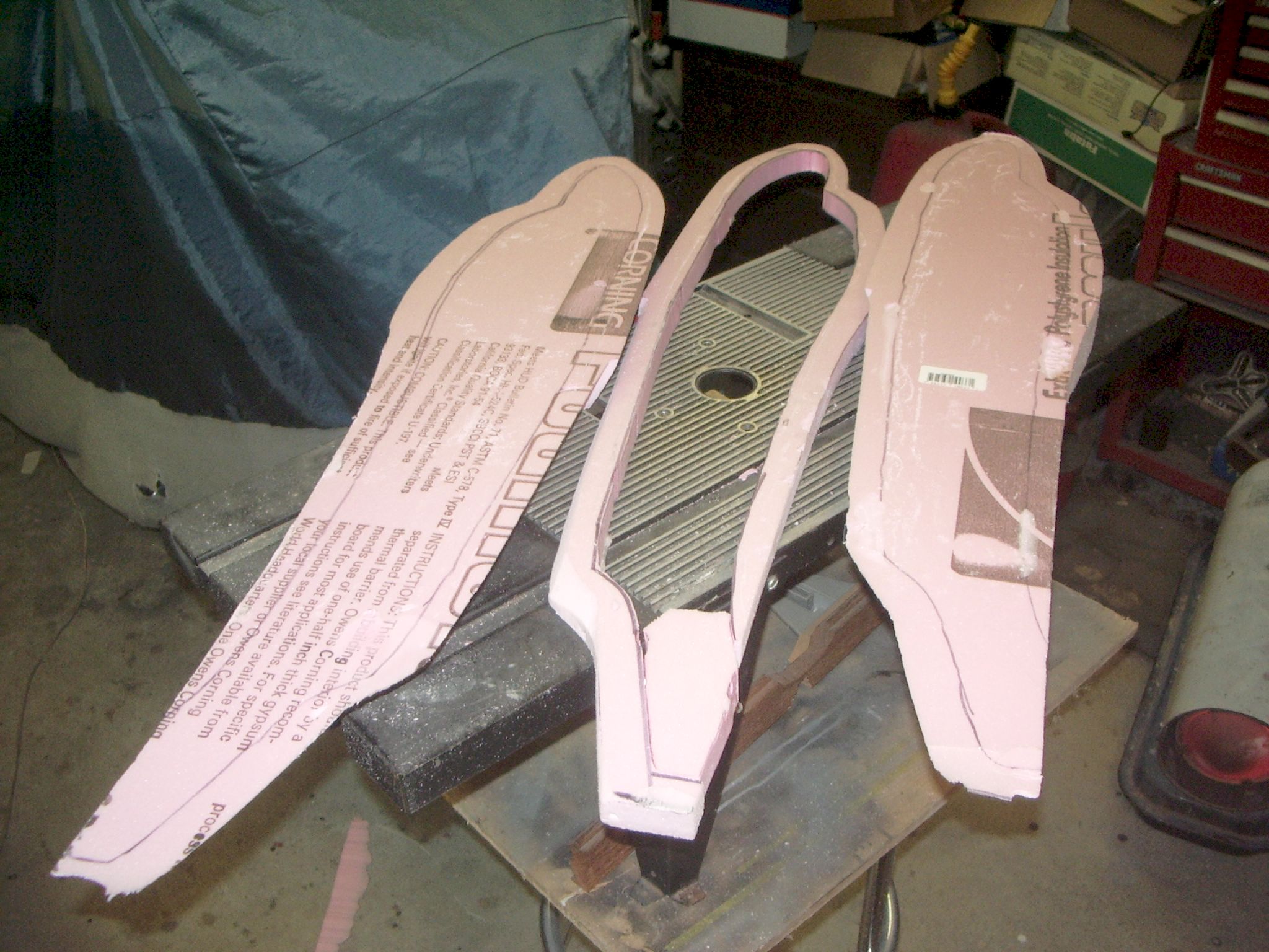

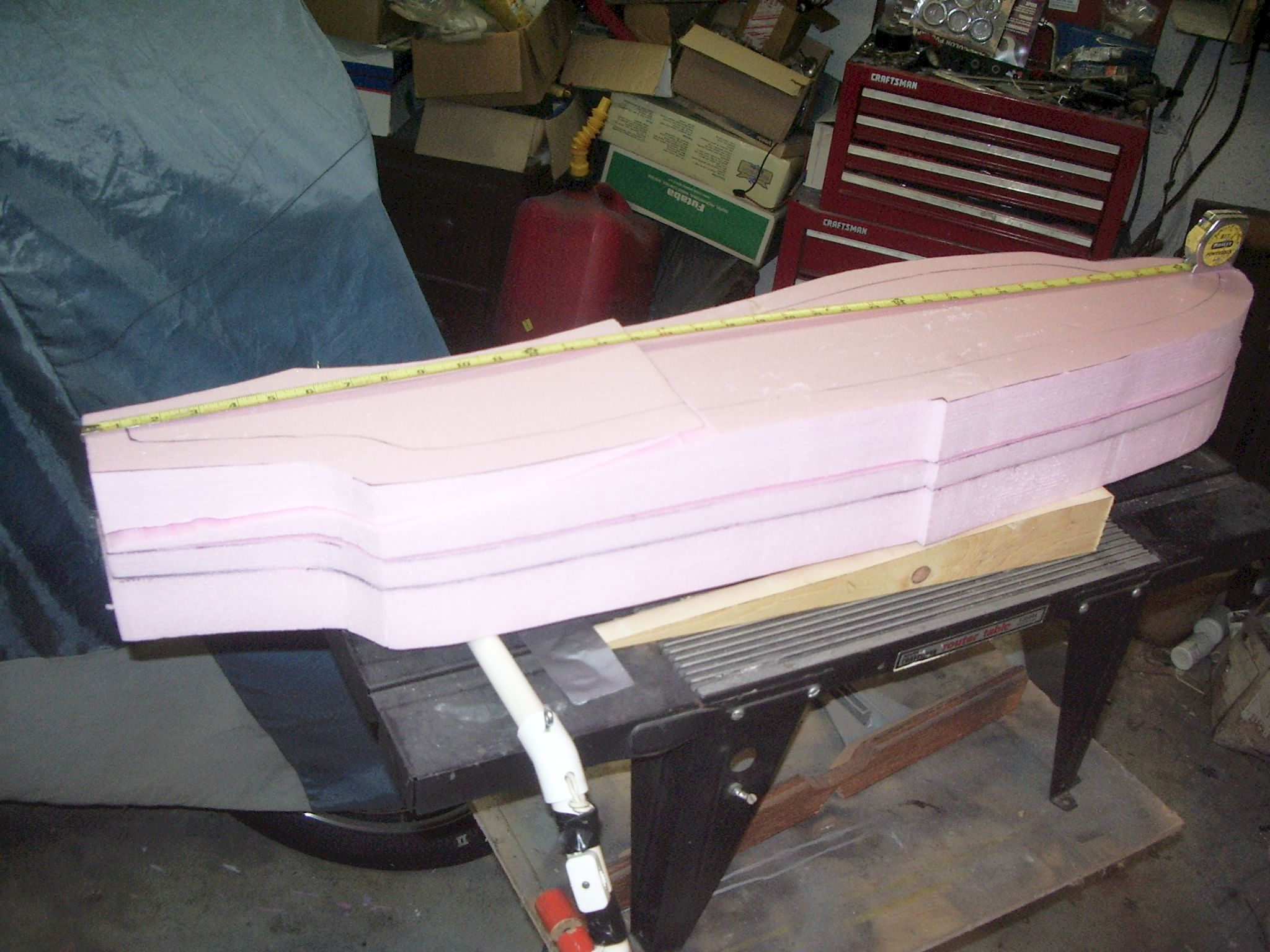

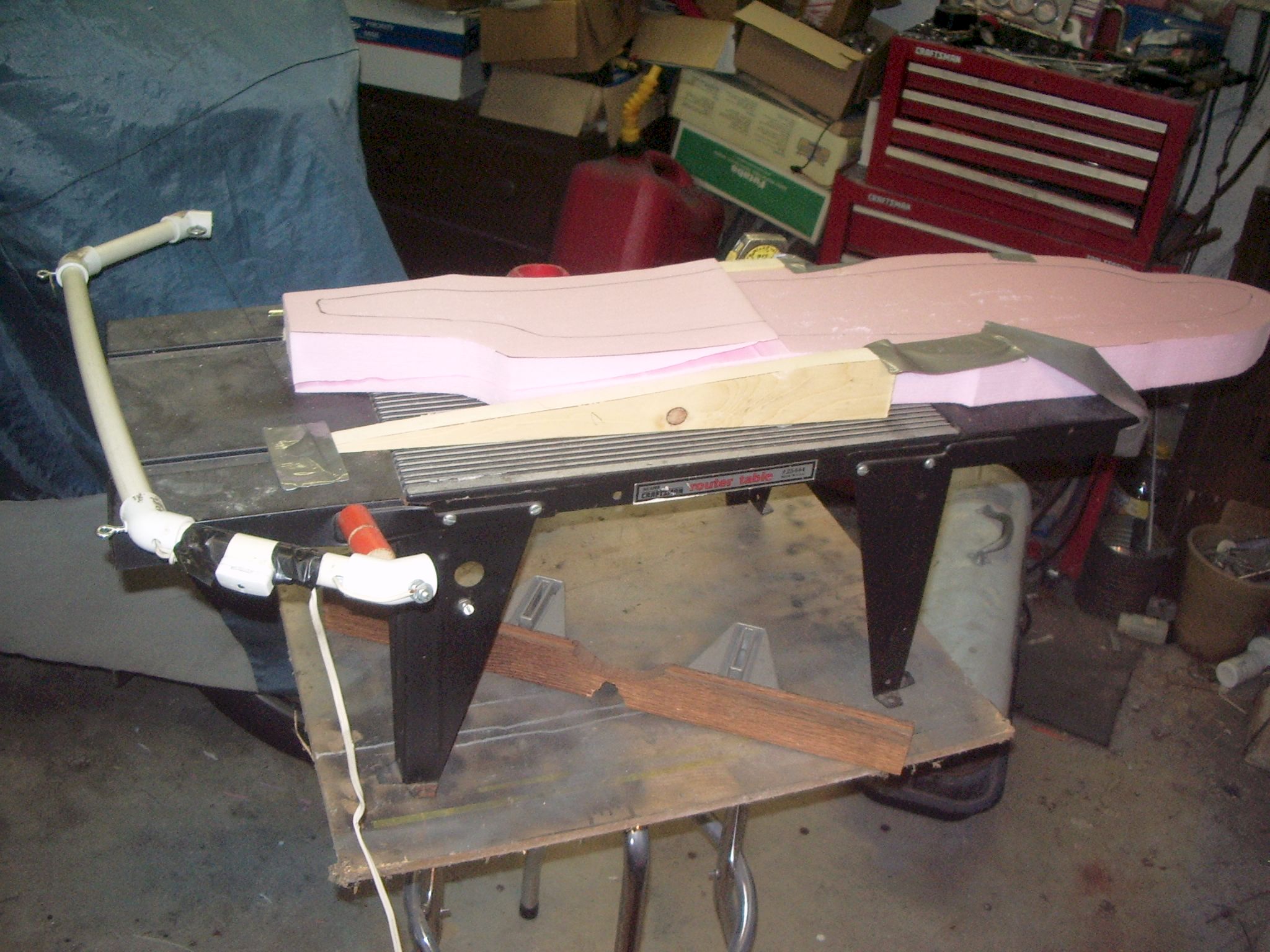

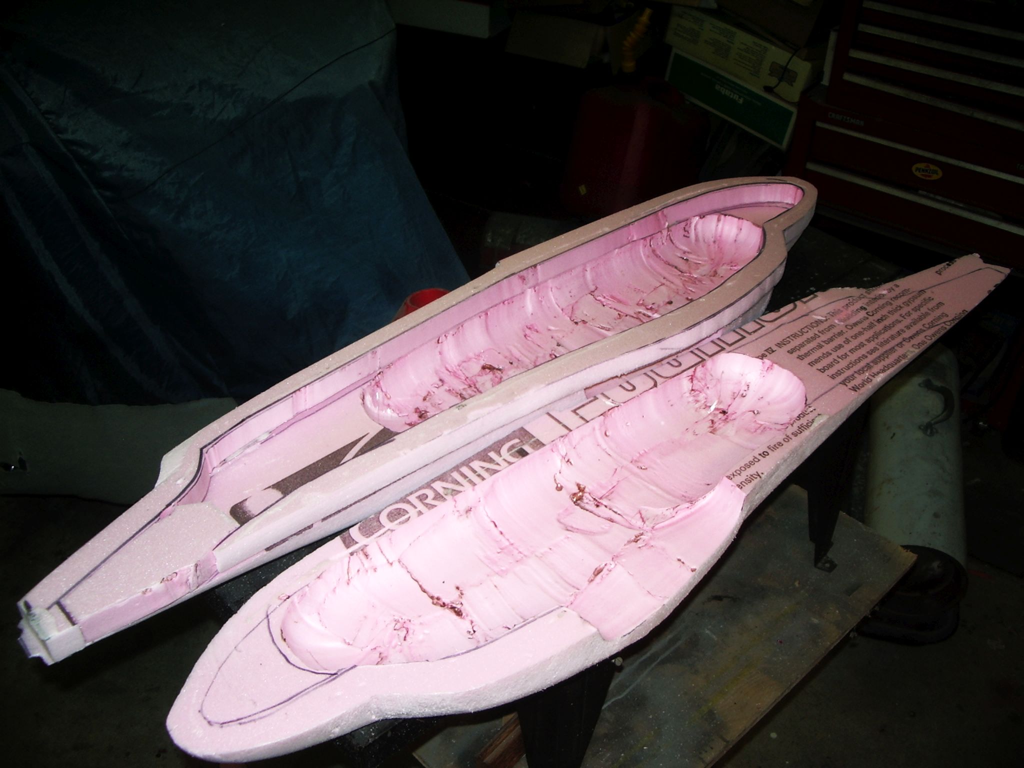

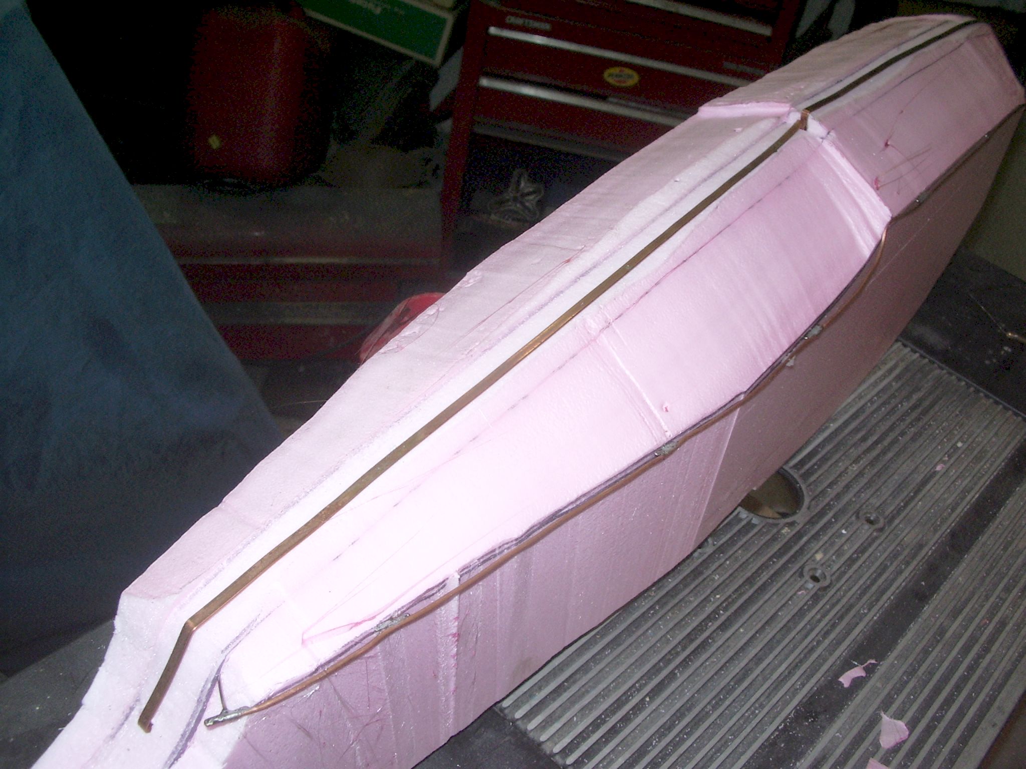

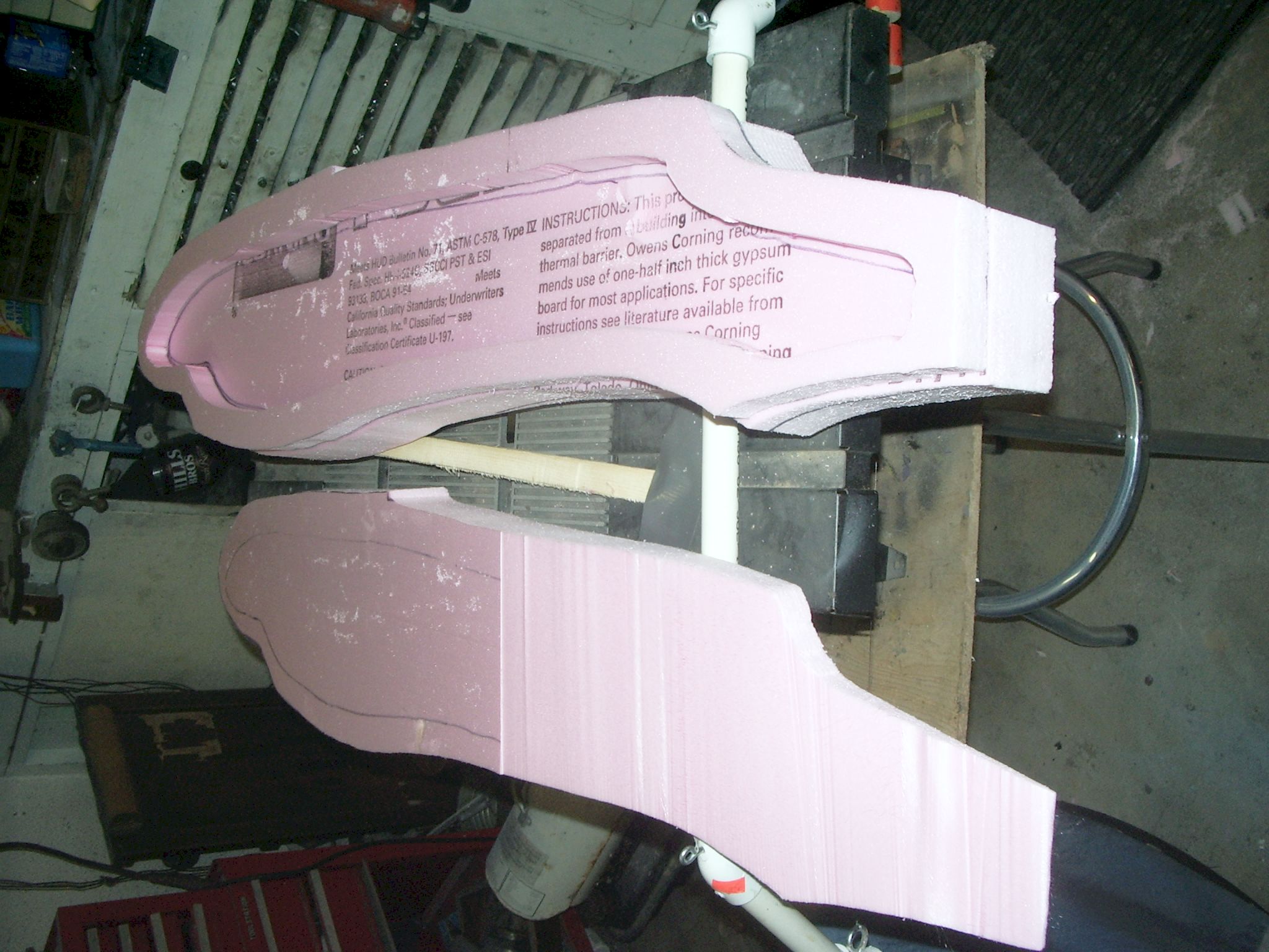

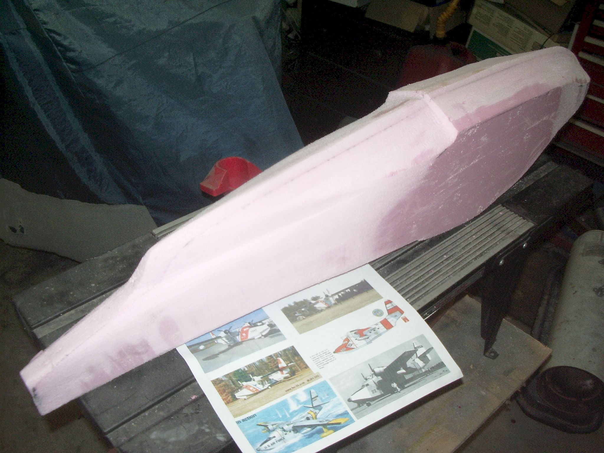

The Very Beginning - Started in 11-2008 Making the fuselage.
It was pink foam cut from 2-2 inch thick and 1-1 inch thickness sheet foam from Home Depot. It was all roughed from home made foam cutters powered by a train transformer with adjustable power switch. I gouged the inner fuselage hollow with a curved copper house wire.

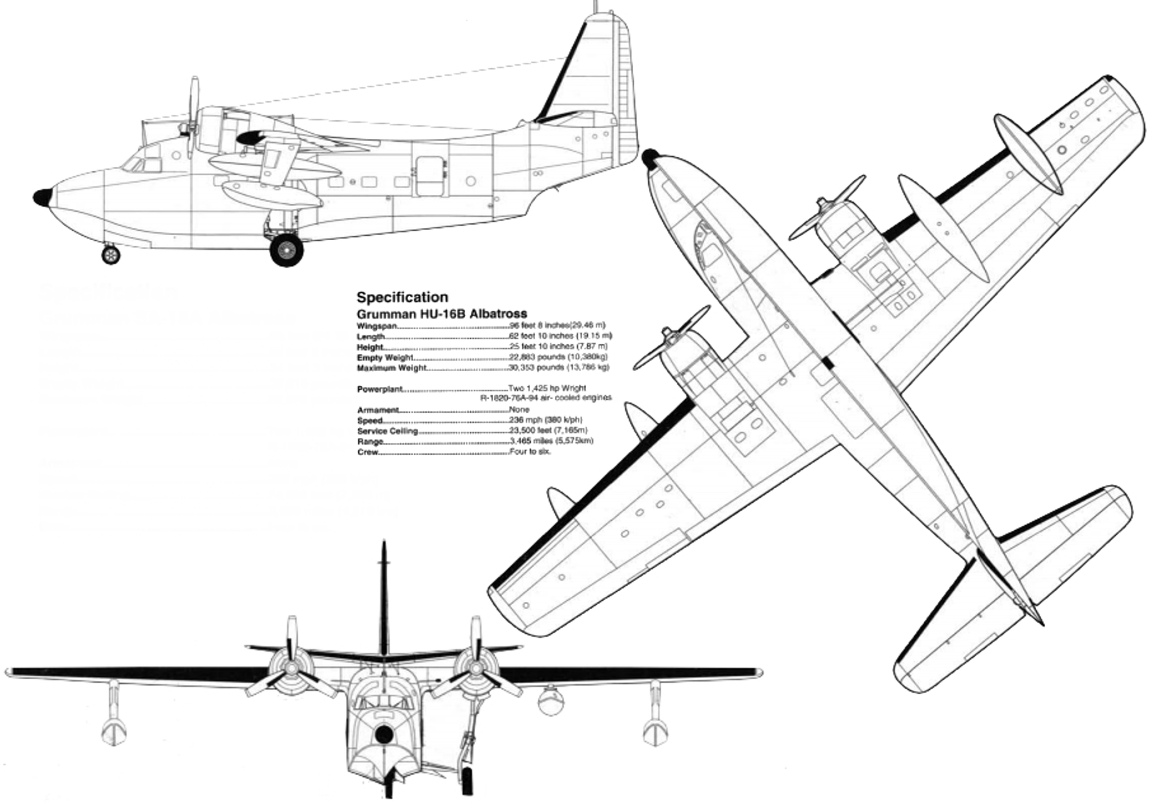

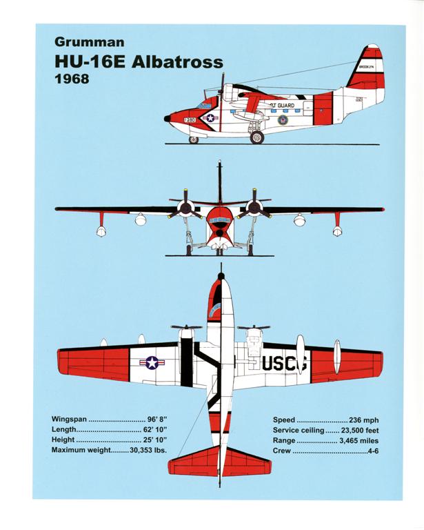

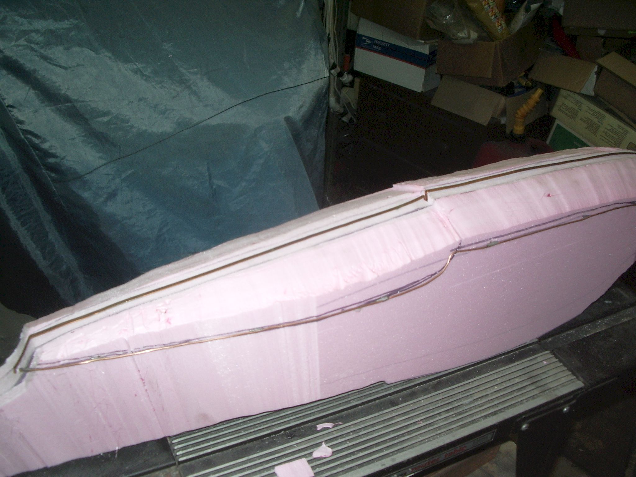

Heat the gouge with a torch.

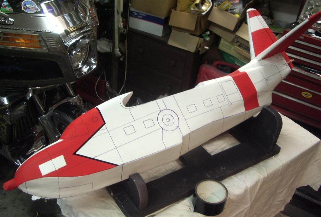

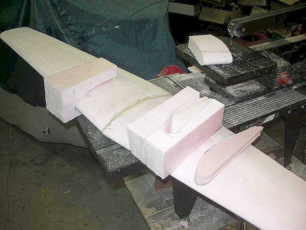

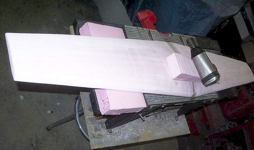

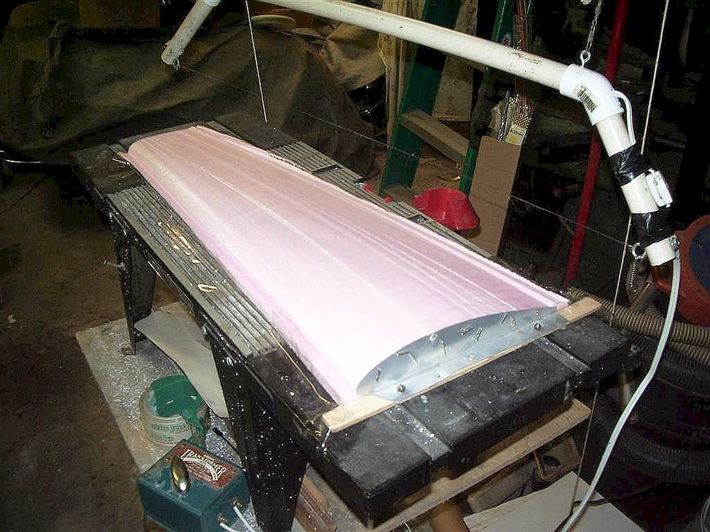

Hotwire wing halves
Hotwire wing halves

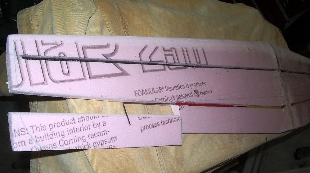

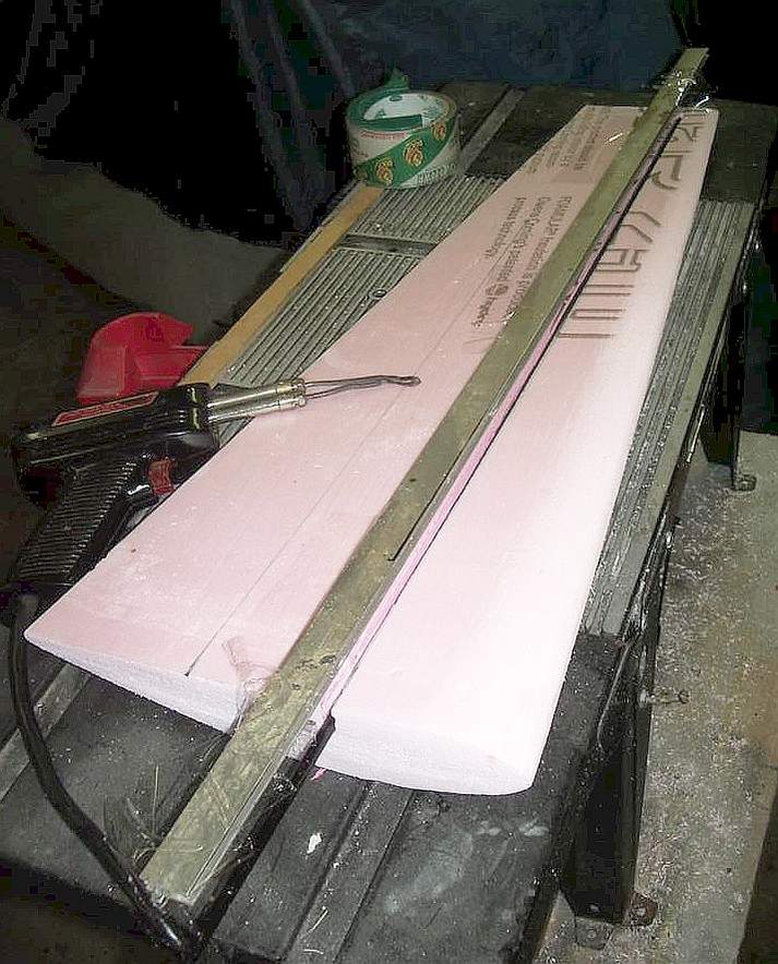

Use solder gun and metal straight edge to cut carbon arrow spars and wire passages

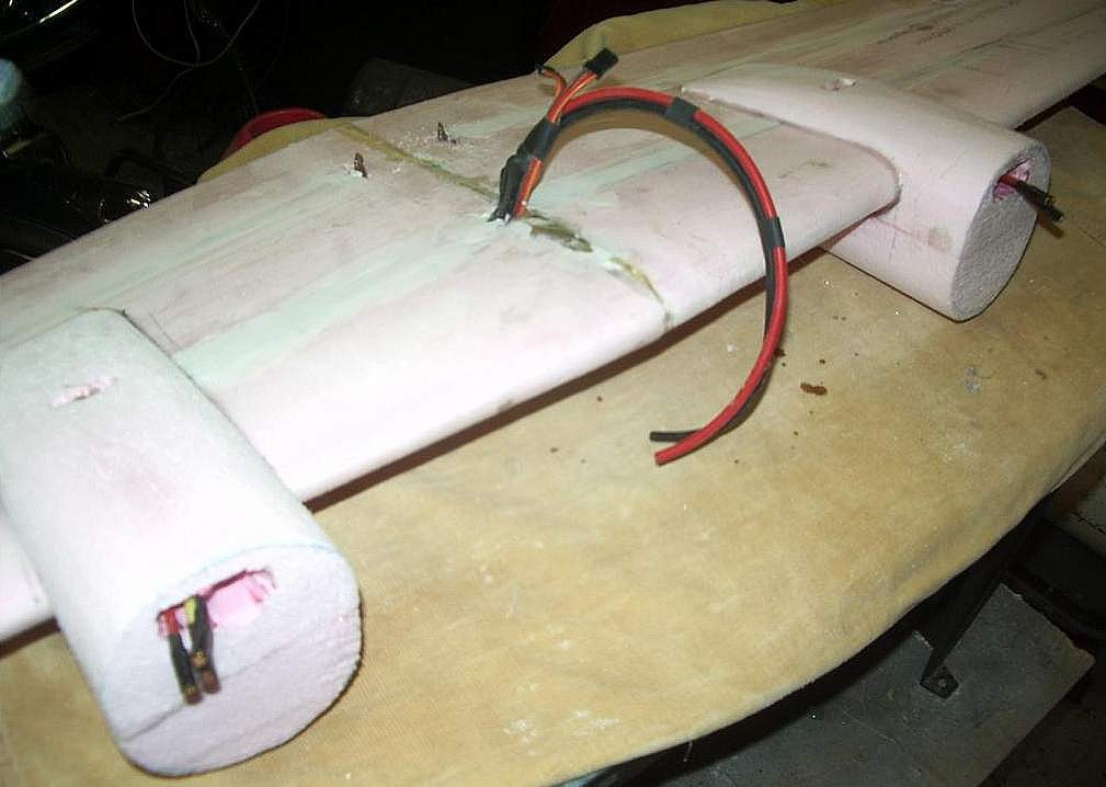

Carbon arrow in place. Another slot for the motor wires.

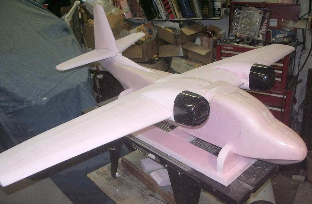

Rough nacelle blocks

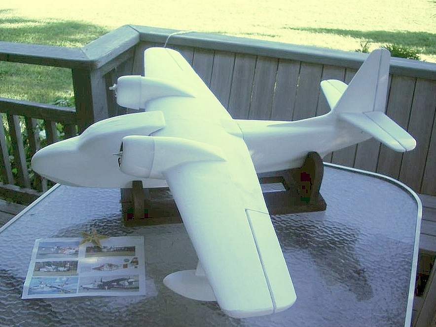

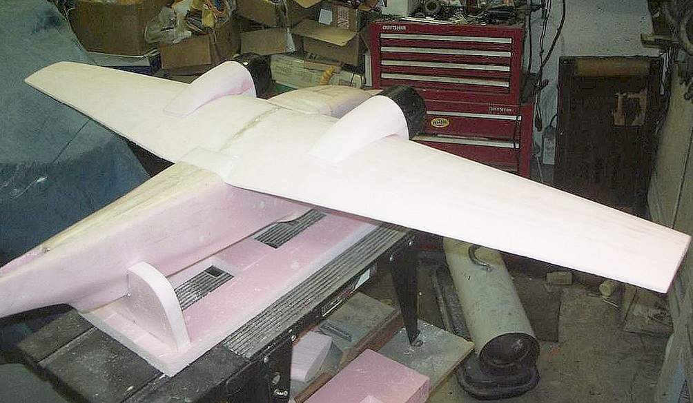

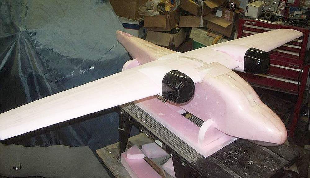

fit and blend the wing and shape nacelles.
Cowlings off a GWS Zero. Get cowlings at Park Plastics.com also.

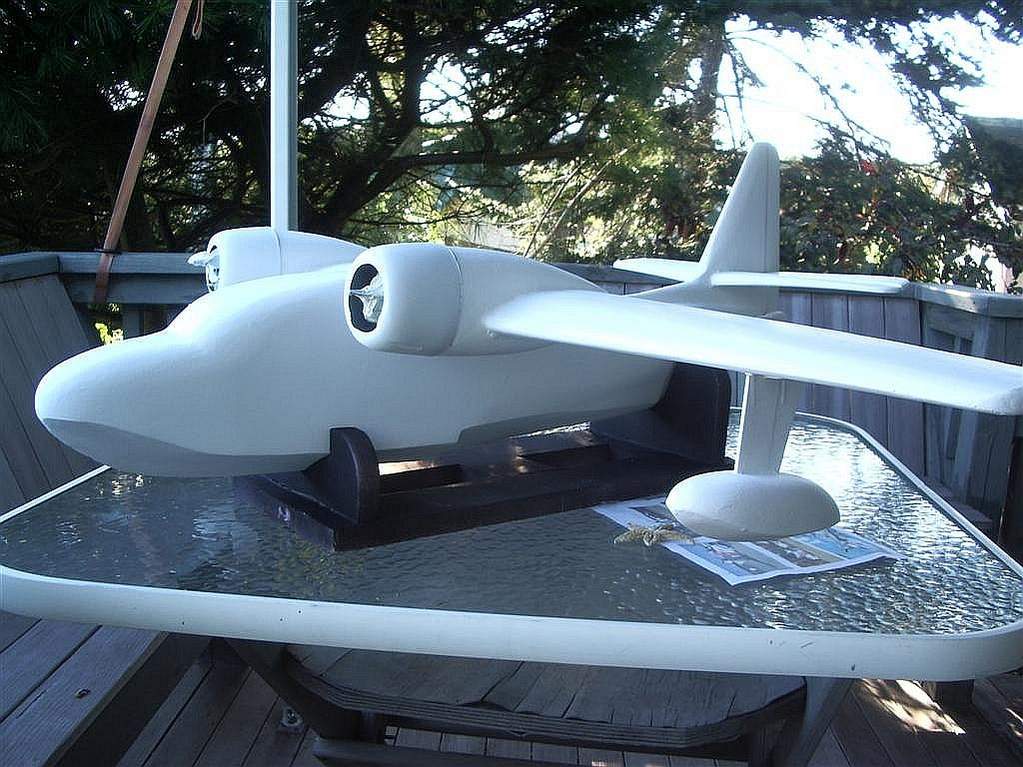

rudder and elevator and the whole plane sanded in the rough.

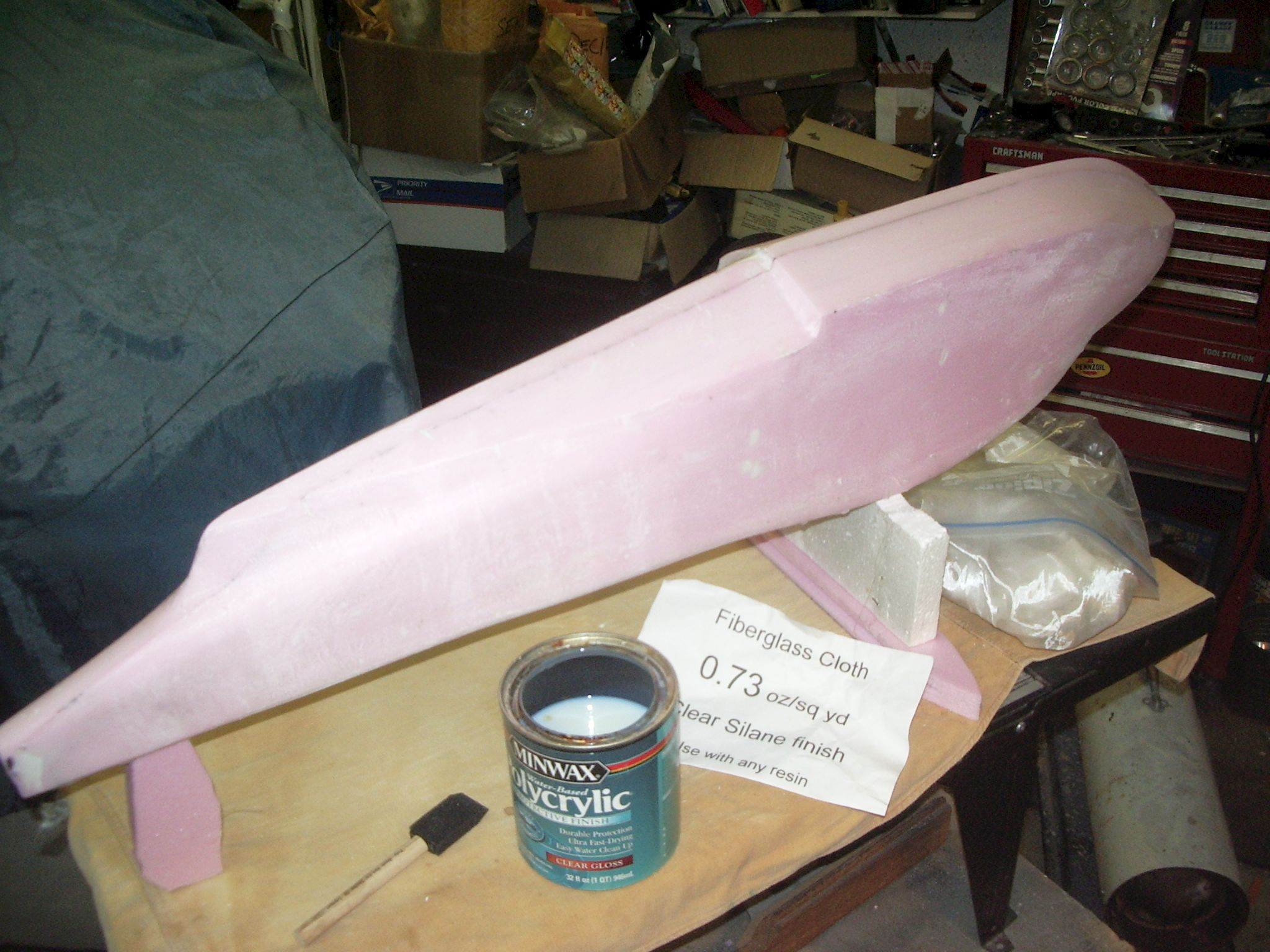

Fuselage is clear waterbase over 0.75oz cloth earlier. The rest of the plane gets the same.

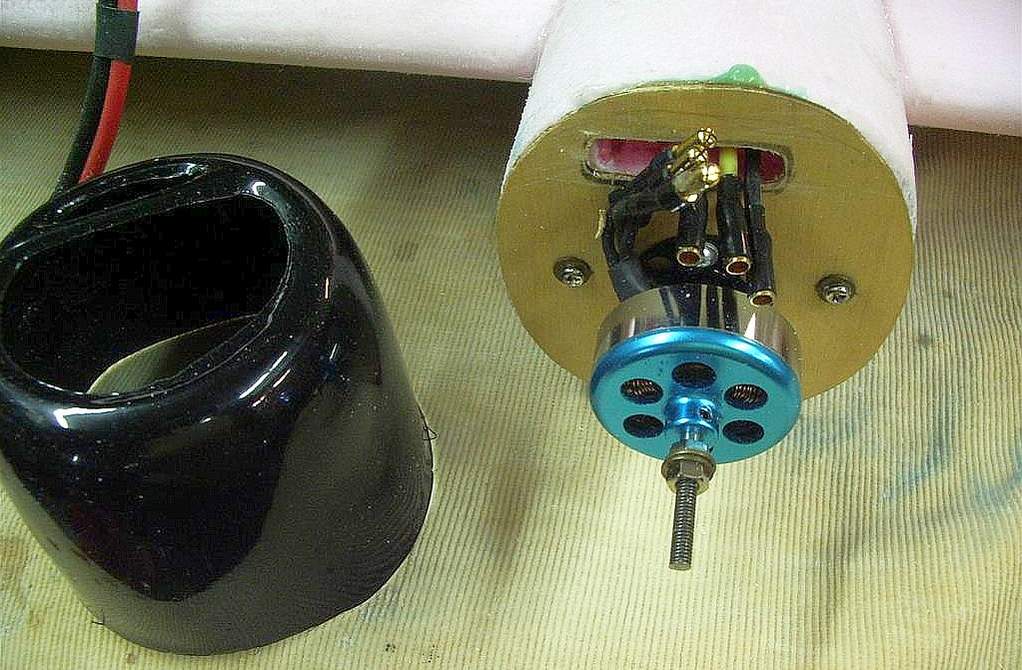

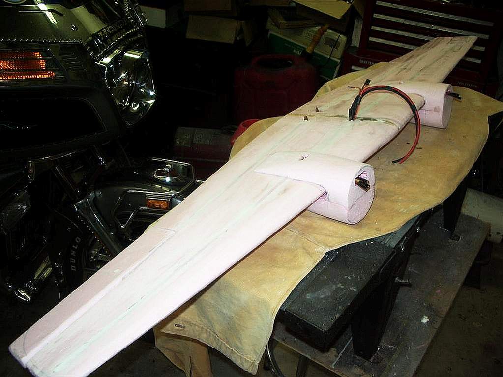

Wire in place. ESC's in hollowed out nacelles.

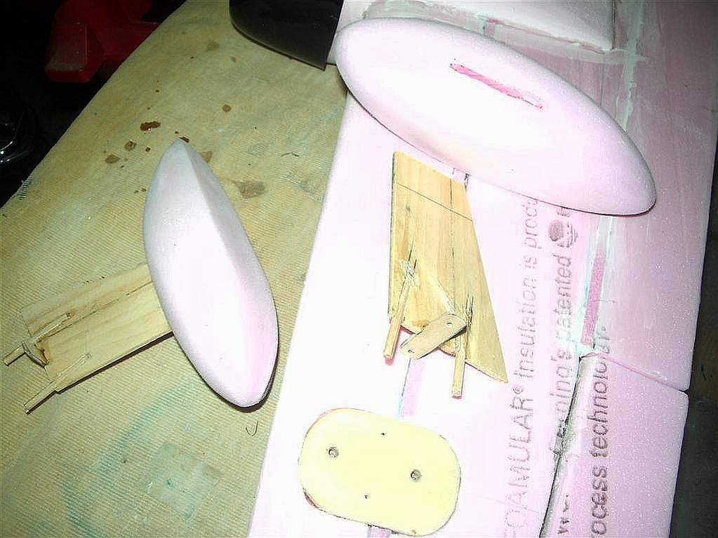

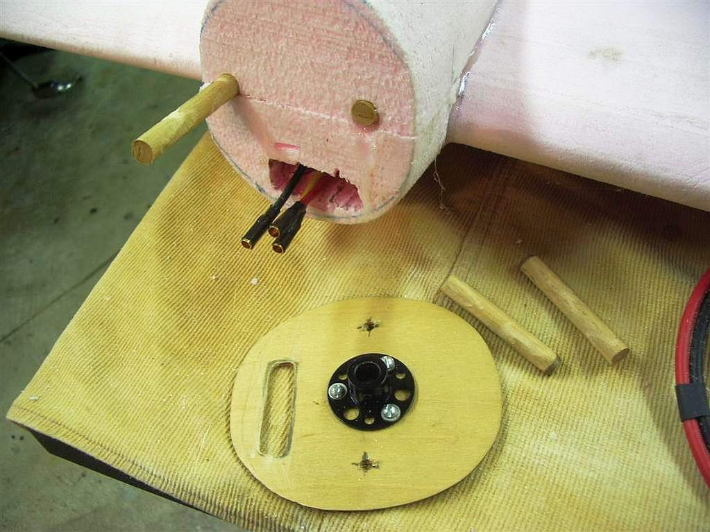

Creating the floats and mounting into the wing solid. There are dowel pins to remove them with 2 screws. They are strong enough for flight. In a mishap the dowels are the weak point to break away.

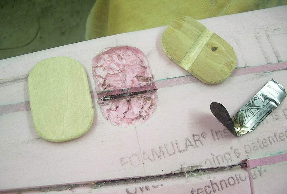

Take a piece of tin and shape it with a radius. Outline the position of the plywood float base. Heat the tin and melt the foam to the thickness of the plywood. It is notched for the wing spar. Epoxy in place.
Make templates of the floats and cut the foam block. These get shaped by roughing and hand sanding.
Rough cut top and side view.
Create 1/8th inch plywood struts with dowels and a flat piece for the screws. Slot the foam and do a triial fit into the wing before epoxy. use a ruler to get them correct and by eye also. Give some angle.
Finished
Finished

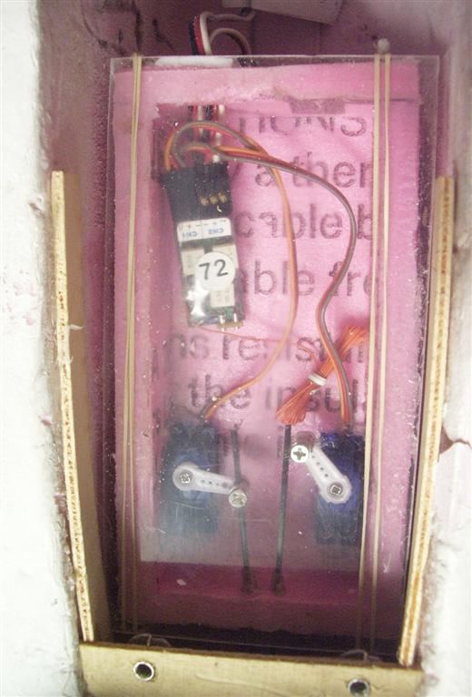

Waterproof box. Holds 2 servos and the receiver. Dowels and elastics. It just slows down seepage.

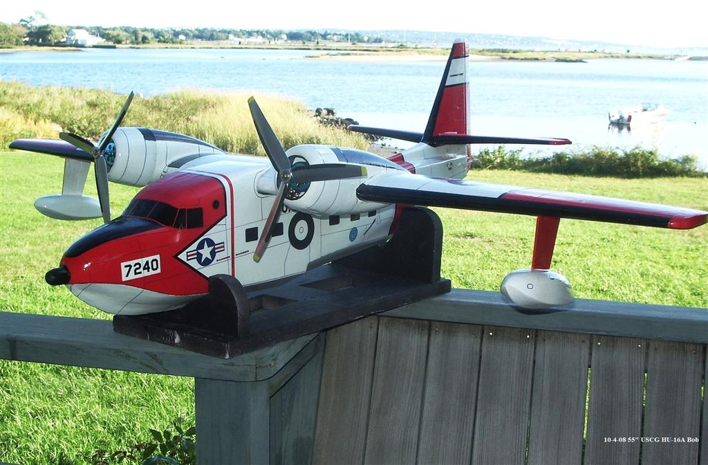

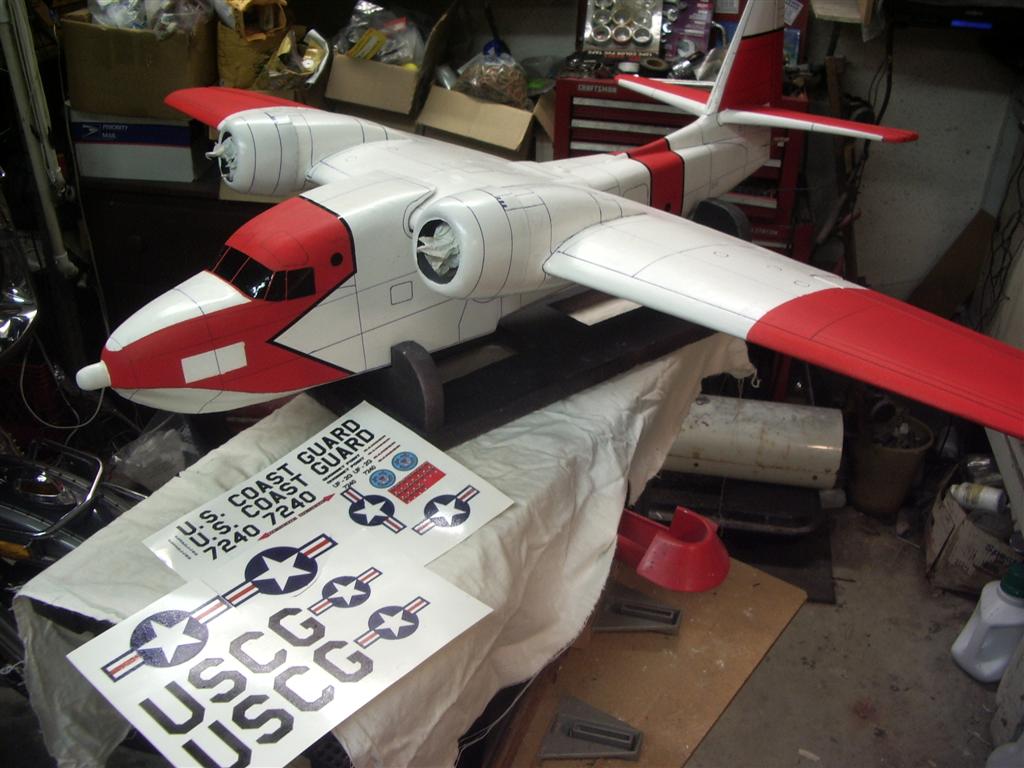

The major parts of the plane are all built in the post revisit. Use the link at the beginning to find out more. I am going to show just some finish items here before closing. Get plastic parts from https://parkflyerplastics.com/cart/. I used their motors. fuel tanks, and you can find the cowls there also. Hundreds of more useful parts also. After the first year of use I cut out the nose to make an easier battery access hatch. I never got water in the plane.
