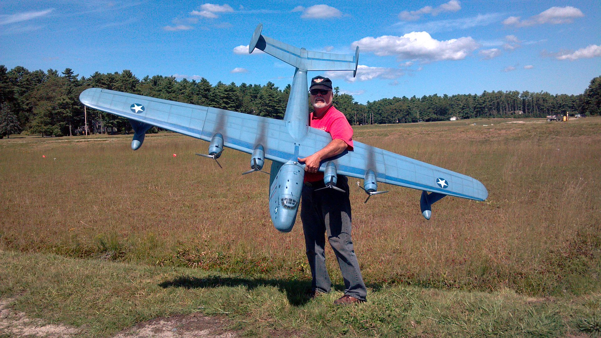

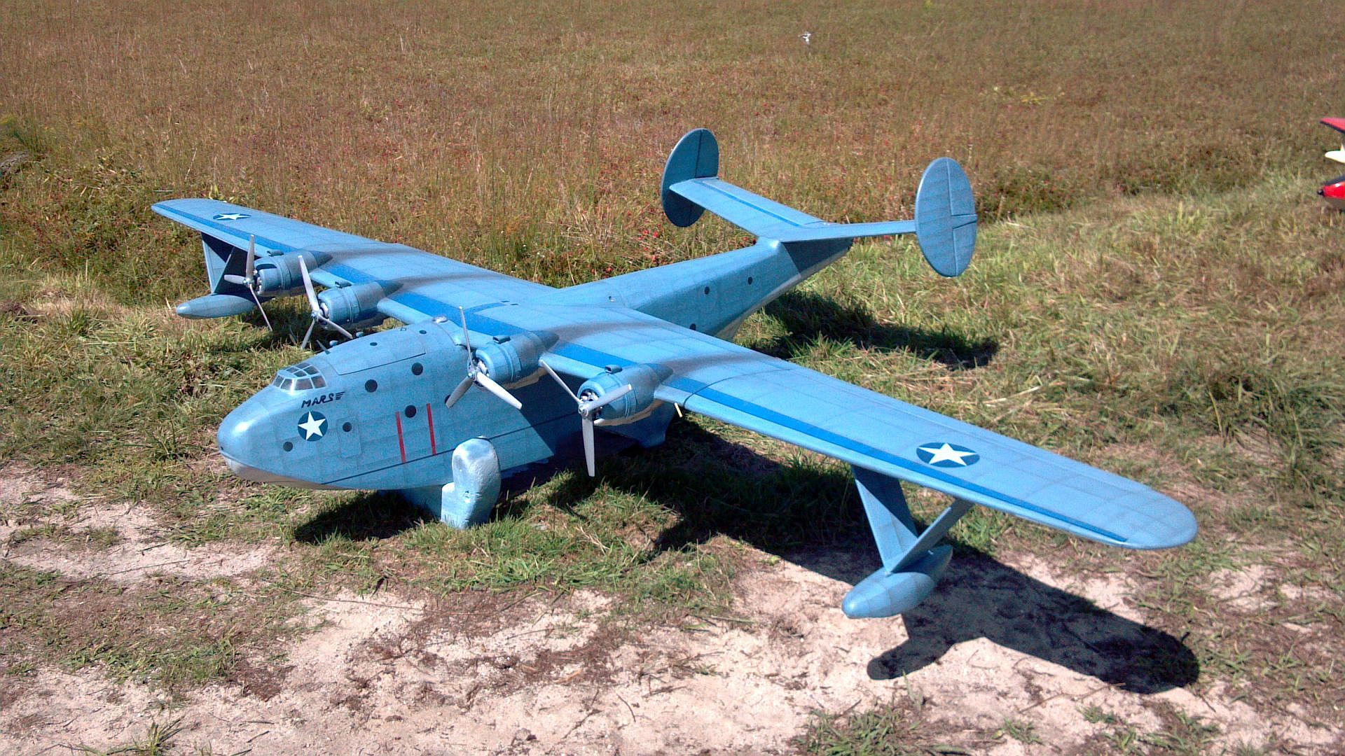

Martin Mars XPB2M-1R Scratchbuild - 1943-123 inch Wingspan

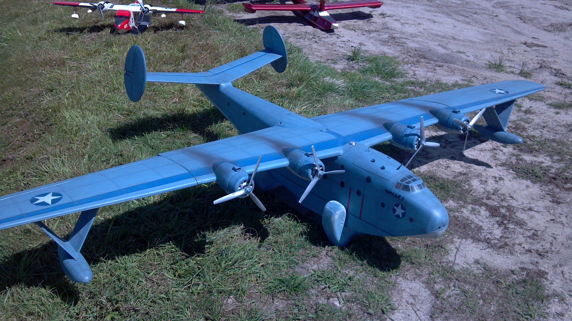

I have not been on the plane for some time now. Pulled it down and got it ready. I was able to only taxi the plane this week. I have only one concern to get the CG right. I added some weight in the nose. It may be more than enough as the nose was down in the water some. It brings the water rudder out of the water. Maybe after a flight I can remove some weight out. There was a snall mishap that prevented me to continue to do the flight. An incoming model coming to shore did not turm in time and chewed my elevator and bent the rudder horn. I have it all repaired again and ready to paint. I may stiill get a test in yet before the Waterfly. If not I will only static display the model.. Picture is at Mary's Pond. The water level is quite a few feet down.

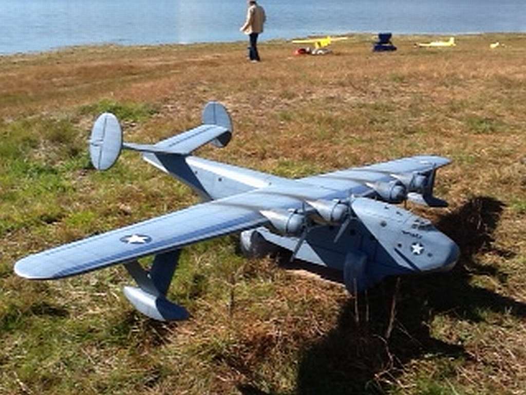

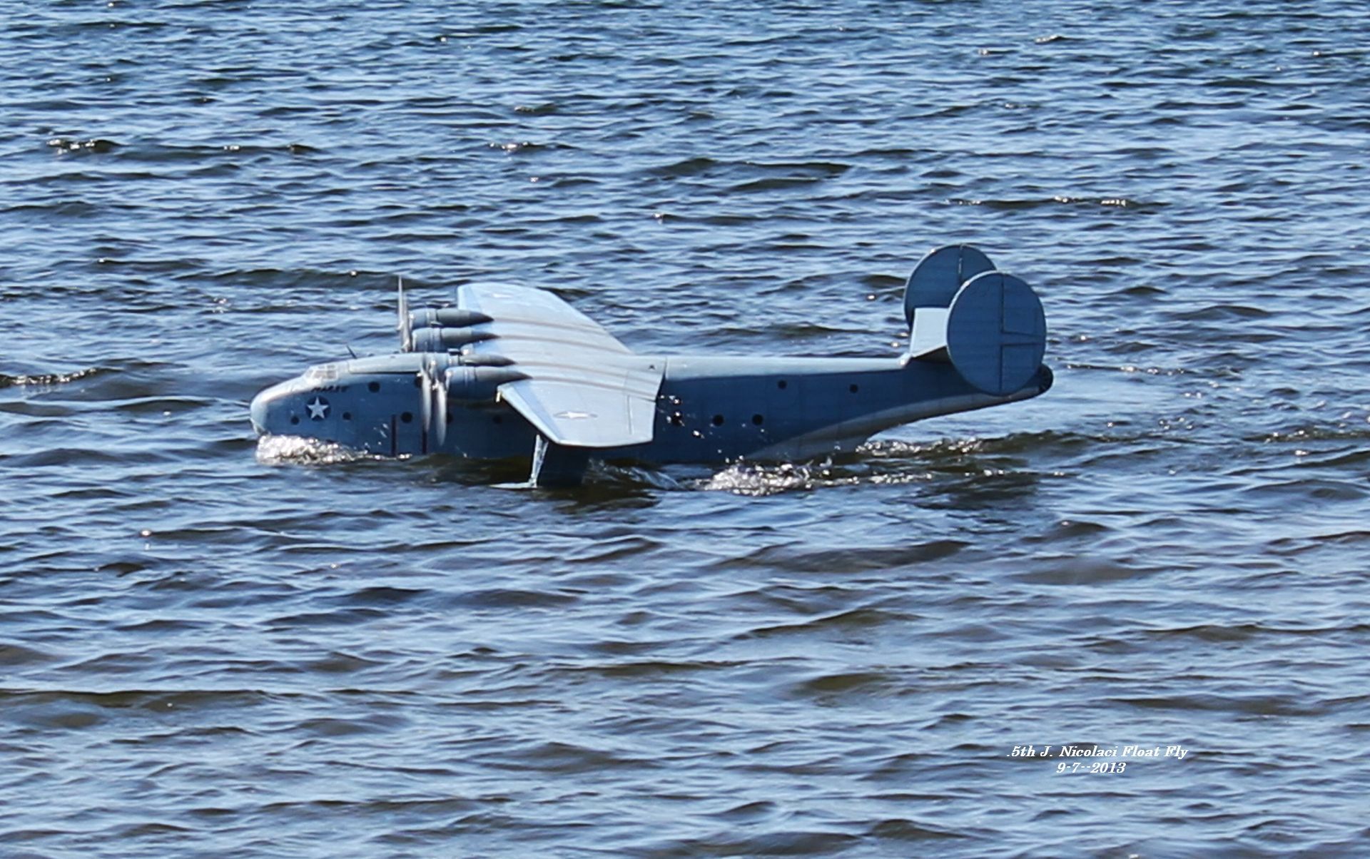

I had to add a load of weight to the nose to get it safely nose heavy. (28 oz.) I think I can take some out as the plane is sitting down some on the nose. The wind was light through most the flight and picked up to 15mph in the last minute of the flight before landing. The plane tracks very good on the water if flat. When you see the video it will show it. got it up in the air and it was very smooth and handles like calm pussycat. She goes very straight with all that rudder area. I like it alot. I never even touched the trims the whole flight. Smooth and sweet flyer. I was very comfortable with her. She does not need a load of power to go and it flies very realistic at half throttle.
The maiden landing was also smooth. The first attempt was too fast. I slashed the power on the next round and glided and slow turned into the stiffer wind and let it land itself. This is not as cumbersome as many think. Do not let the size fool you. It is going to be a favorite flyer and pleaser. The only thing I found with the size is not to make to steep a bank if there is strong wind. I actually had the rudder used more than the ailerons in the turns. I use the ailerons in opposite position to help it make a flatter but larger turn in slight angles. The Emily is a handful to fly compared to this plane. That plane has higher wing loading. But it has big flaps to compensate. These big wings do not like high angle banking in the wind. The wind will flatten it and the plane will dive out of the sky. Do not ask how I found out.

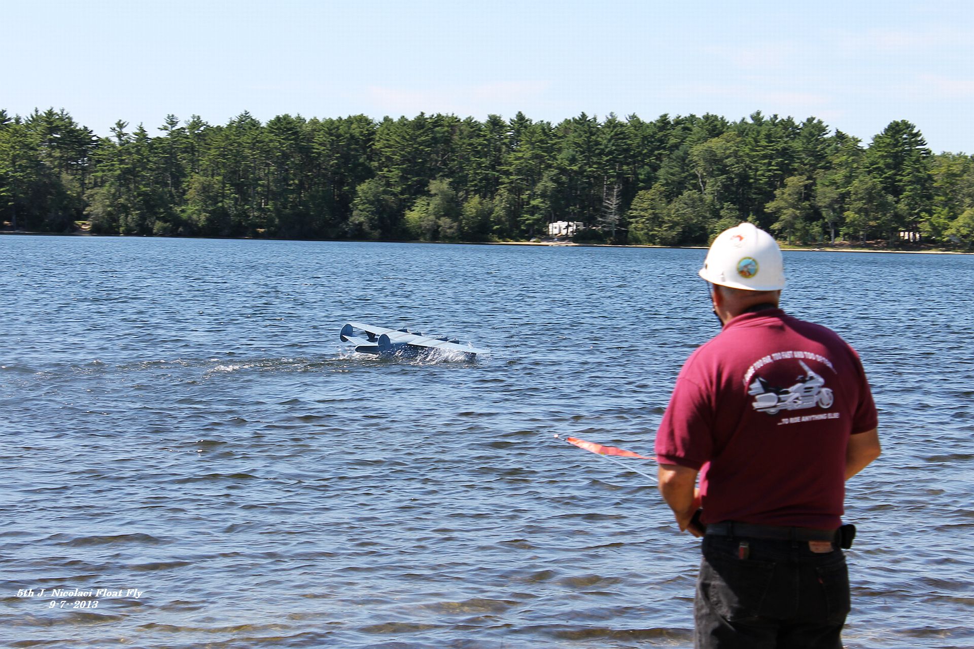

The plane was put in the choppy water and here it goes. I taxied out and started the run. The right float dug in the chop and she looped 360. I straightened it out and full throttle and she lifted off the the water with a graceful lift and banked left smoothly. The wind never made so much as a wing flutter or nudge the whole flight. She plowed right through the wind. Al I had to do is keep my turns with little banking. After a few crowd pleasing low pass flybys it was time to bring it in. I travelled out further and made my roundhouse turn I had to make a 270 degree turn as the wind shifted left slightly. As I made the approach I throttled back to 1/4 and let the weight and the head wind do the work of descending and slowing down the aircraft. She settled in with a small bounce and I throttled it in for pickup. What an applause I got and hoorays.

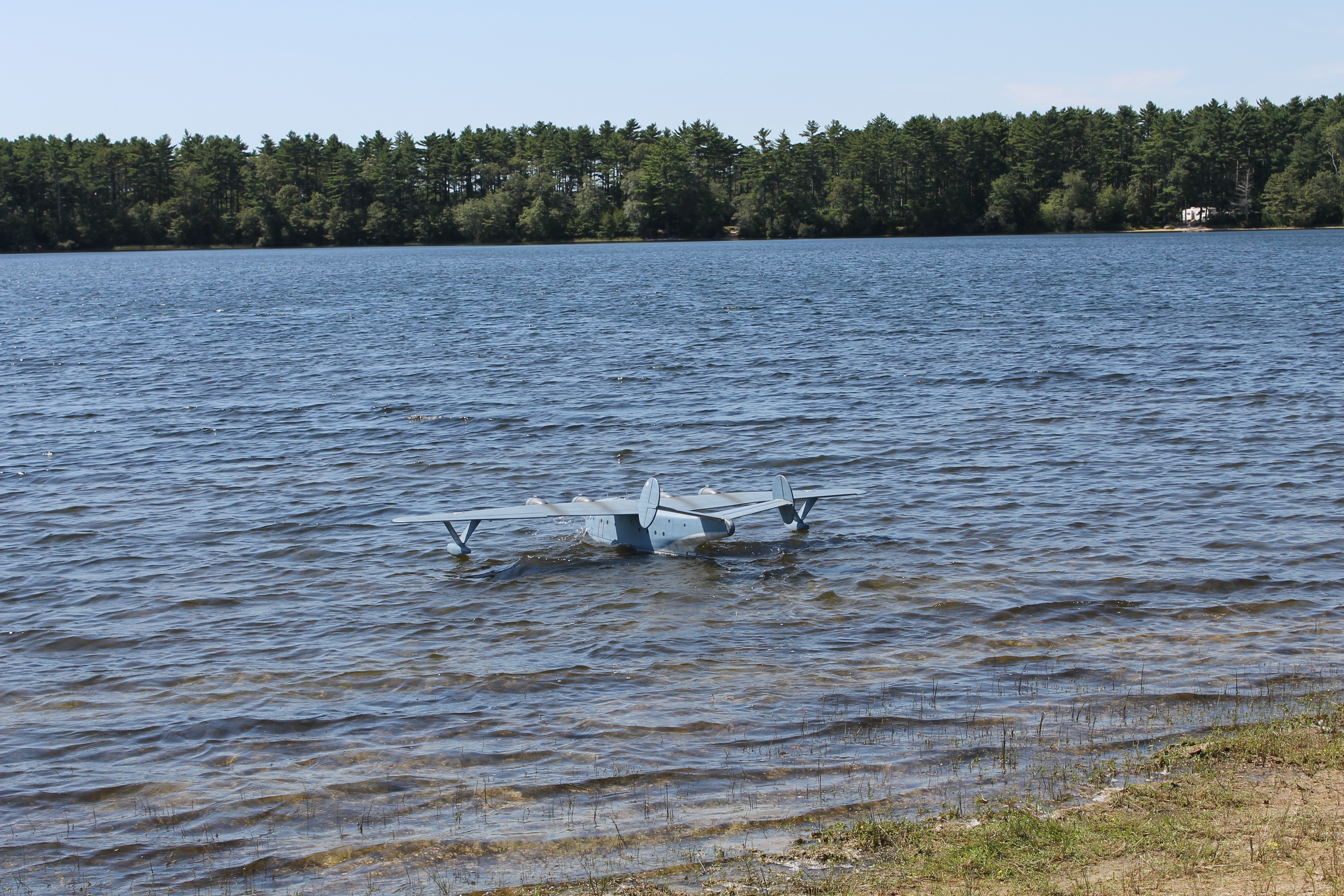

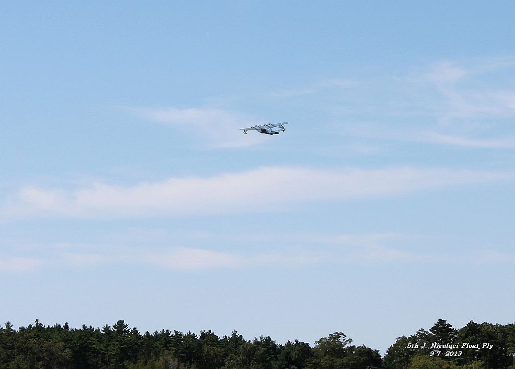

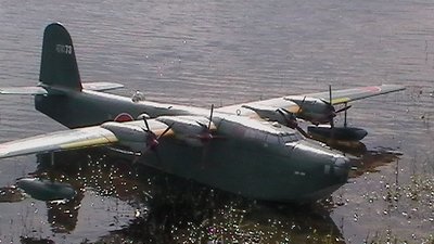

Re: Martin Mars XPB2M-1R- Maiden and Nicolaci Float Fly flig

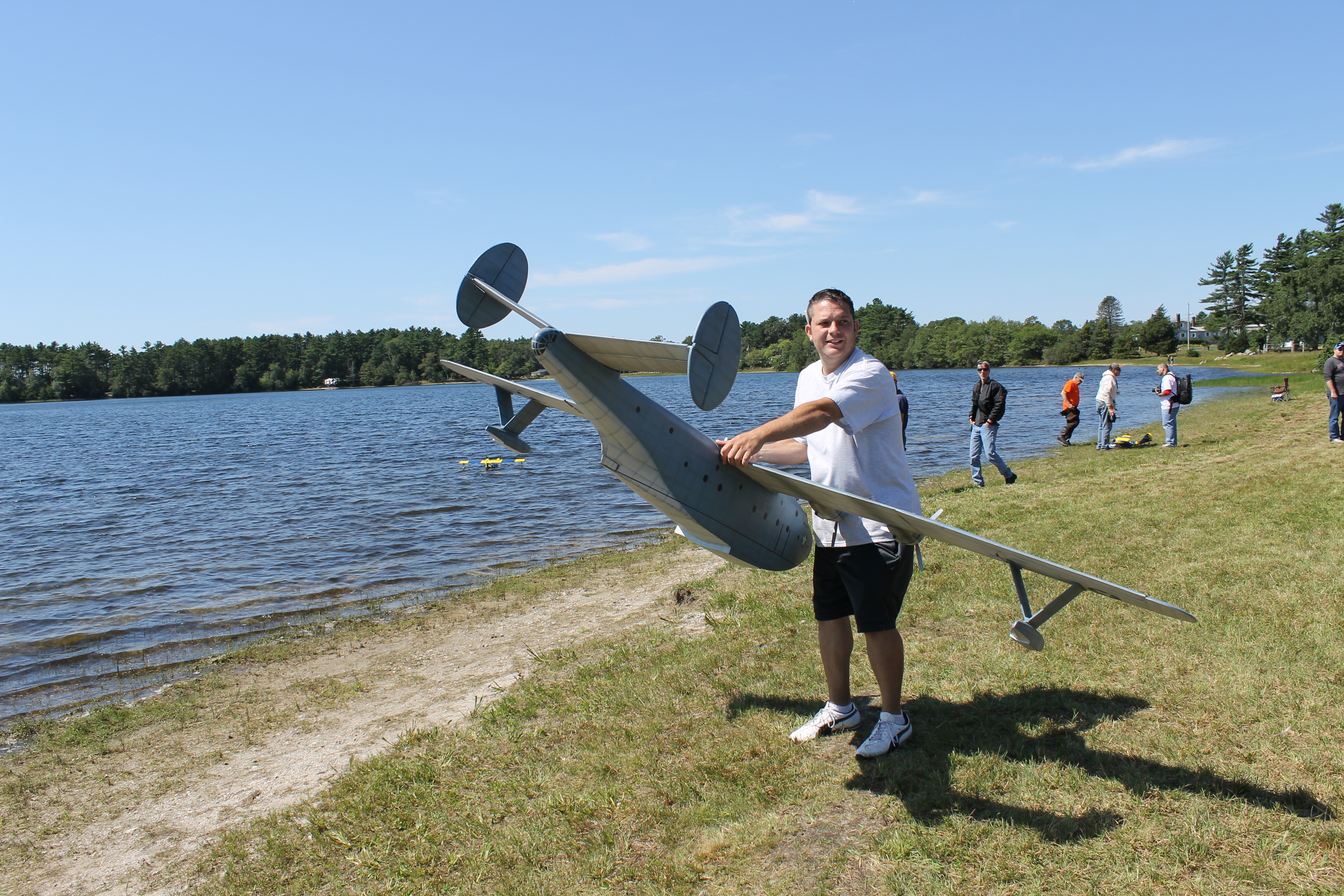

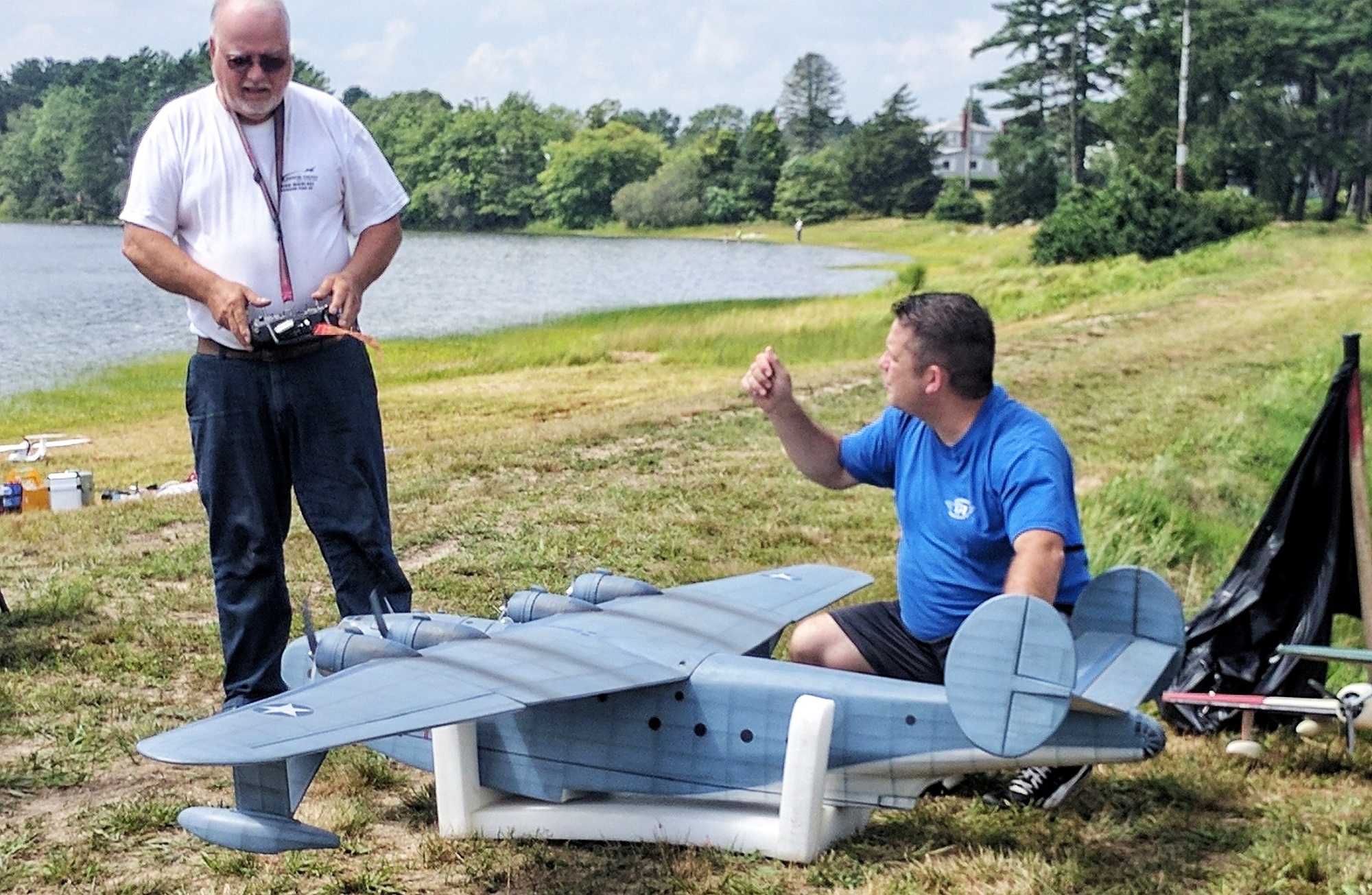

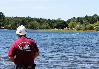

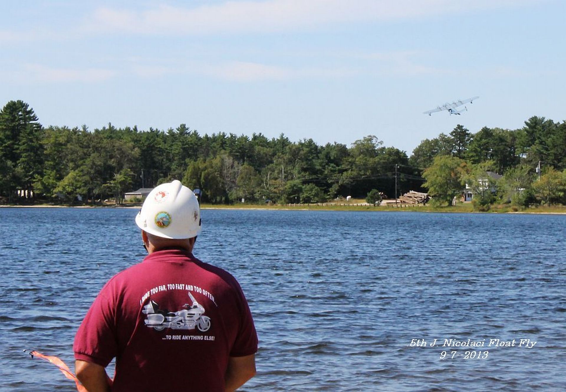

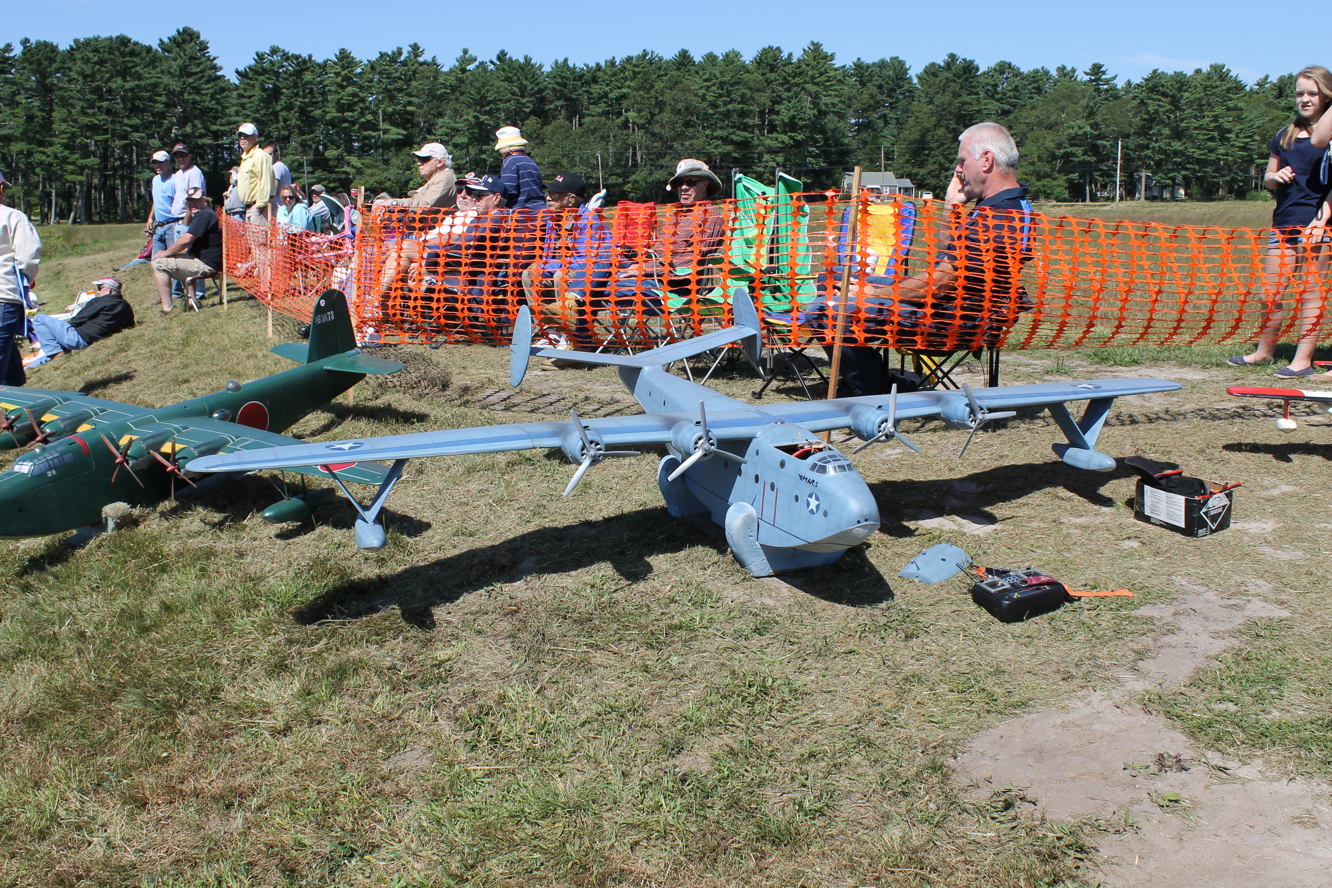

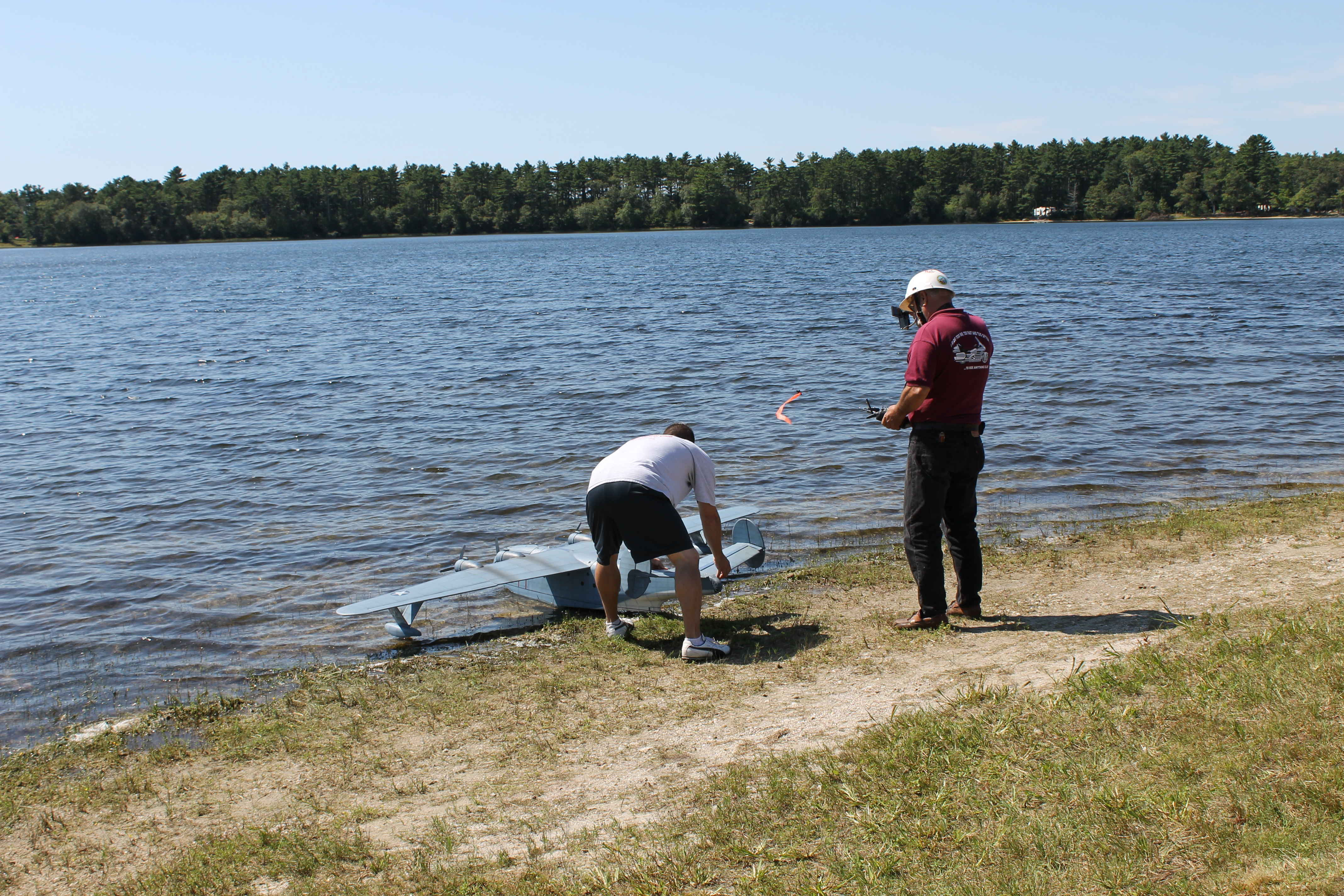

Here are some pictures. The first aircraft is the Kawanishi H8K3 Emily which also flew that day.

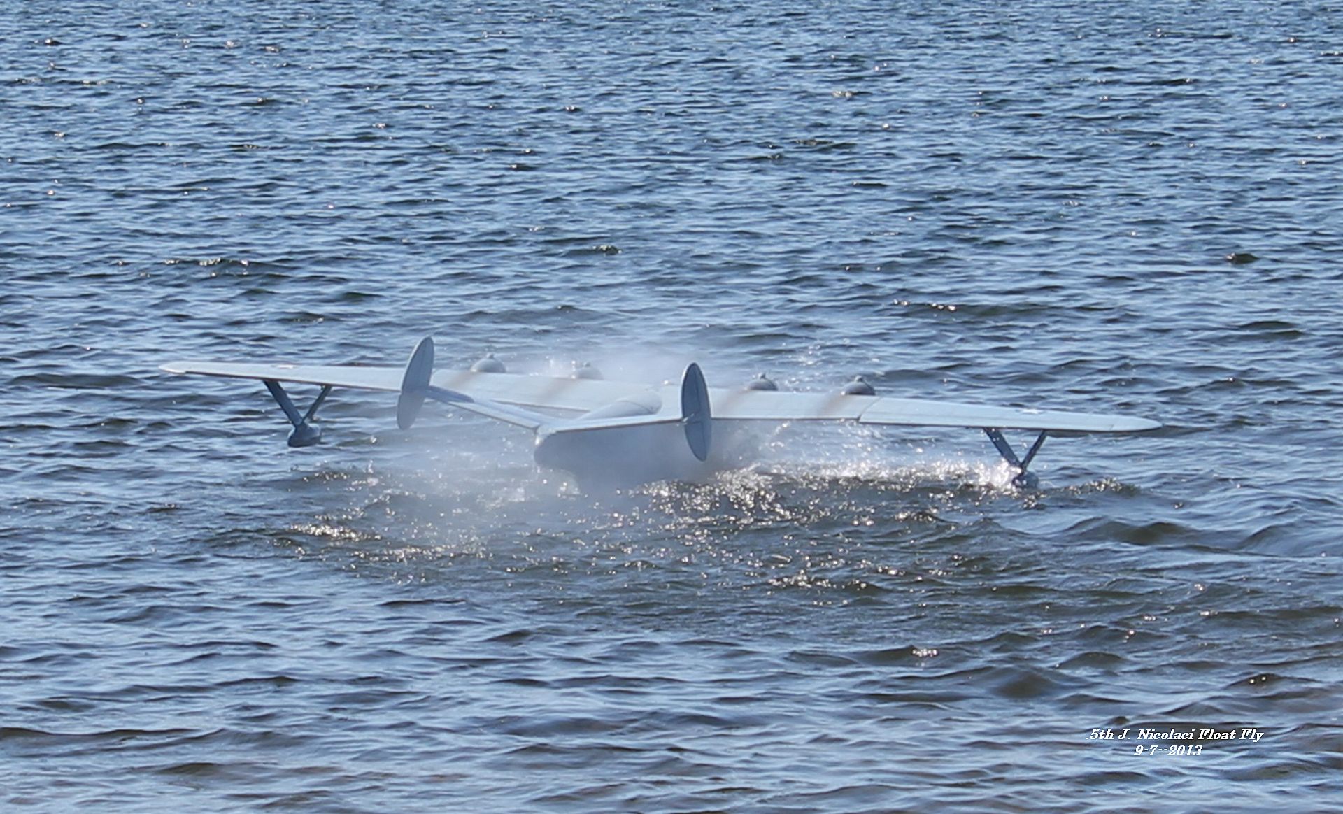

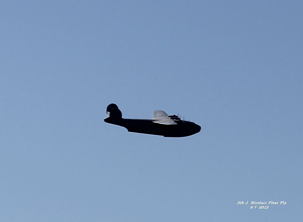

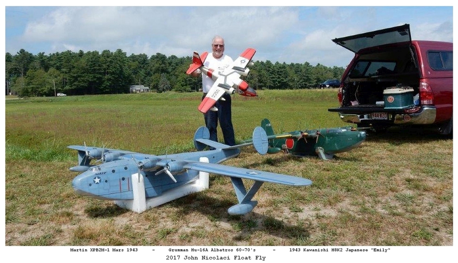

Re: Martin Mars XPB2M-1R Scratchbuild - Sept 9, 2017 Nicolaci FF

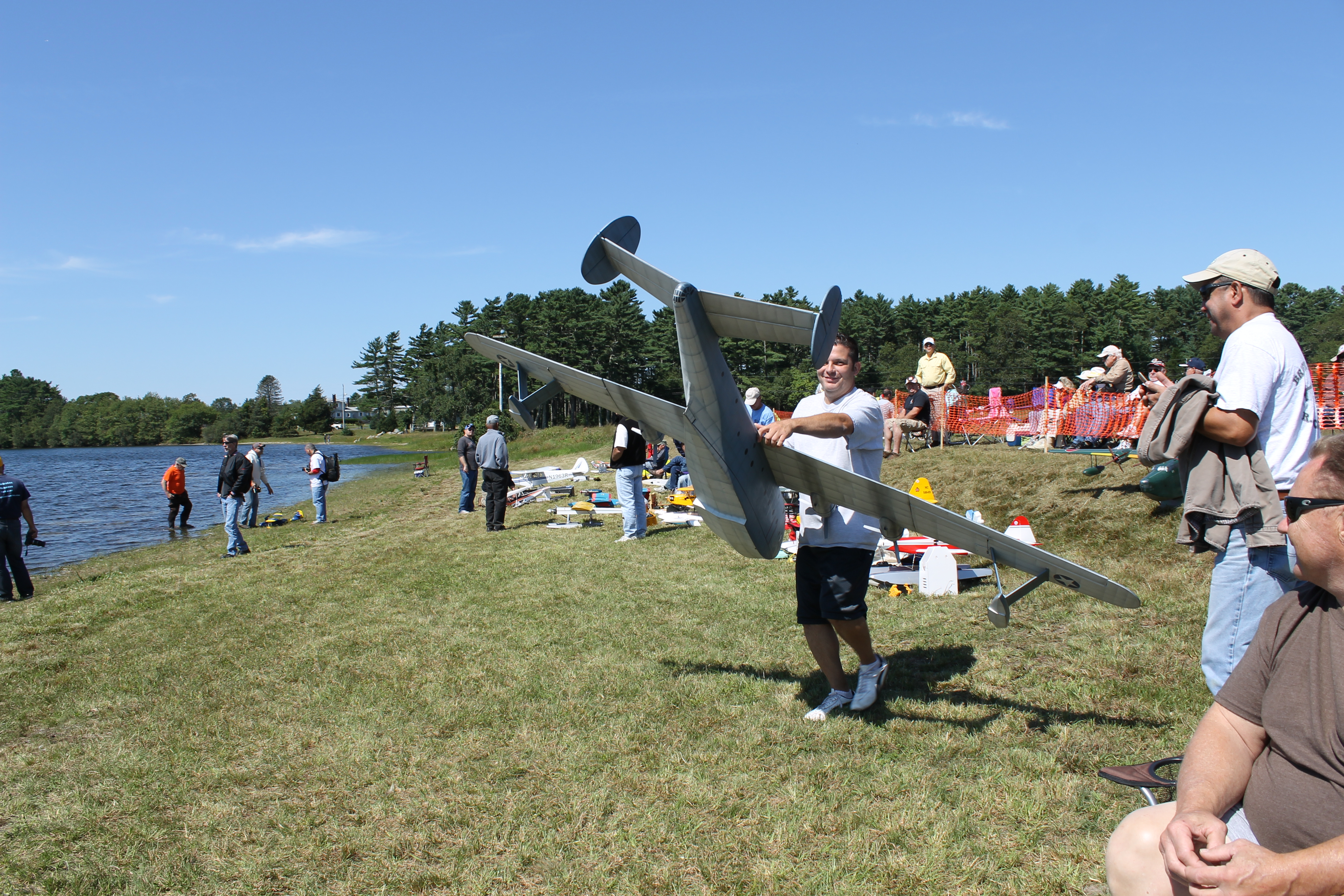

Here is pictures from Sept 9, 2017 Nicolaci Float Fly. I had #3 motor on the Mars cutting out. Flight was aborted. The Float Fly was well attended with flat calm waters. The Club webpage has more photos

One of magazine editors fellow Sopwith Mike is an editor for RCM&E or of some importance with the magazine. He sought me out a few months ago for photos and relative information Still a big model aircraft that is lightly weathered with shading and some wear. Not overly done. There are 2 of these real full size airplanes left. If you look the Martin Mars XPB2M -1R up it will show twin rudders. The later years around 1944-45 it was turned over to a single large rudder and removed all weapons. It was at some point painted red after the war when Canada bought them for fire fighting water bombers, Approximately 5 years ago they were sold and one is restored in Navy blue and is in Pensacola, FL. The other ??
