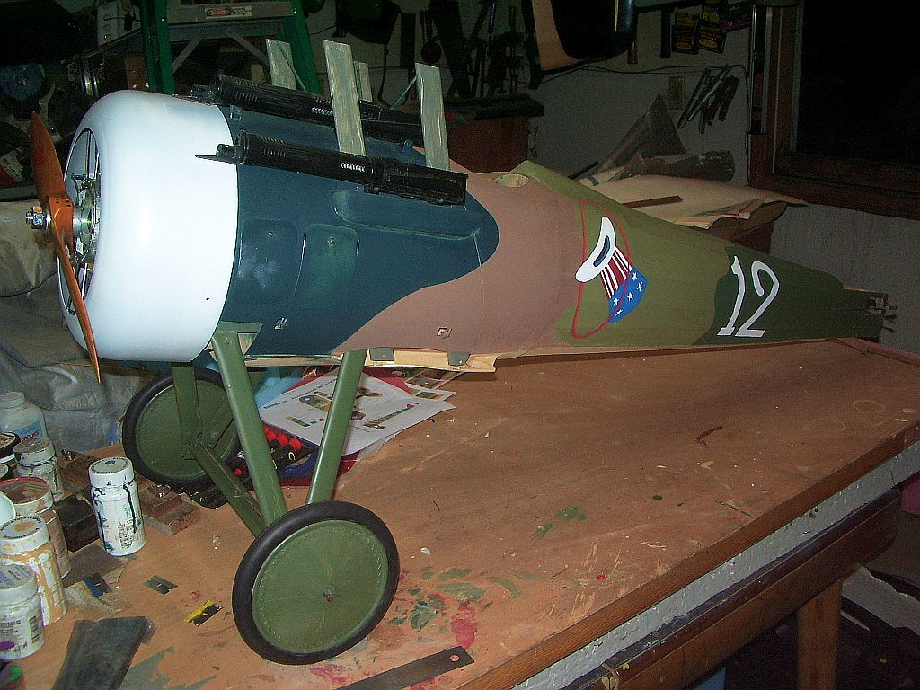

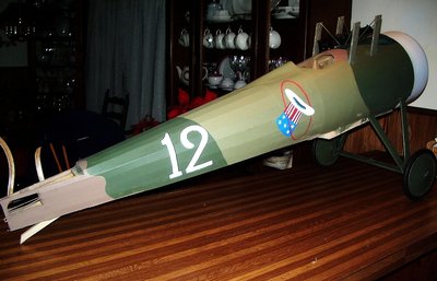

I made computer patterns for the number 12 and the Hat and the Ring. Transferred them and painted all 4 over the last 5 days. Measuring in the photo program and fitting had to be done first for the correct sizes and placements.

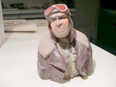

Her is a fantastic donation from Gerry Dupont. It is an Aces of Iron bust. Look them up. They are so real life looking. Gerry airbrushed this bust and did such a great artwork on it. The leather jacket , sheepskin collar and flesh tones are so realistic. The eyes look real with a penetrating look. Thanks goes to Gerry on this pilot. He will be a centerpiece and I am sure many will comment on him.

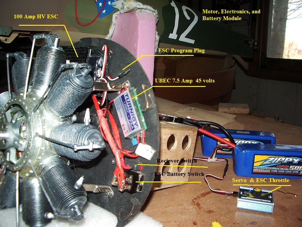

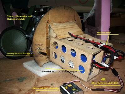

Been busy on setting up a full multicopter setup for FPV and a couple smaller park flyers. But, I got a chance to wire up the batteries and the UBEC with switches to the reciever and to activate the batteries when ready to fly. The ESC switch also acts as a safety Off and to start up when ready to fly from a standby. I tested the motor and all is working great.
I have a little more bracing and figuring out the umbilicle chord when I pull the module out to change batteries. All I have to do now in electronics is put the reciever in place and it is all connected to go when ready. I have the cockpit to work on next and windshield then it is the re-install the wings and tail.

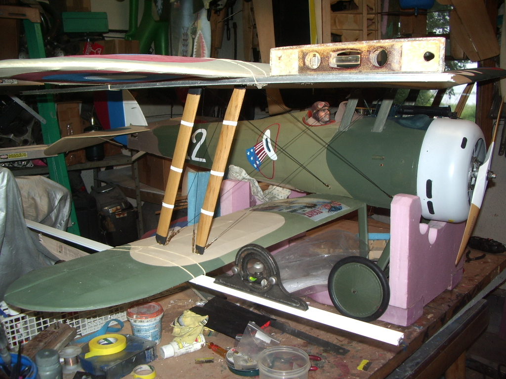

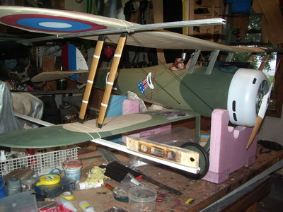

Spent the 4th of July working on the wire stays. The weather is raining as an offshore hurricane Arthur passed well off. After mounting the lower wing the upper fuselage to the lower wing stays are installed. The upper wing is bolted to the center struts. The Cabane struts force pressure to the lower wing when forced into place. The lower stays hold firm and the pressure forces the upper wing to form a dihedral as per the plan. Then all the rest of the wire stays go in place but just snug.
Next I used 2 aluminum flat flat trims from a window ad lashed them to the wings upper and lower. The fuselage tail was blocked up to a level state. I put a small machinist and carpenters level on the aluminum trim flat stock. Level the wings for straightness and repeat the both sides upper and lower. After it is all tuned I have to lace a fine wire through each turnbuckle to lock them in place so they do not unscrew in flight from vibration. Sure looks purrty. Still have more to do. Mostly details.

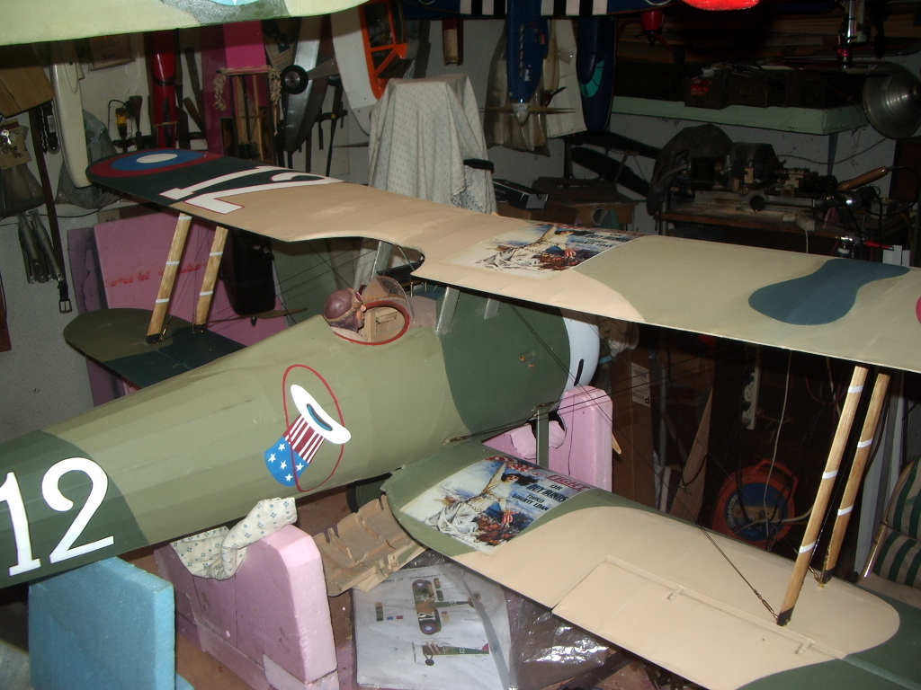

Got the wing wire stays on with well secured wings now and I shot an outdoor group of pictures. Here are a few.
1/4 Scale Nieuport 28c - WWI Ace- Eddie Rickenbacker scheme with War Bond posters on the wings as the original had. 80" span. Many details to finish yet.
