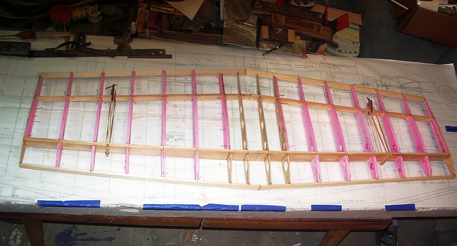

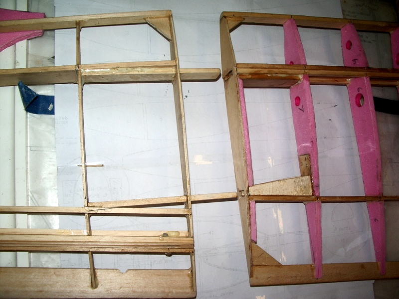

Mid Wing Assembly
This is how far I got fabricating the middle wing portion in the last 2 days. I am giving this wing a rest while I do the 2 outer wings next. I want to get the plug in spars working before any covering takes place. It will be easier this way. The clamps on the wing are holding elastic pressure while the Elmers Poly glue cures tonight.
Middle 4 ribs and outer ribs are ply. The spars are hardwood. Leading and trailing edges are balsa. The rest are foam ribs.

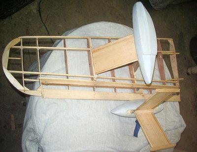

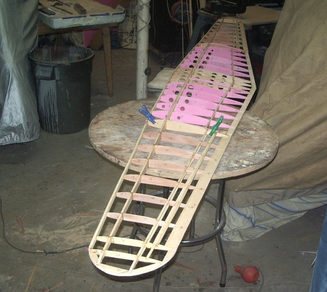

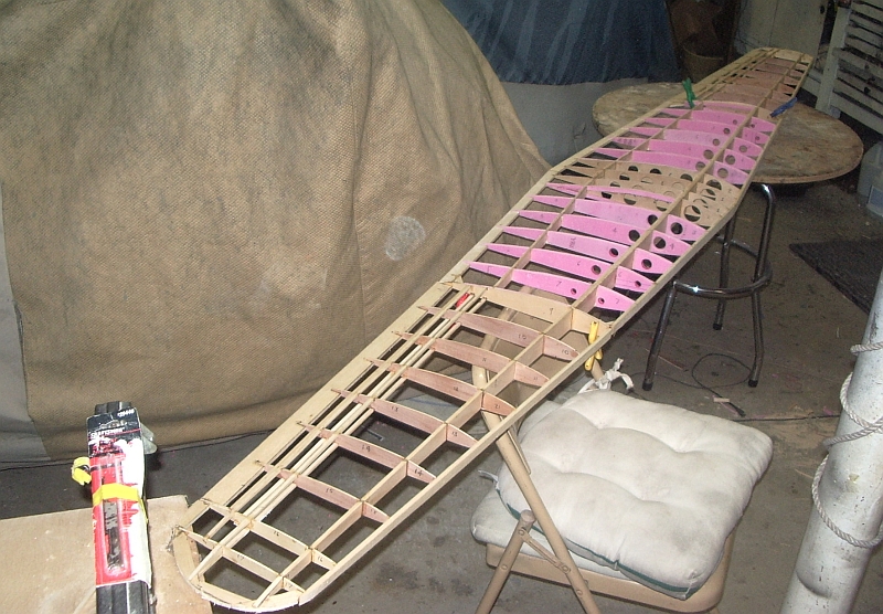

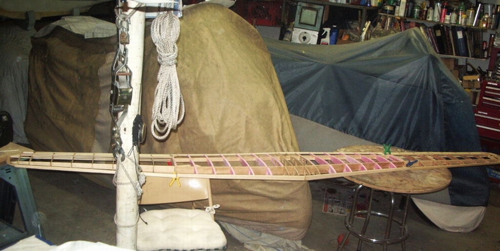

Wing Outer Plugins
2 days work getting them framed. I put 5 degrees washout in the wing plugins. Still have to do the ailerons and servo planning, wing float mounts, and the wing plug sockets. Use of hard woods is extensive. There will be a load of stress on these outside wings. I have also been informed my new foam sheeting is back ordered and no shipping in site. I may have to revert to 3mm foam and epoxy and glass it.
10 foot spanning a chair, stool , and onto my saw.
Ailerons have to be cut free yet
That is 2 Honda Wings it is spanning.

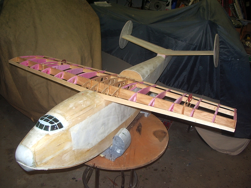

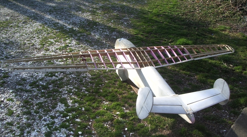

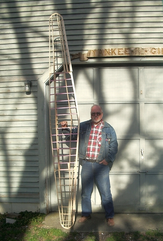

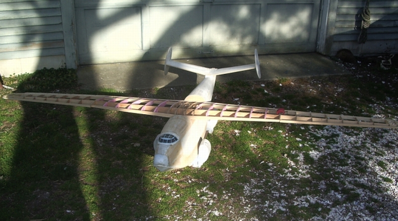

Wing Joints Outdoor Size Display
This is what I got done today. The joints are hardwood. They are boxed in for a snug fit the male parts. I had to square them to the rib surface and build as it went. I am going to put a push wire in from the leading edge in a brass tubing that goes through the male plugs. This will hold them in place securely while in flight.
Next is the wing float mounts and a sub surface box for the servos. Then back to the mid wing.
The right wing had to be carefully fitted to the male on the left. It required routing and then filing the rectangle slot with a square file. .Then fabricating the boxes to snug fit and glued then clamped.
My garage door is 10' L X 8' H
Dropped on the plane. A lot to go yet.

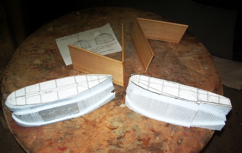

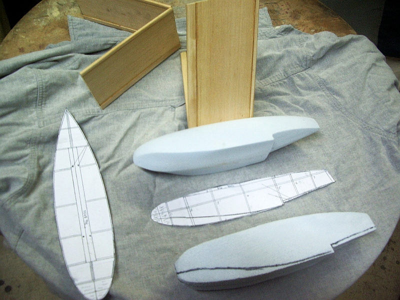

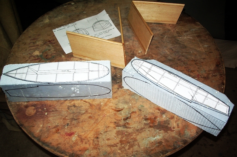

I got my float mounts and servo boxes done in the wings today. I made the wood strut frames with hardwood and balsa. Then I set them up for angle and glued them together. I guess i just had to find something more to do for tonight.
After a supper break I did start the floats. I find working with foam so easy and fast. If you looked over the float plans you would be there for a couple days with the small frames and formers let alone the finishing.. You can see them sitting on the foam block pictures. I roughed them out on my bandsaw. I think they will be done tomorrow and ready for glass cloth. I'll add some pics here when done.
Start by tracing patterns slightly oversize on a couple a foam rectangles.
Cut one side with some edge to spare. Put the etra back and flip the block. Cut the other side out. Ready to sand to shape next.

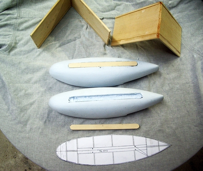

Added a hardwood stick mount foe the V mount to secure too. I marked the float and the channeled a dado to take the stick. I used a Dremel with a 3/8 inch stone to route the channel. I glued it in with Poly glue and taped to hold it

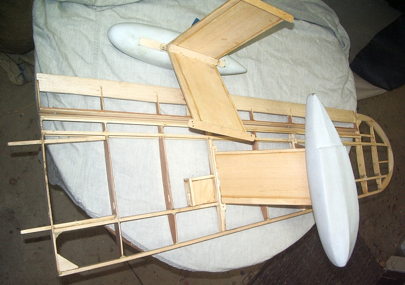

Floats Assembled
I sanded the V struts mounting sticks and screwed the V strut to the floats. I am done for now on the 2 plug in wings. The floats will be epoxyed when I do the fuselage. The floats weigh 2.9oz. each now. I have started getting the middle main wing leading edge and sheeting ready for nacelles. There is sheet balsa in this area also.The nacelles will be foam and balsa with fiberglass cowls.
The float is lined up and just sitting in place. The servo compartment alomgside.

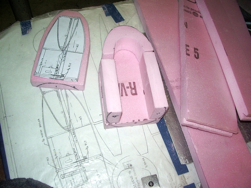

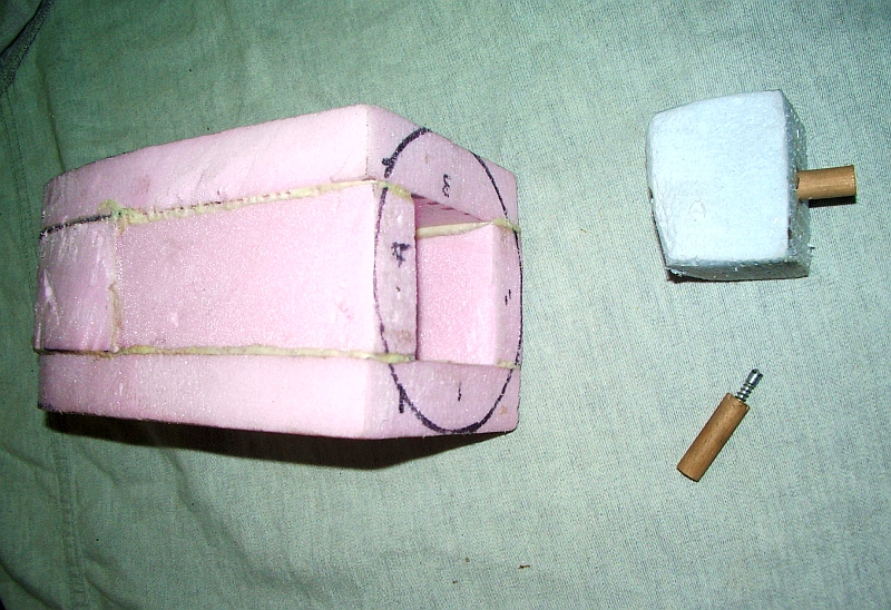

Wing Plug Lock - Nacelle Blanks

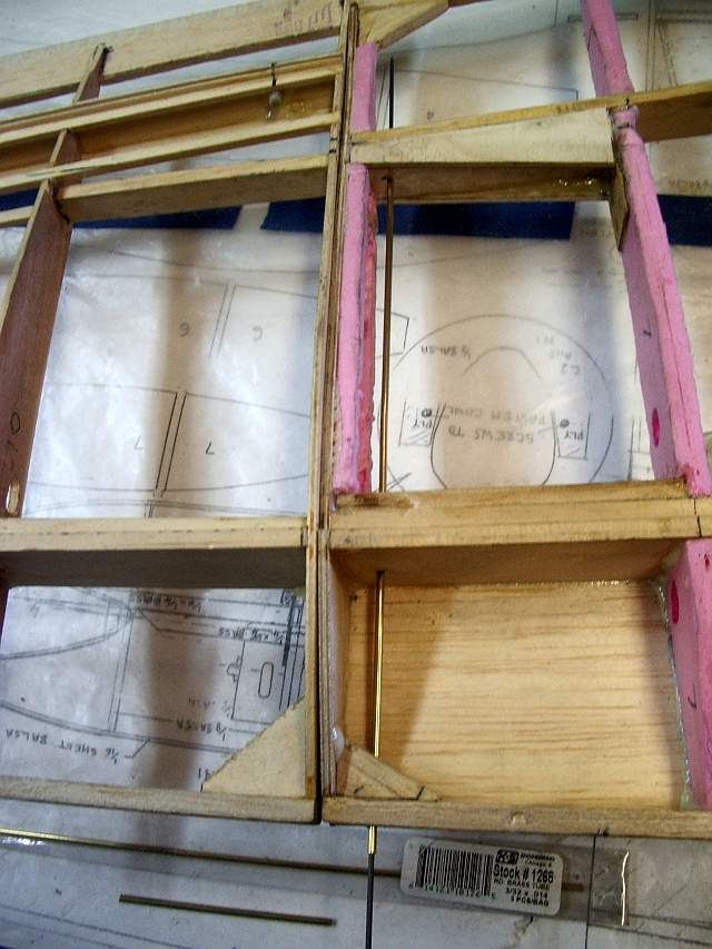

Here we have 2 operations. I like the the push in wire through the spars plugs. Planning is essential for placement. I moved them in about 3/4" from the wing joint. Better holding power for the dihedral position. Also it moves the holes away from the joint to help stop a crack across the hole and a weak spot near the joint. I used 3/32" tubing that allows a 1/16 inch piano wire to pass through.
I used a 1/16 wire on a drill and drilled the holes through the both wing spars from the leading edge. The wing has to be held in the non sagging dihedral position before drilling. The brass tube is marked and cut with a Dremel cuttoff tool. They have to be longer than the space it will fit by at least 1/8" each end to set in the wood and glued. Two plugs and 2 pieces of brass. After secured the wing is renoved and 2 small cut pieces of brass are made 3/16"long to go into the holes on the plugs. The plugs are 1/4" wide. I pushed them in with help of needlenose pliers. These prevent wear in the wing plug tips and take out any slack in the dihedral. All that is needed now is to make 2 pieces of 1/16" wire with a bend on the end. Push it all the way in. The brass guides make it line up and go right on through. Shown in the picture with a 1mm carbon rod going through. I sharpened a point on it. The brass sticks out the leading edge. I have to add another leading edge balsa molding and then fair it to the edge.

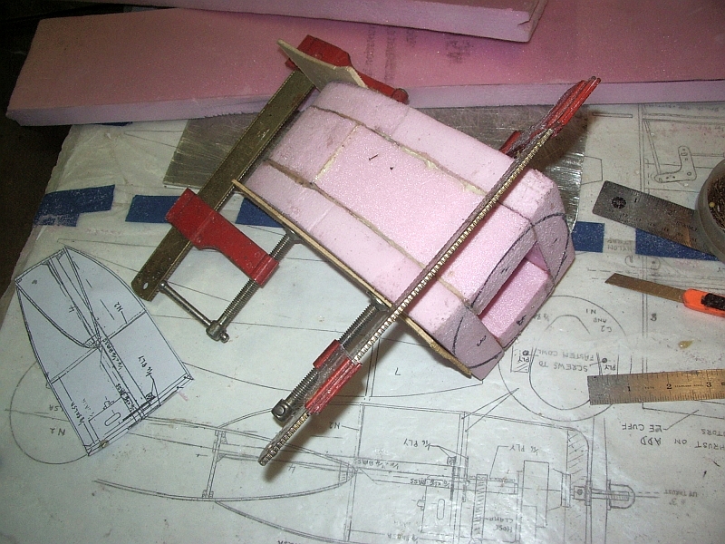

Next is my start on a sample nacelle block. I used 1 inch foam and a piece of 2 inch foam cut into a horshoe shap near the wing end. I oversized the outside diameter to 4 inches. This gives me a square inside opening about 2 inches. Two 1/4" sticks will go from the main wing spar to the firewall plywood from inside the square hollow. I will have air space for my Esc's also with motor plugs. I will shape and test fit tomorrow as this is the initial test nacelle. II could put a dowel through the nacelle and shape it in the drill press or lathe also. I may just hand shape it. If it works out I will make the other 3 nacelles. I think it is going to be a go.
Brass tube guide and it will have piano wire rod push in and through the plugs. Locked!
Rough 1" foam cut to 4" outside and 2" inside. Cut it oversize allowances.
Poly glue clamped and setting up.

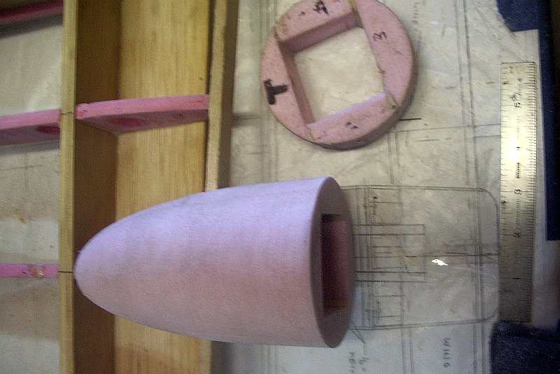

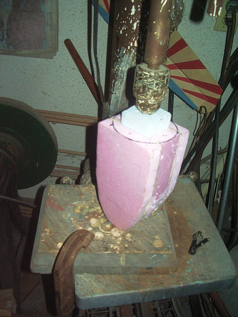

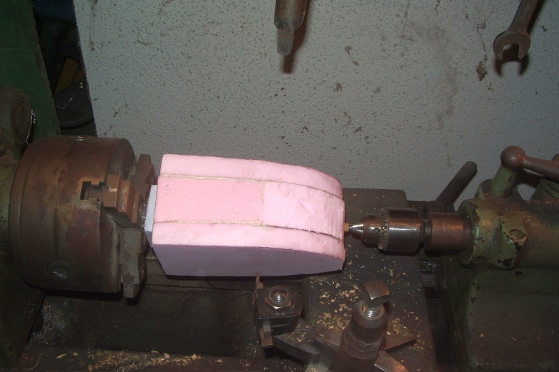

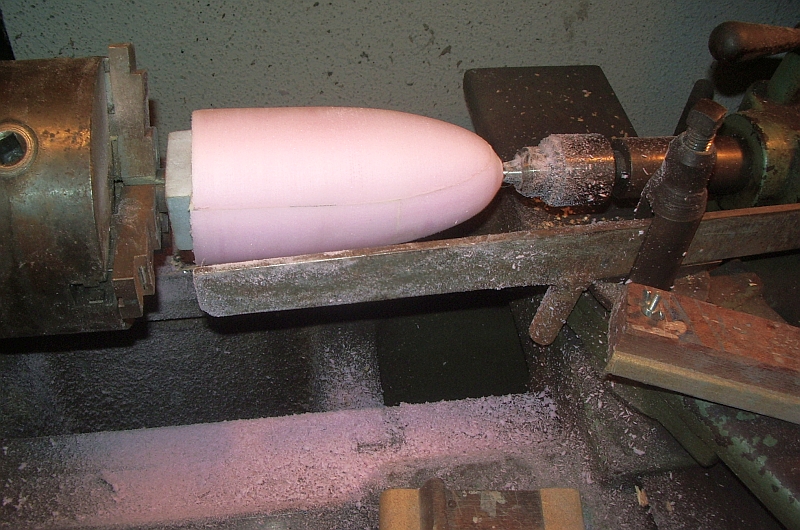

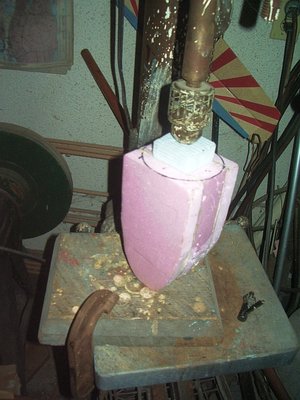

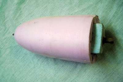

Making My Nacelles using a Machine
This is my first machine made nacelle. It comes out to a true shape. I found that hand sanding can be done just about as easy but takes longer. The glue lines make shaping harder to do. I have to stop and sand the glue down then continue shaping. Doing a glued up block on the drill press would have been real hard to do. A solid block with a 1/2 inch dowel glued in deeper would be easy on either machine..
I think a solid block of blue foam would have been a good way to go. I would then split in half and re-glue together again after hollowing with a Dremel or hot blade. It is possible to hollow without splitting also.
Emily nacelles were made in a solid block and sanded to shape. Works well for hand sanding. These were a piece of cake.
http://www.rcgroups.com/forums/showp...8&postcount=55
I used a squaer foam driver with a dowel. I also put a nail across and through the dowel drive. Hot glued into the blue block A wood screw and a dowel glued in place on the tapered end.
Setup in drill press if it was to be done there.
Setup in my lathe. It has to be knife cut first to near shape.
Finished. I found my sanding bloch on the corner took it down good. Glue lines present problems.
Done!
The nacelle fit to the wing and shortened to length.

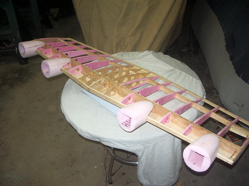

Post by Neons » Fri Apr 06, 2012 10:16 pm

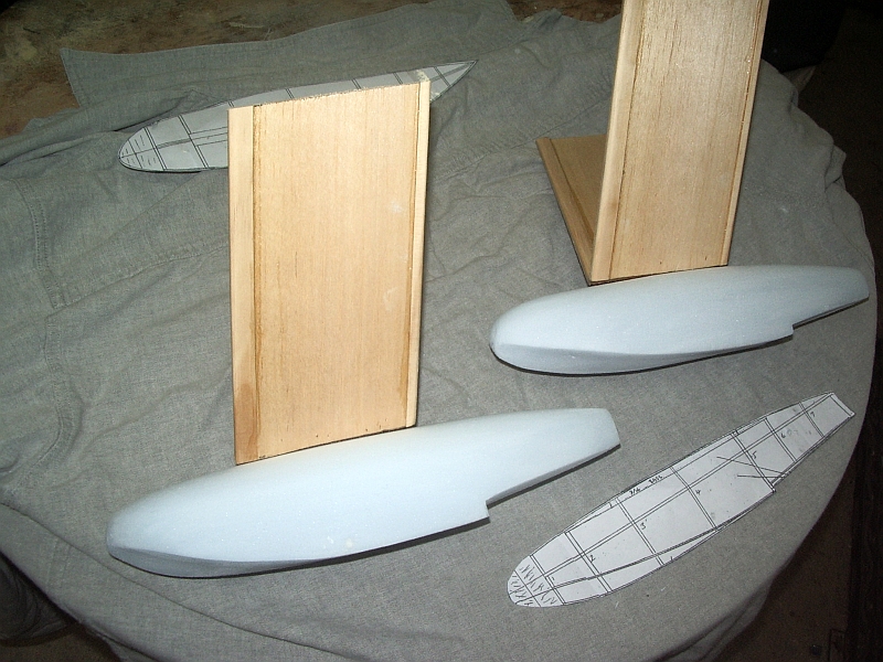

I got the 3 other nacelles done today. The epoxy was not totally hard but I went ahead anyway to get them done. Mounts and firewalls are next. I see wiring also coming up before I can finish the sheeting under the nacelles.
Not glued up yet.
