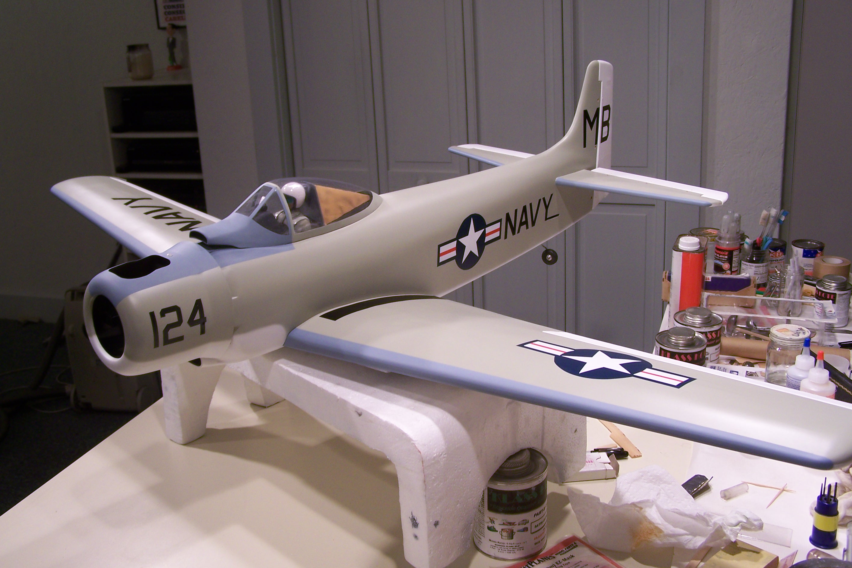

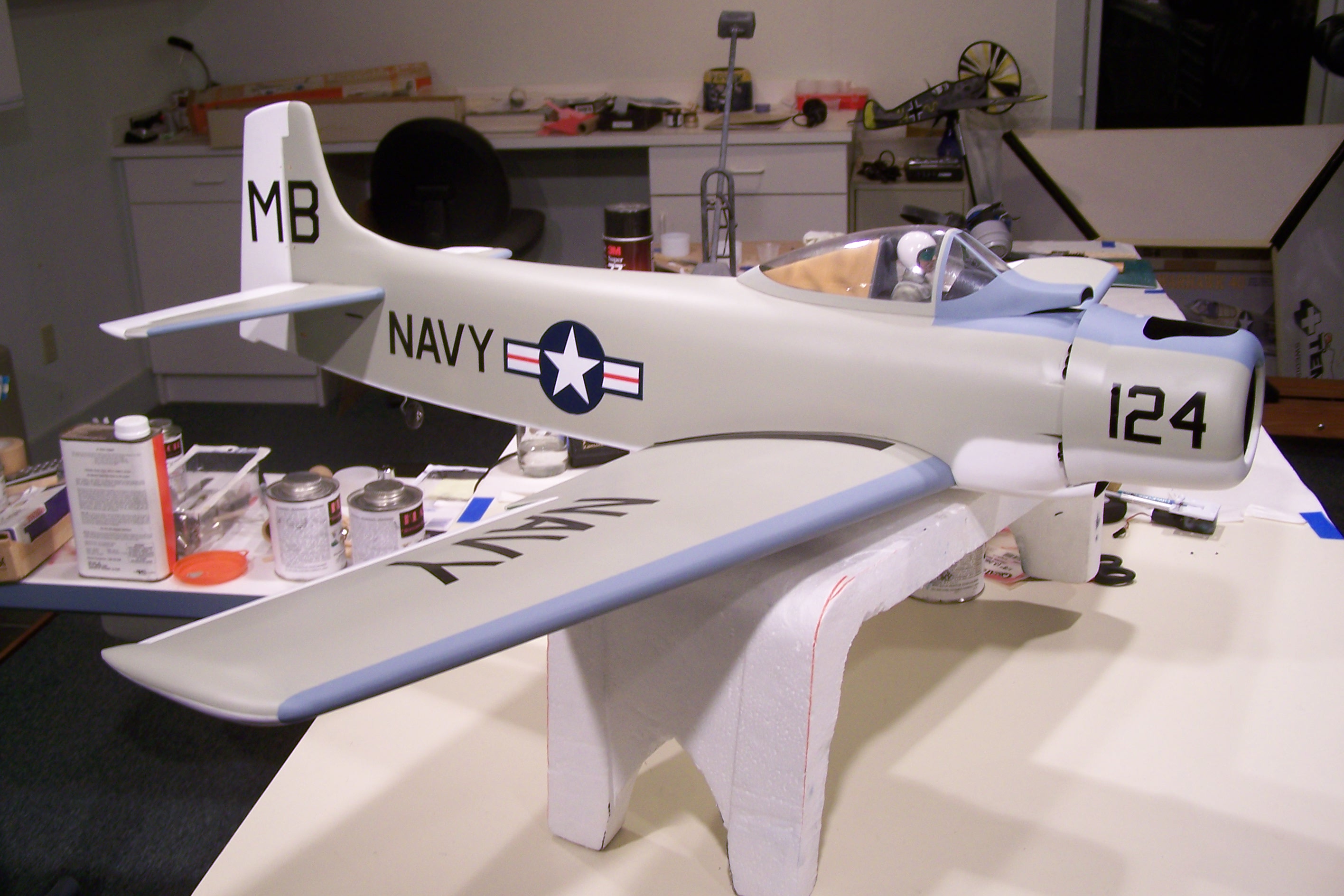

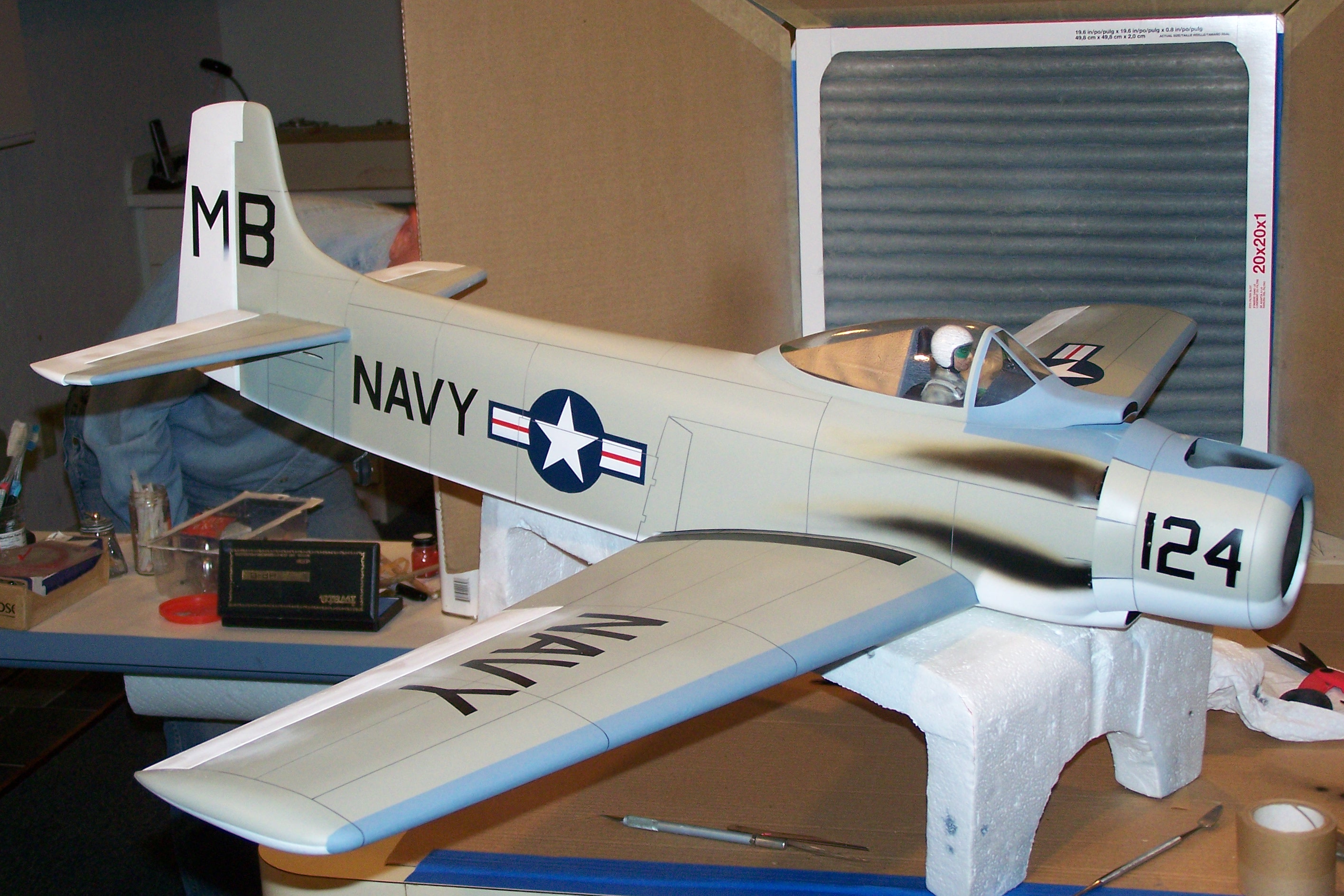

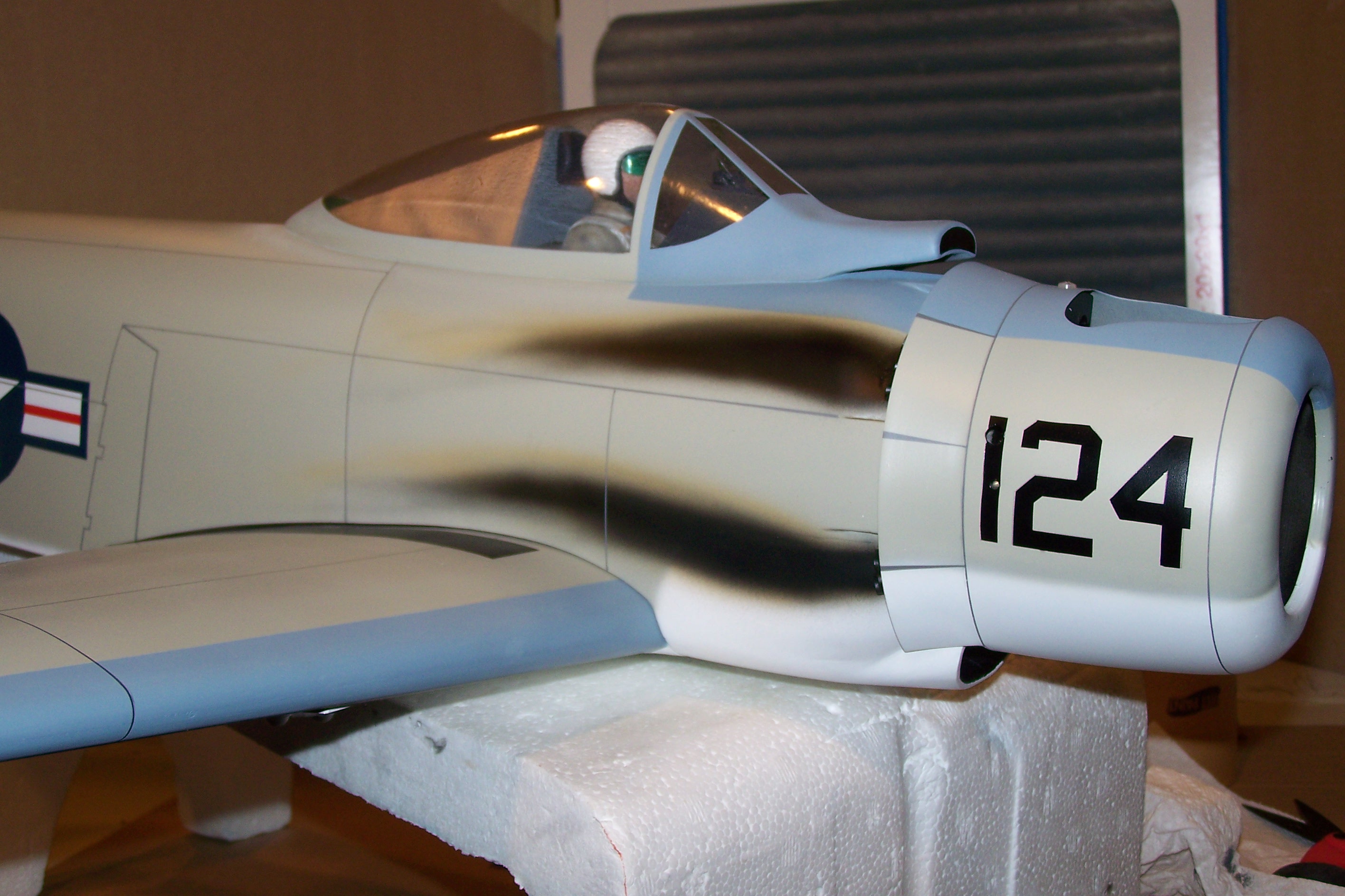

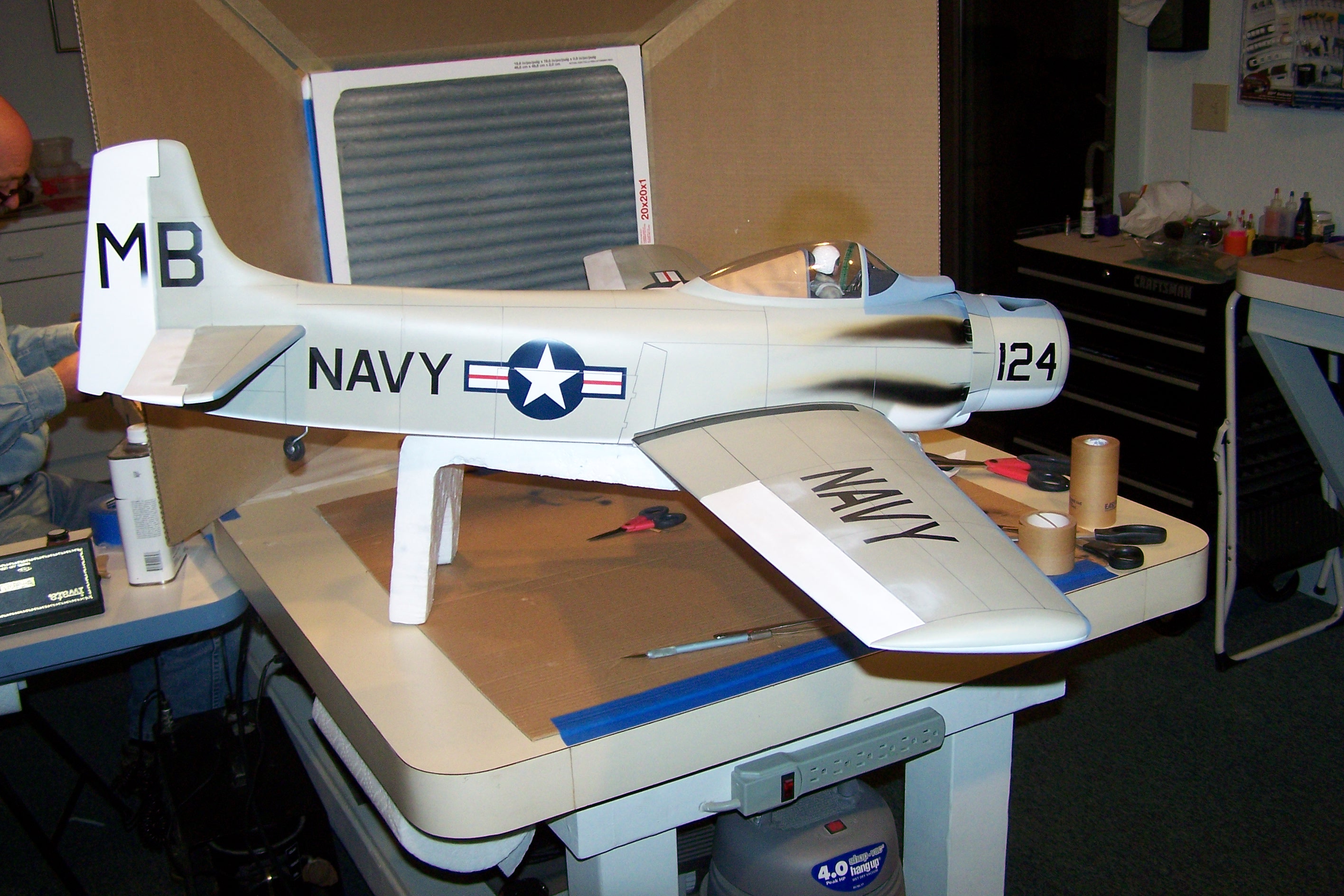

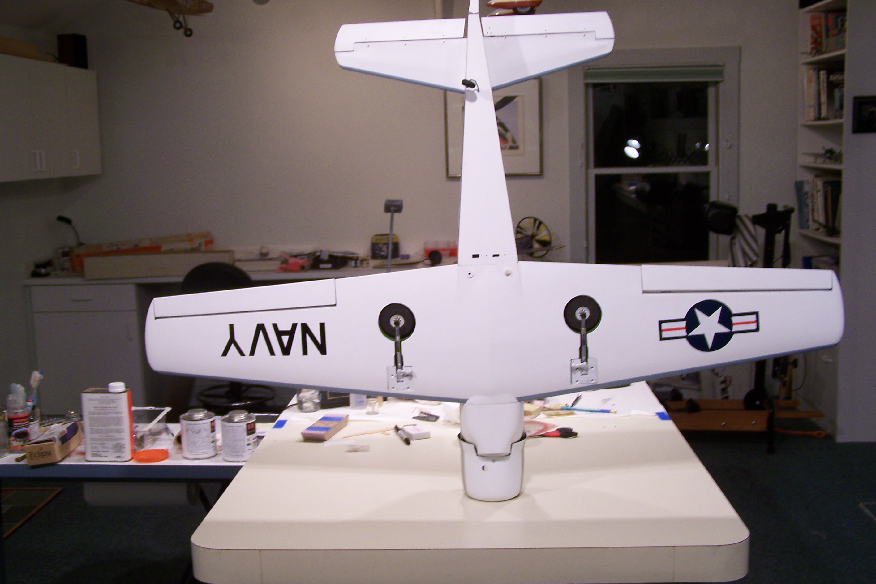

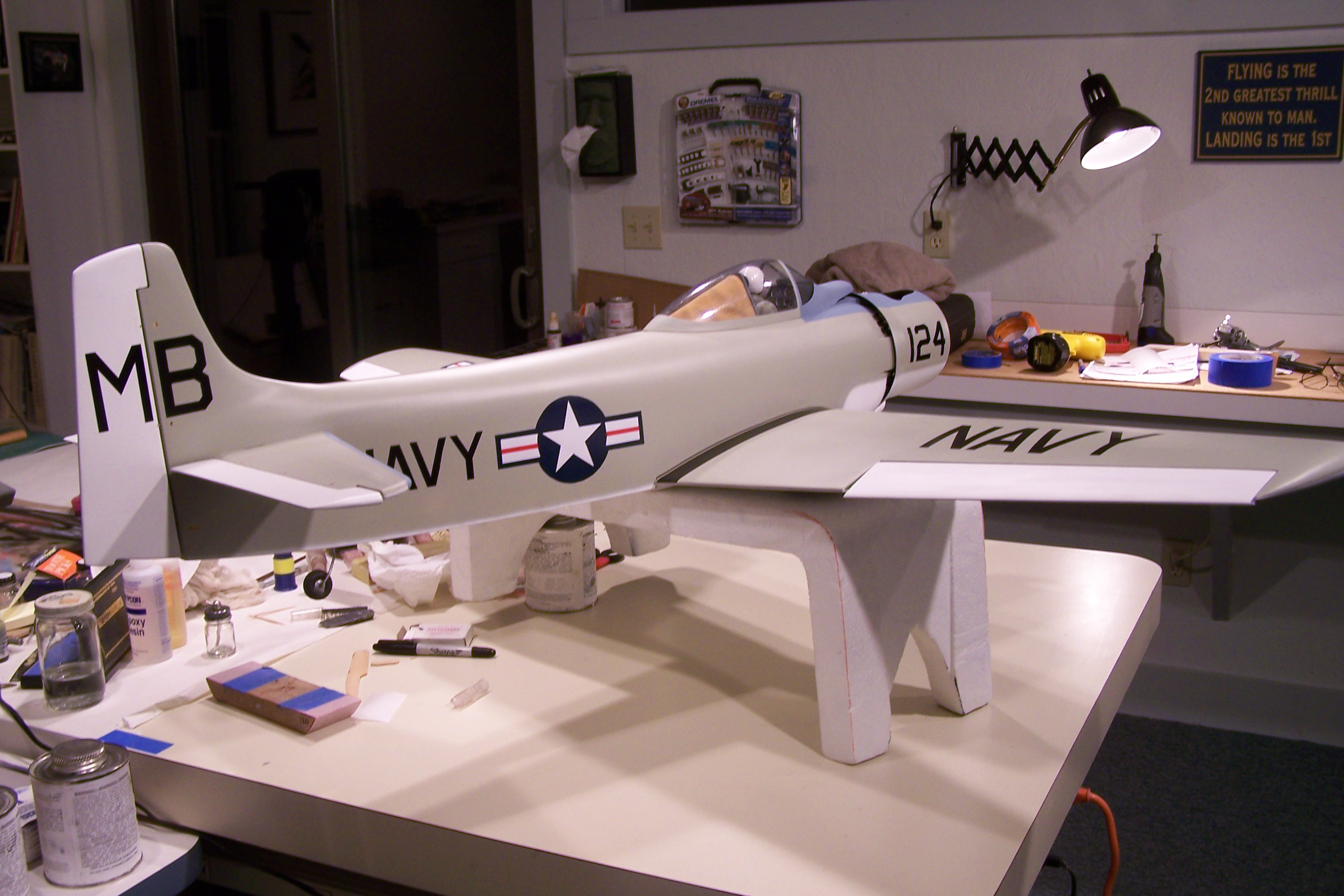

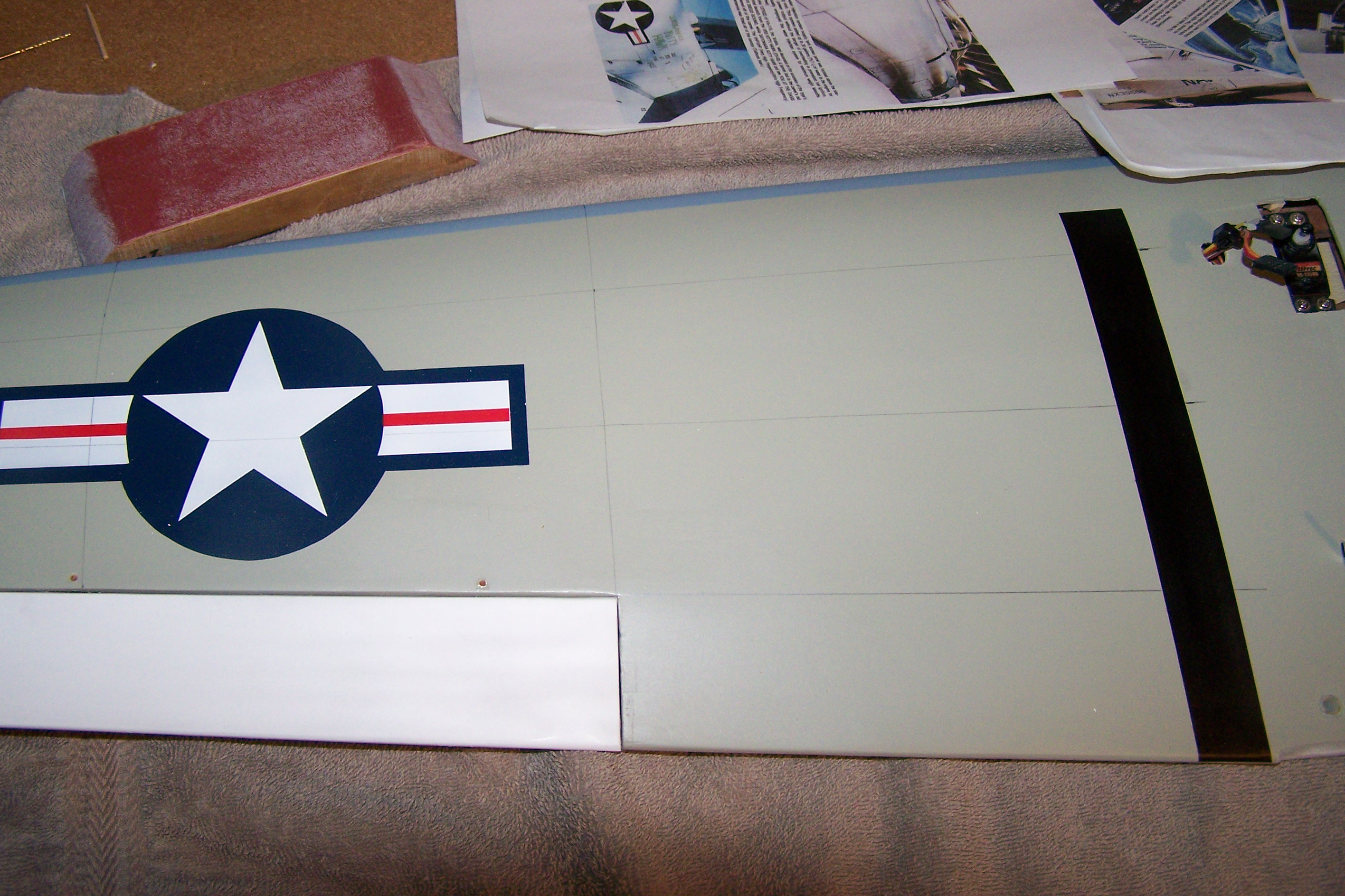

Hi Bob, yes, Tom is right, we do cut the stencils out right on the surface of the plane. The design is drawn lightly with pencil on the plane then the frisket film is laid over the top. It has a light adhesive that will hold it real good but one has to burnish the edges down just before painting to prevent any bleed under then remove it quickly right after the paint is laid down. At least this is how Gerry does it and I'm sure he's right.

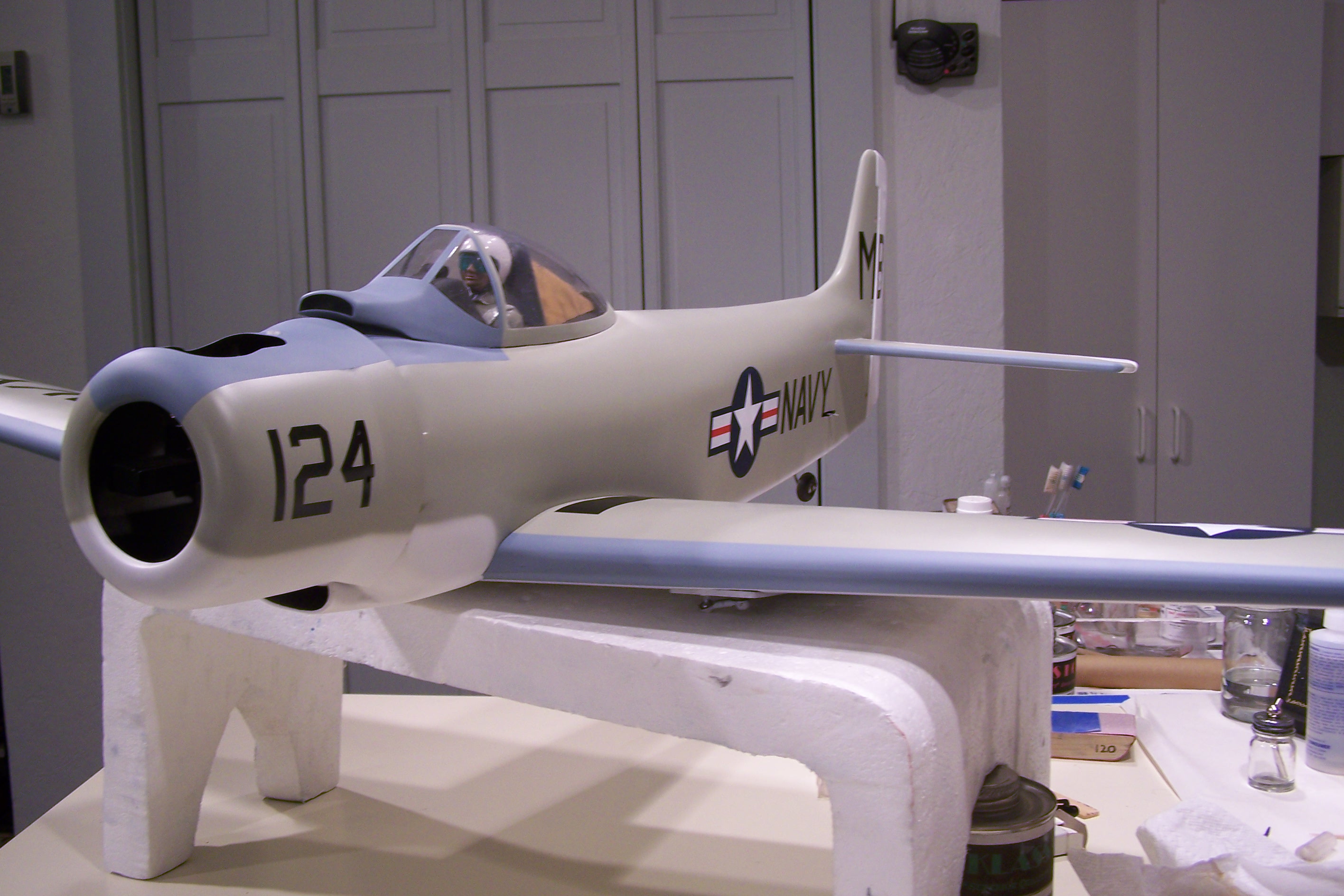

I got to his "hanger" today to do more stenciling and painting. Below are the shots of the Skyraider. It is looking so good. Just some finishing of the hinging and then it's time for exhaust streaking and panel lines. Hope to have it all done for Tuesday the 7th.

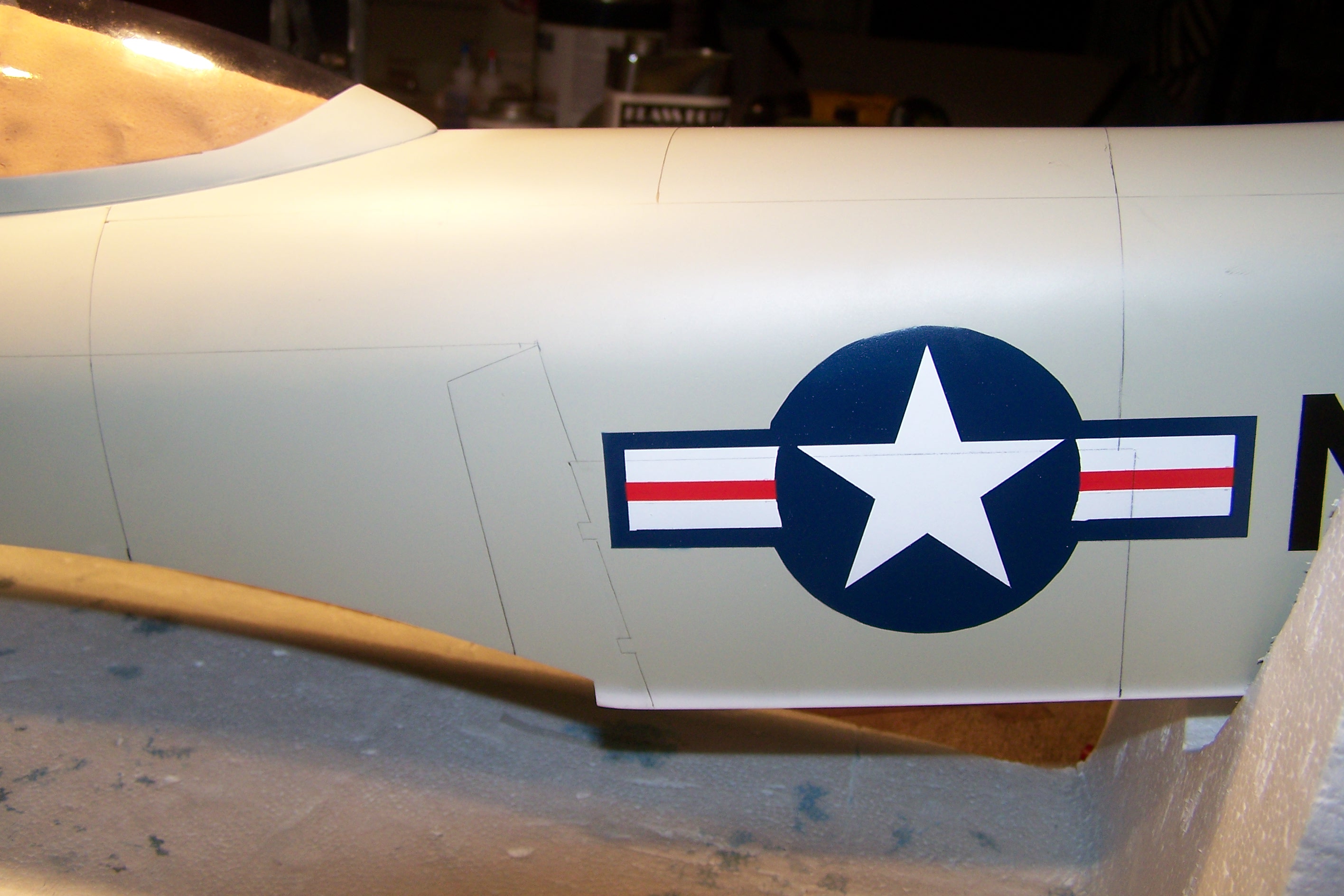

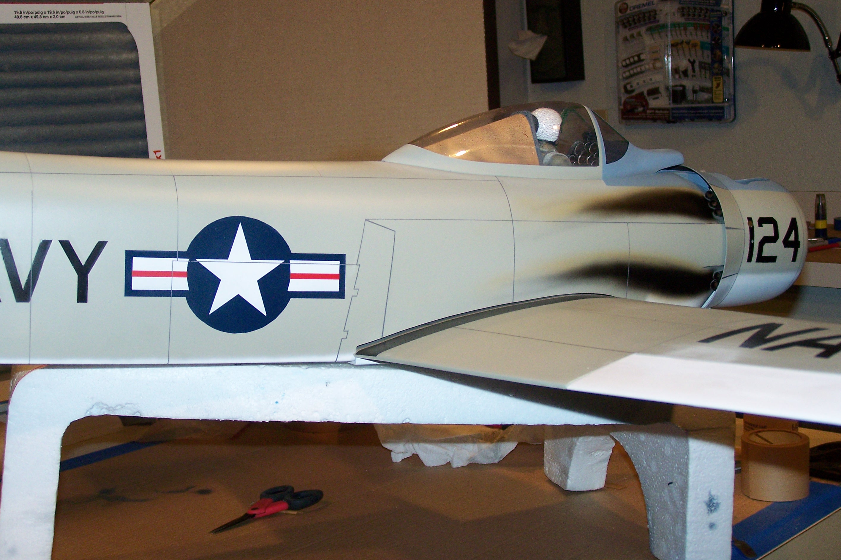

Penciled out some panel lines and started learning how to use the airbrush for panel lines. Gerry did the exhaust streaking and the hinging. Just a few more panel lines and then reassembly of everything. Maybe less than a week away.
Re: What's on your bench??

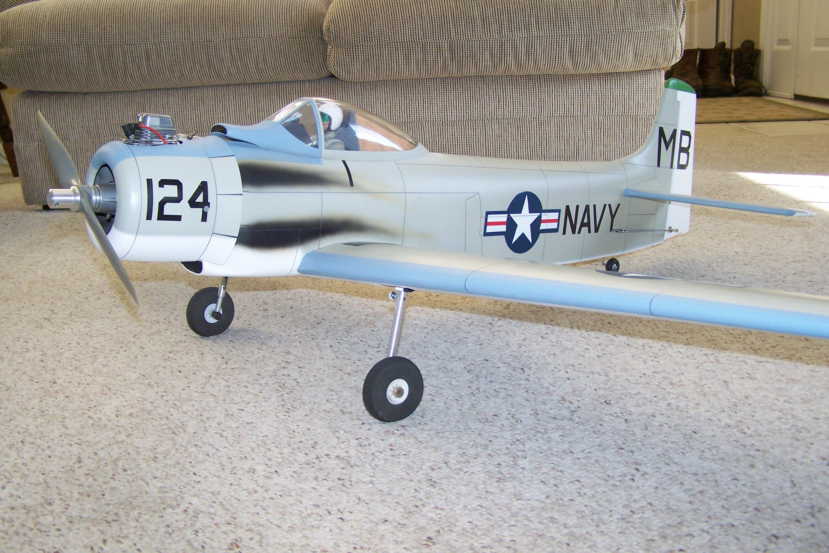

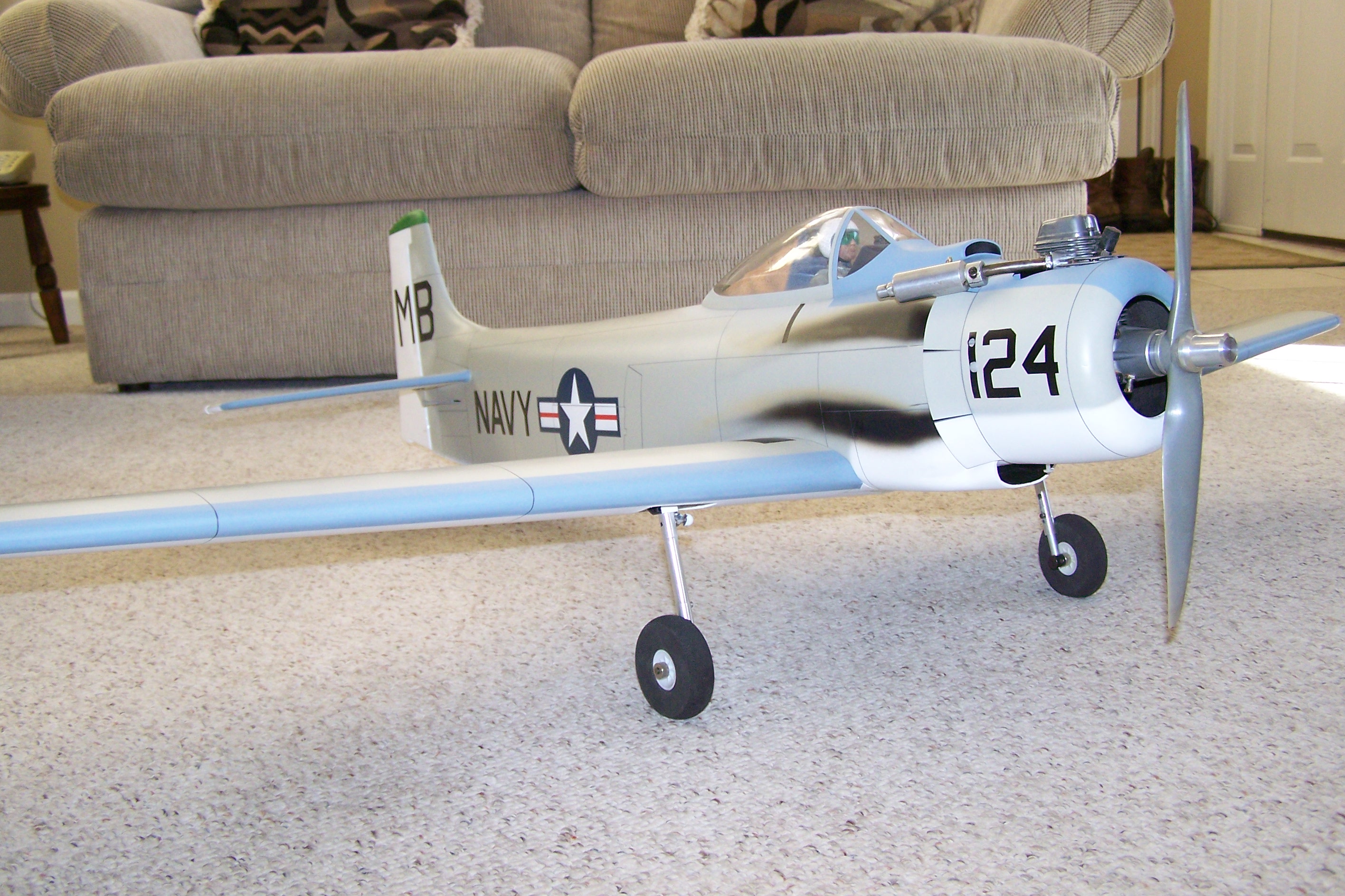

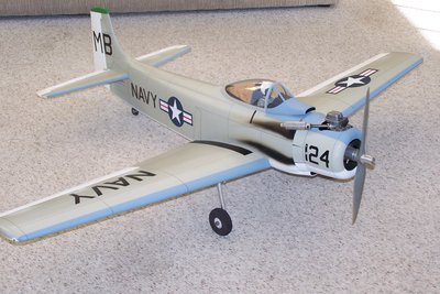

Few small items to add and ready to balance. Then it's the maiden.
