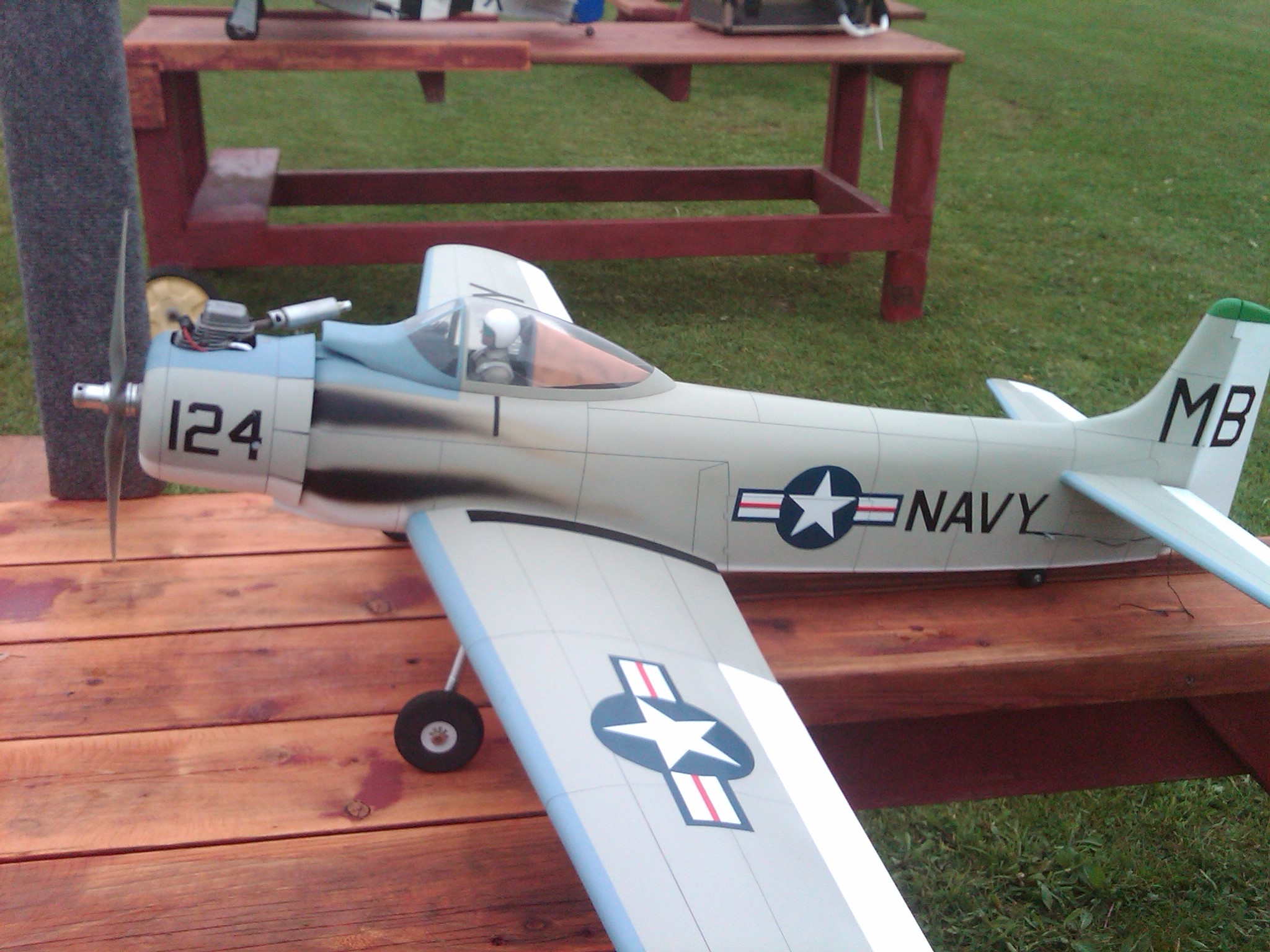

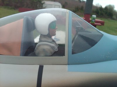

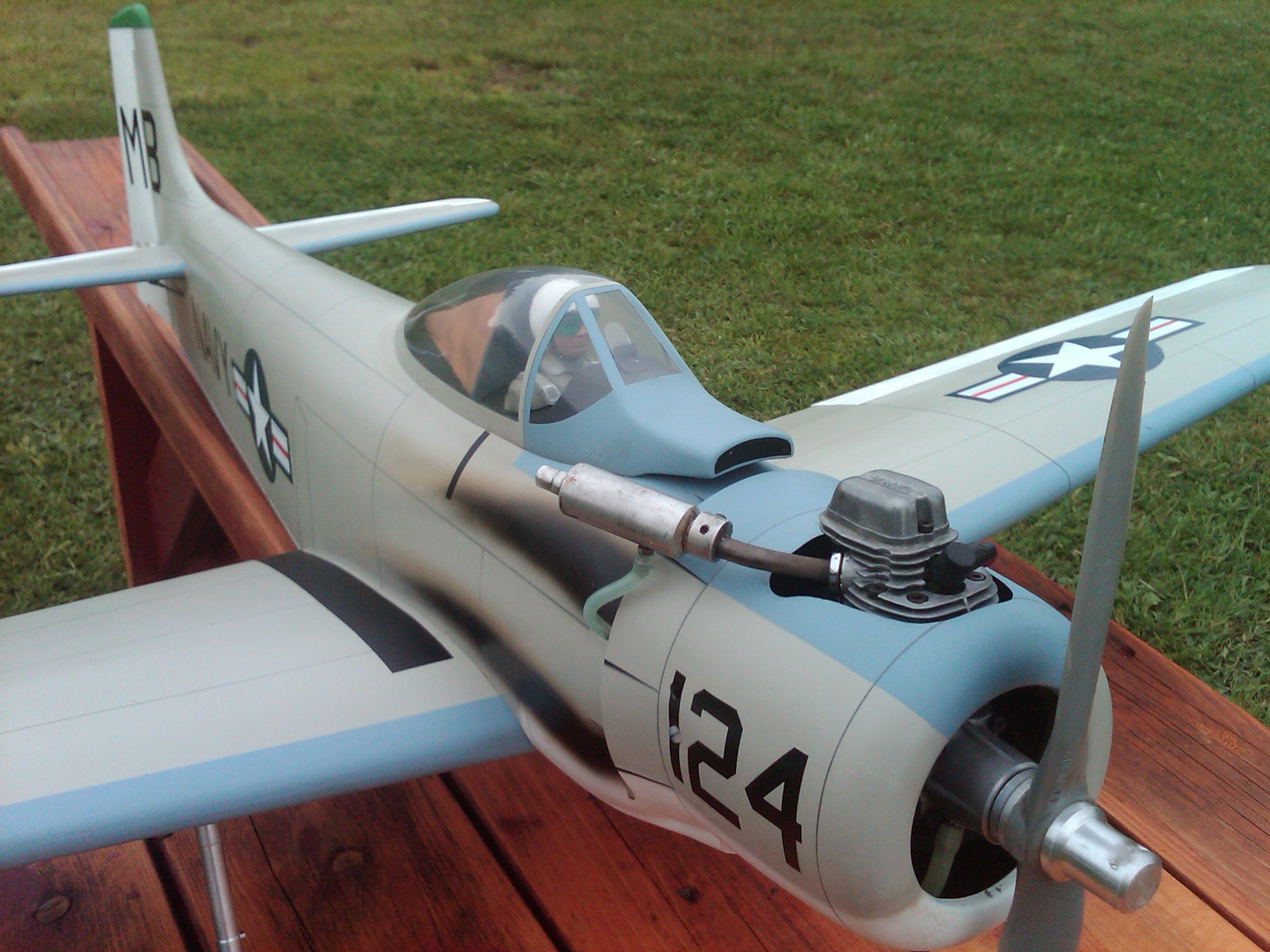

Well, Ned flew 2 sorties the other day and after some motor issues I'm reporting that the Skyraider flies very well. The retracts worked well and the ailerons are very responsive needing only 1/4" of throw. The HK electric retracts with the home made rotating mechanisms also worked perfect and it looks great in the air with the gear tucked up. It needed down trim to fly level and the down trim caused the need for a lot of "up" stick infeed on landing. A quick mix of throttle to elevator solved the issue and makes it a easy lander. Only got some pictures on the stand, none flying, used my Black Berry.

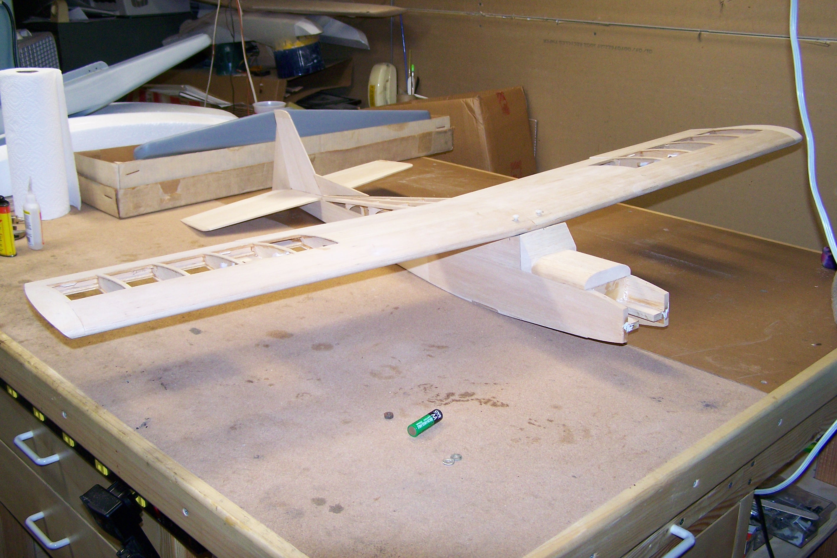

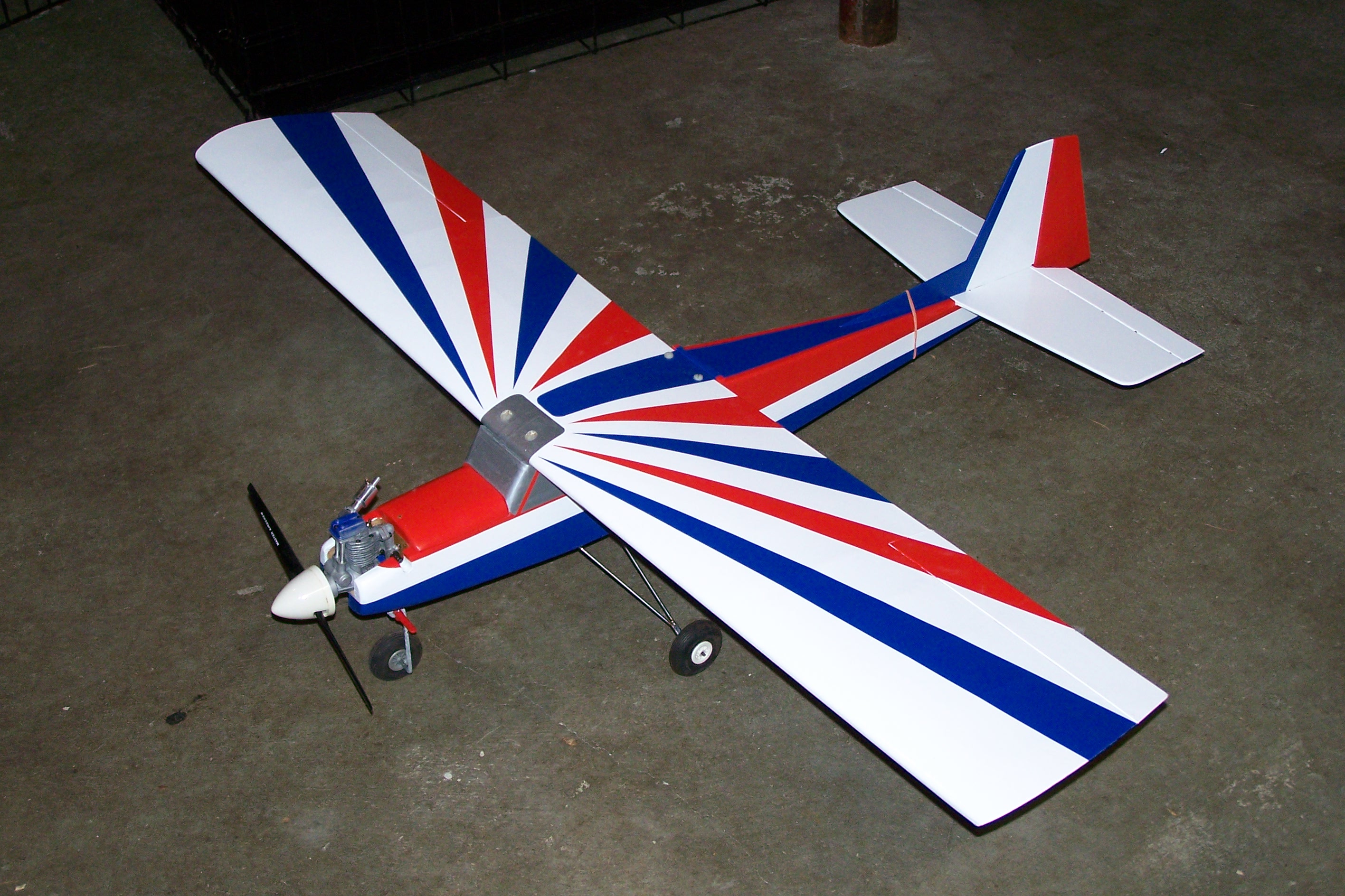

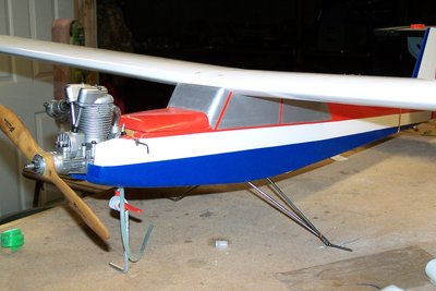

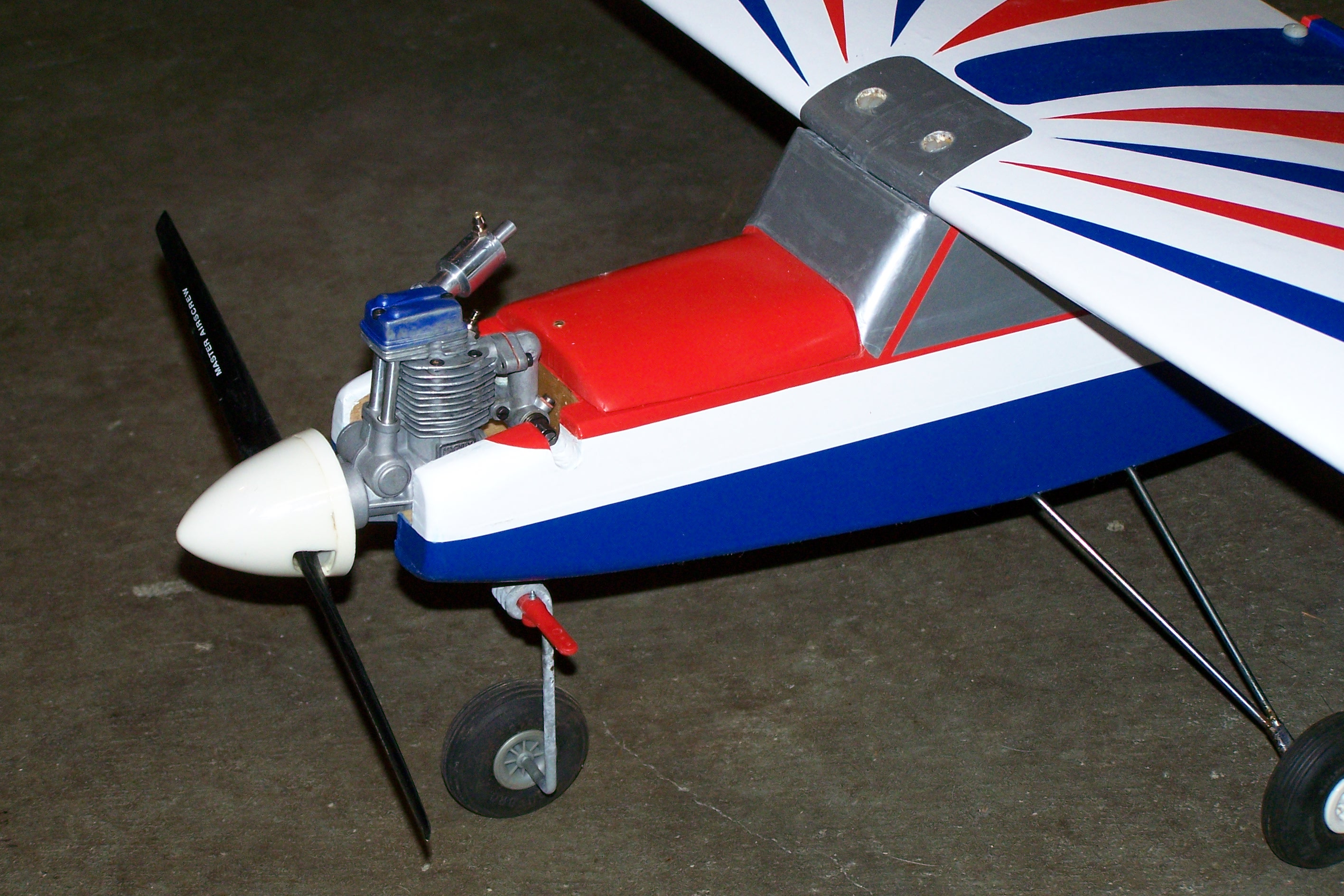

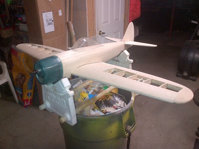

Here is a old Andrew's A-Ray circa (1970's) that I've built recently. Powered w/Saito 45 and covered w/Super Coverite cloth. Currently still in the "white" and will get more colored patterns on the wings. It will be going on floats and be my fun flyer. Had one of these years ago. A super flyer and performer.

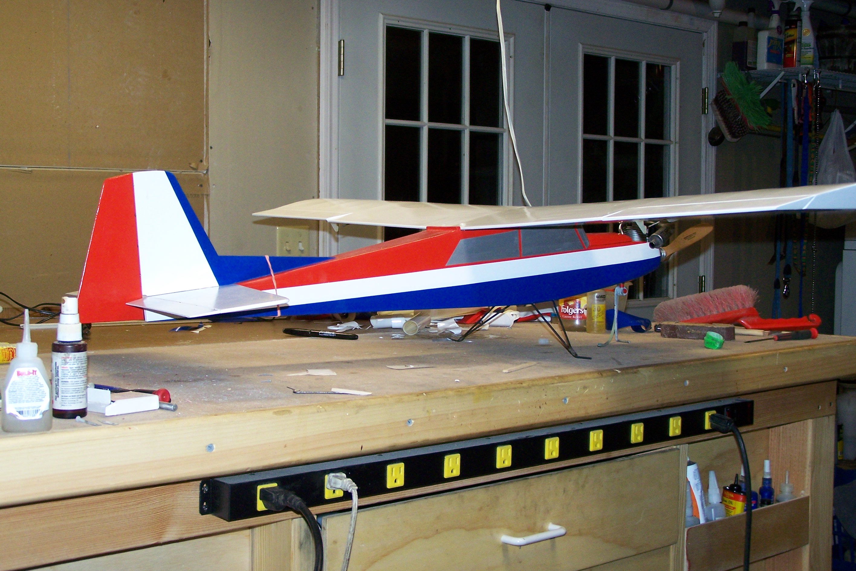

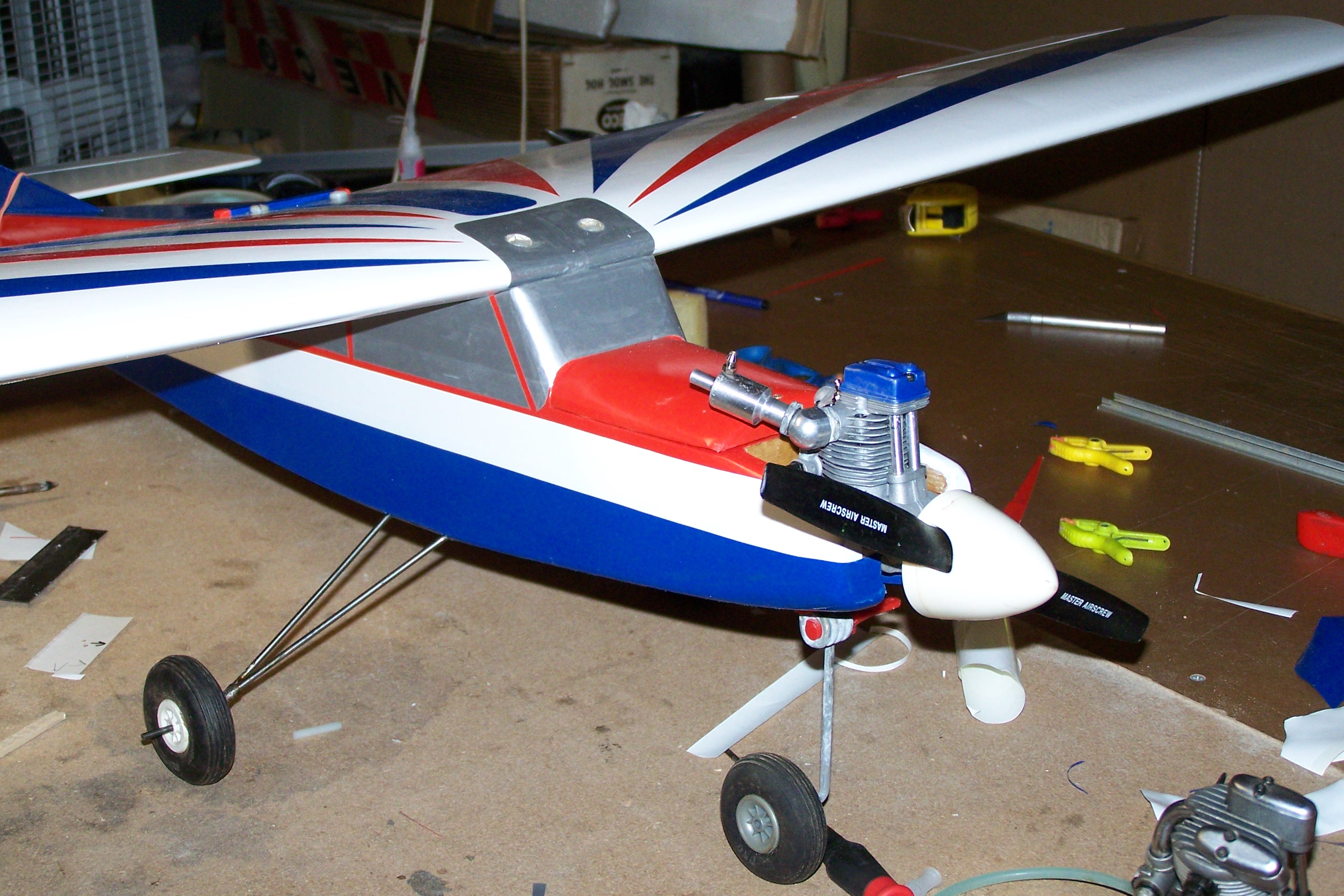

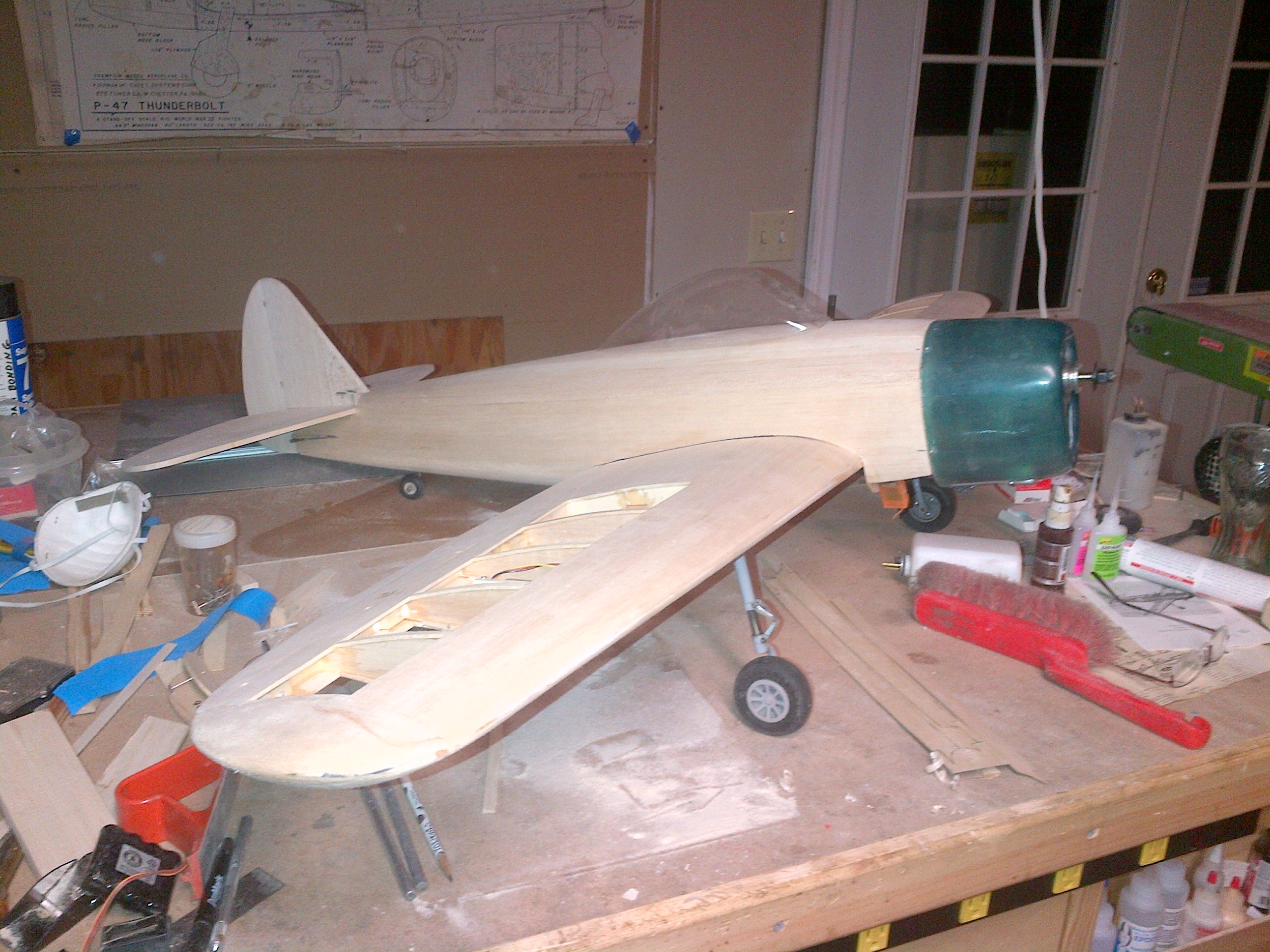

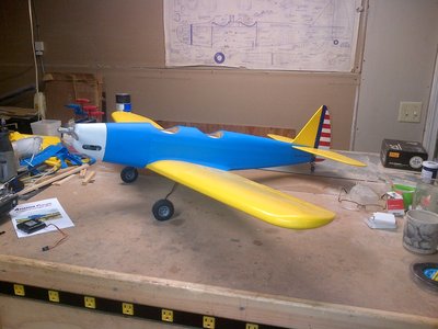

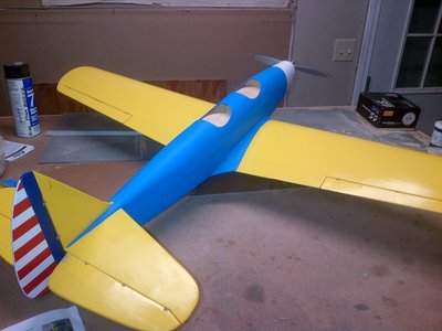

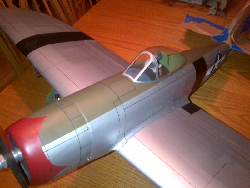

Old Jemco PT 19 Kit. My first foam wing build with many to come. OS 40 and all cloth covered. Needs paint on the cowl and decals. Started working on a Davey Ind. P47 designed by Nick Ziroli. Saito .65 FS, electric retracts and tailwheel. Full flaps. Just started back on it tonight. Will get total covering in aluminum Solartex.

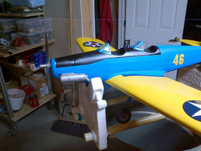

PT 19 flies and looks great in the air. The wing of the P47 is all covered and the fuse is all sanded ready for covering. Because this kit is open bay type wing and it is more of a fun scale type aircraft it will be all covered with solartex with some painted details.

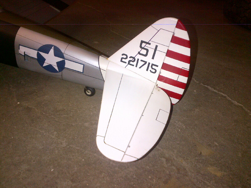

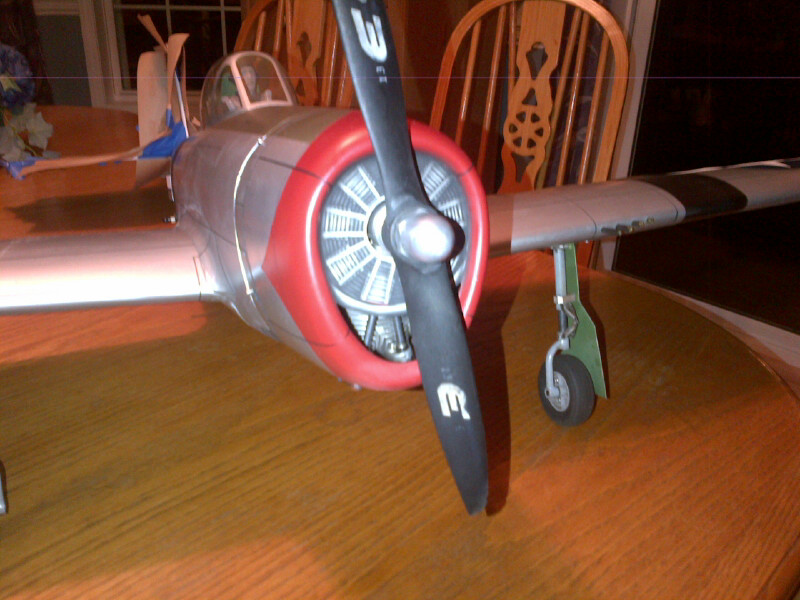

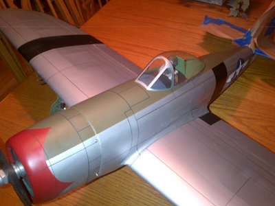

Here is the Jug all done and painted. Everything is paint including the insignias, numbers, and the Gerry Dupont Radial engine. Most was painted by me and this is my second foray with the airbrush, the PT 19 being the first. Super flyer. Considering it was designed in 1968 it is amazing how well and easy it does fly. Flaps really make it nice on landings with a 7 1/4lb flying weight.
