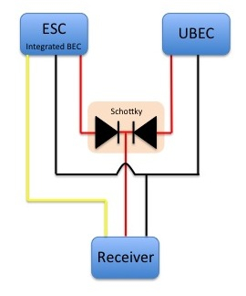

Now you can up your E-Powered Plane Power Redundancy
This is a good article on having your ESC Bec activated and have an additional UBEC in line also. No need to remove the signal wire either. This gives you a dual powered system. When you are running a larger plane it is wise to have a higher amperage UBEC onboard. Most Esc controllers only give you 3 amps of safety in the built in Bec. Most are for 2 servos. 3 if on a 4s lipo.You would have to install a good UBEC with 5-8 amps if you have a ton of servos and other options just in case of a brown out glitch of power to the receiver. This system gives you a backup circuit to funnel power direct to the receiver when the Bec fails to provide steady current. Simple and very cheap to make this unit.
Info, diagrams, and video here.
http://www.rcgroups.com/forums/showthread.php?t=1854050
- Schematic
- Schematic.jpg (40.49 KiB) Viewed 49407 times
- Shottkey Bec circuit.txt

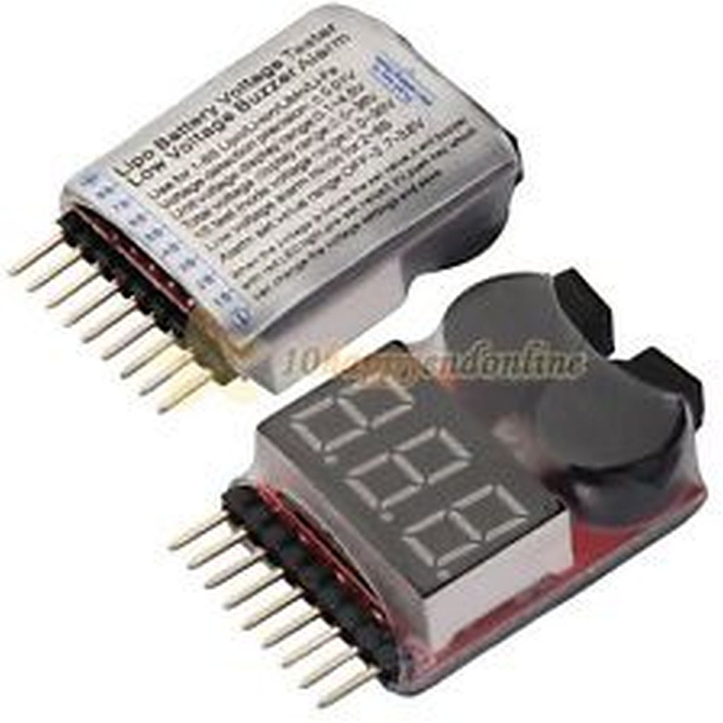

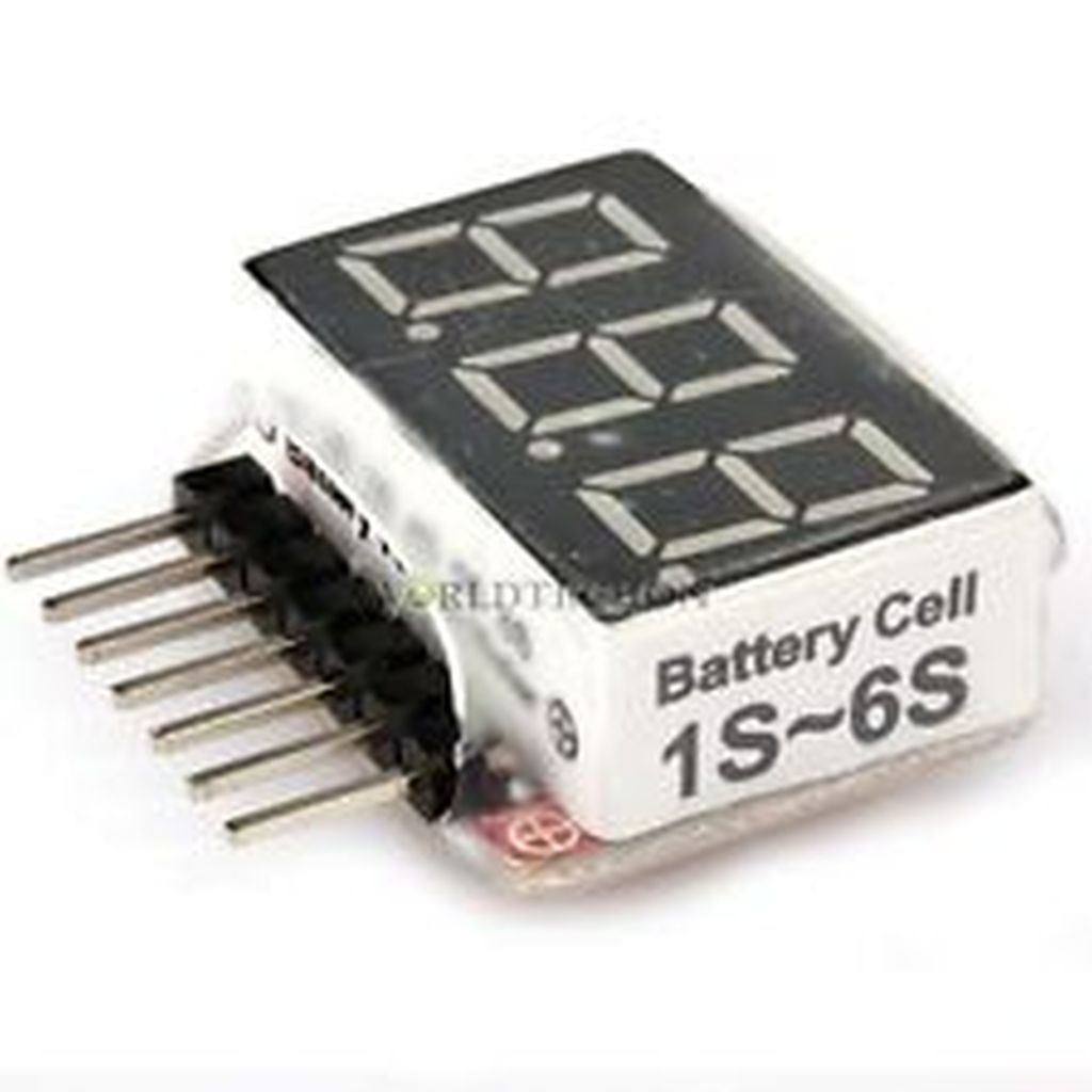

Any one of the checkers below will monitor your battery before and after a flight. Do not ever try to make a high amount of minutes record flight with a new unfamiliar aircraft. Take it up for a 3 minute timed flight as a test. Land it and see the individual cell voltage. Look at the graph above to get a percentage of life left in the battery. Always leave some reserve. You never know when you have to abort a landing and you go around again for a new landing approach and do not make the field and spiral in destroying the plane. Common sense and practice. Always have a checker on your person while flying. They are cheap on eBay or Amazon. Buy a few.
http://www.ebay.com/sch/i.html?_nkw=lip ... ry+checker
