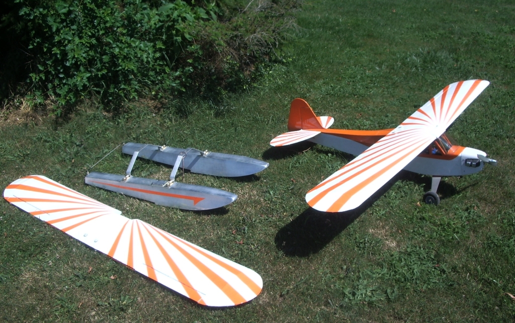

I have 2 wings duplicate. Clipped and full wing.
