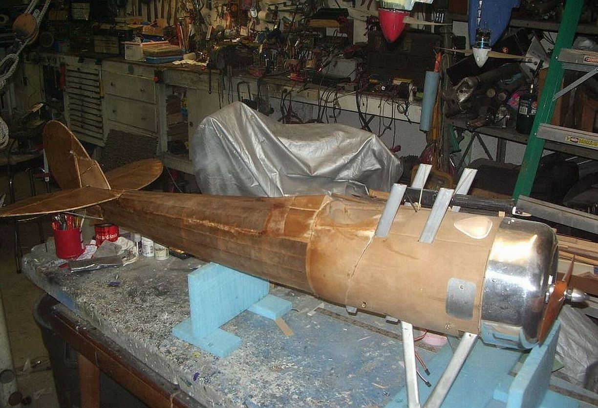

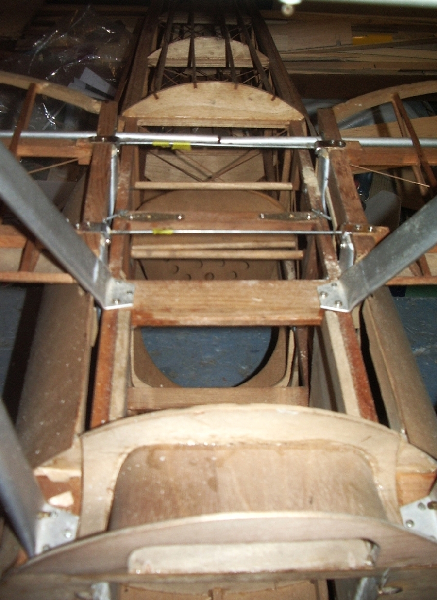

Thanks Tom, I broke it down so I can work on the fuselage and belly cover. I got some push pull cable and a couple metal digi servos in also. i have the gun mounts to do next and move on to the tail feathers rebuilld. I got all my covering in today also. The side covers both need work mounting also. I may go with strong magnets.
Re: Nieuport 28c Add Guns- Access covers- Fuel Tank Cover

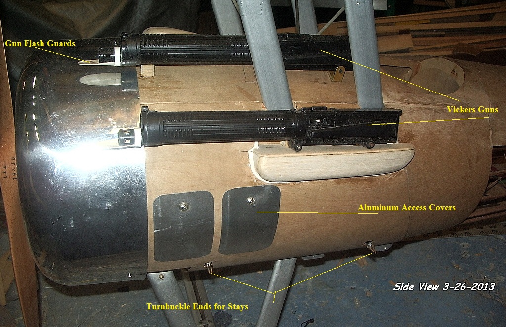

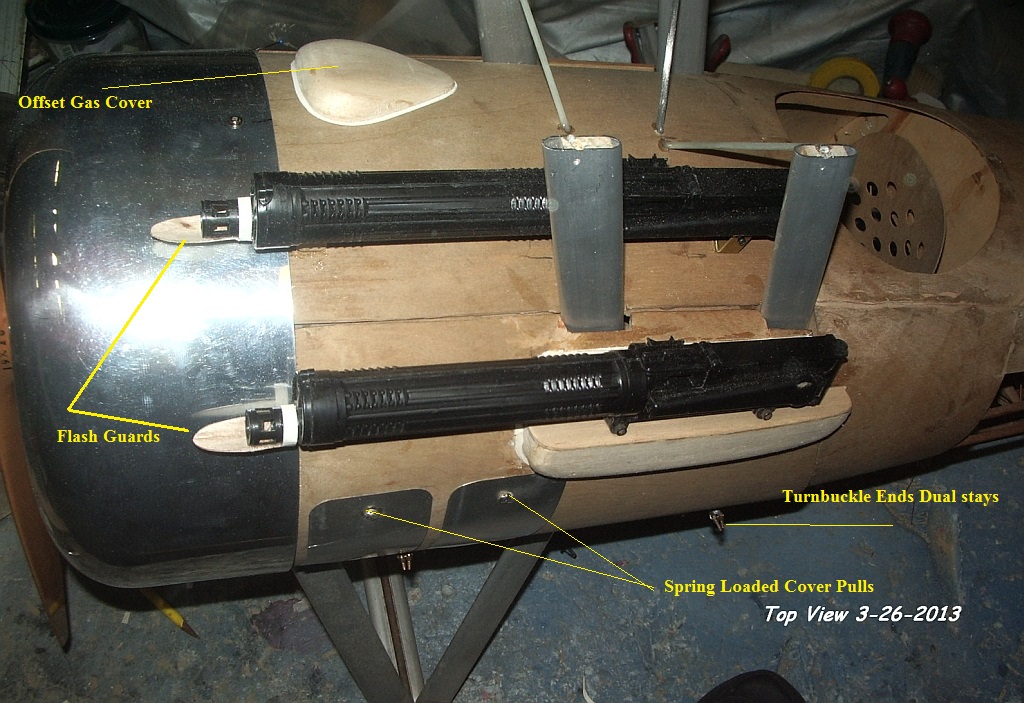

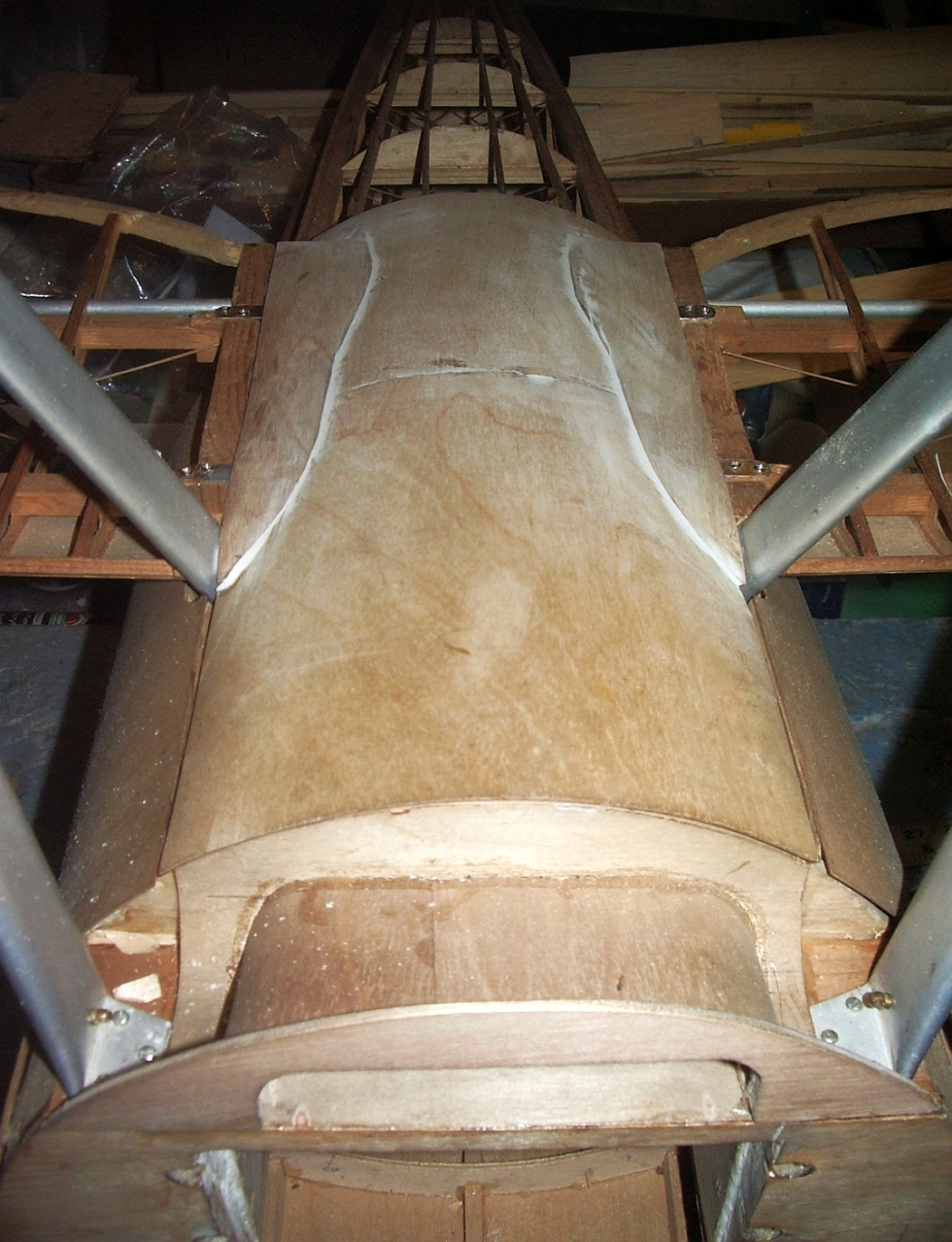

It has been a few days. I try to do at least something every day. I just built a Quad copter in the last 2 days also so it takes away. There was no gun mounts and fuel tank cover with the plane. They were plastic anyways. I made them out of balsa and got them mounted. The guns are bolted down to the cowling with wood or brass mounts. The side covers are sheet metal aluminum just like the real plane. I decided no wood here. It rotates on a spring loaded pin that holds it against the fuselage.. I can hide the nose removal rod in here and a safety switch.

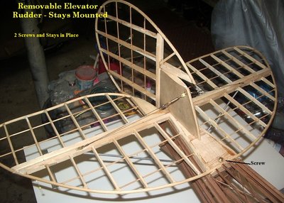

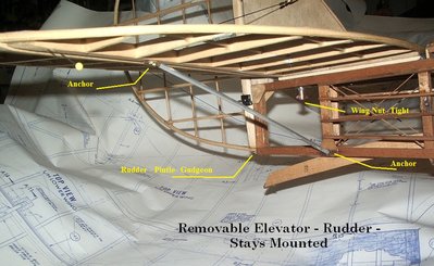

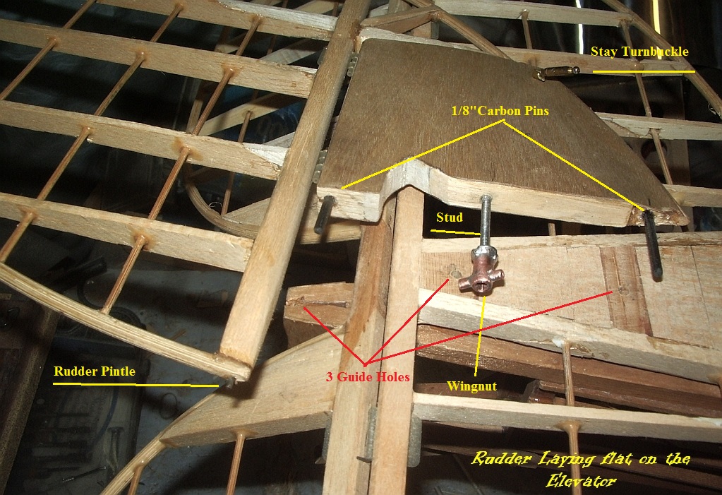

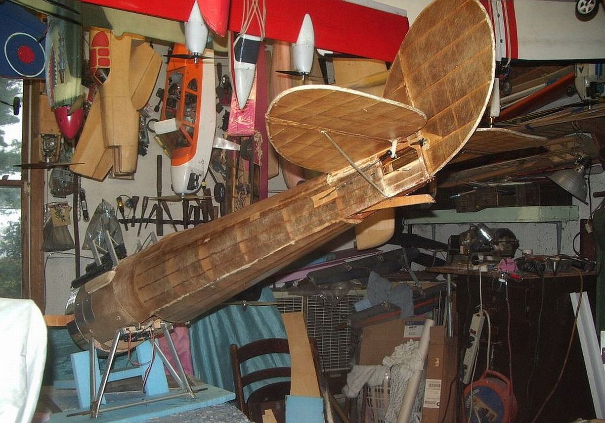

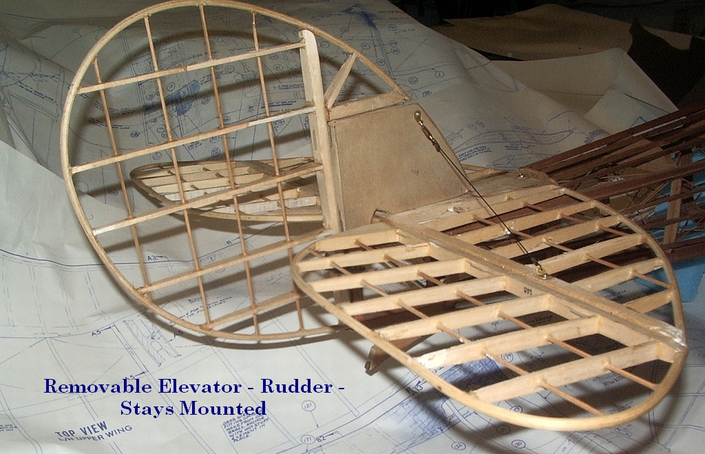

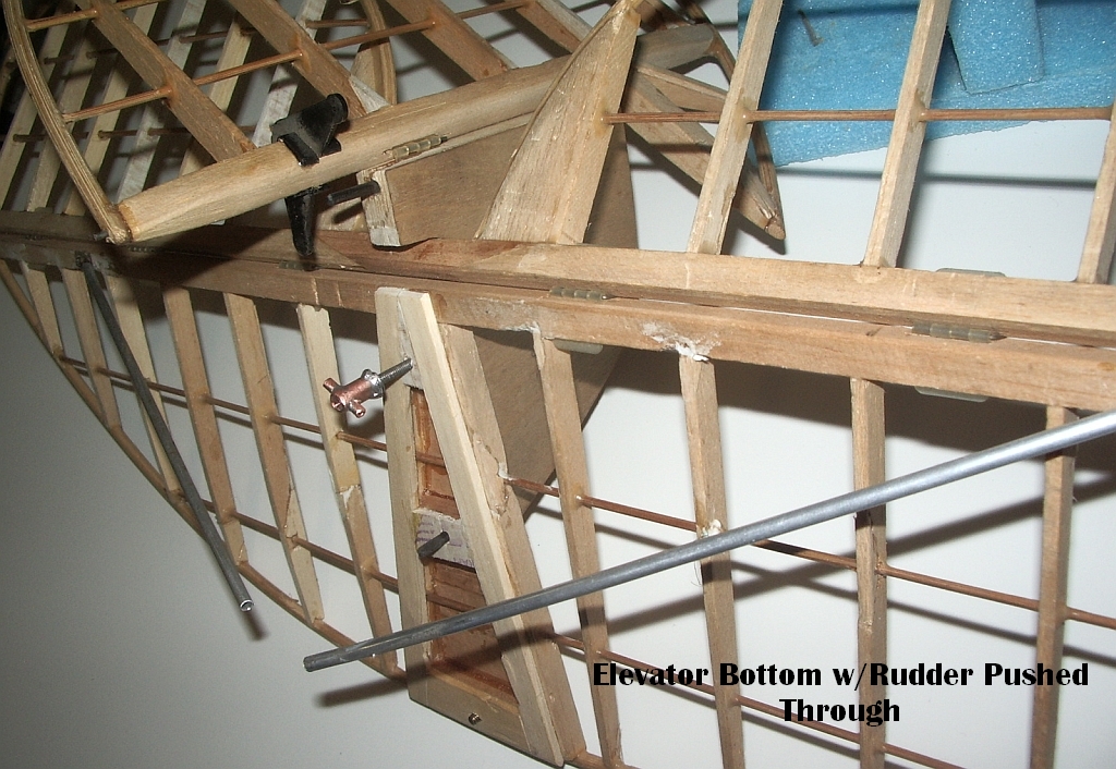

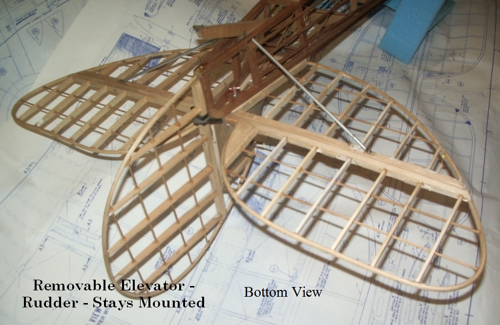

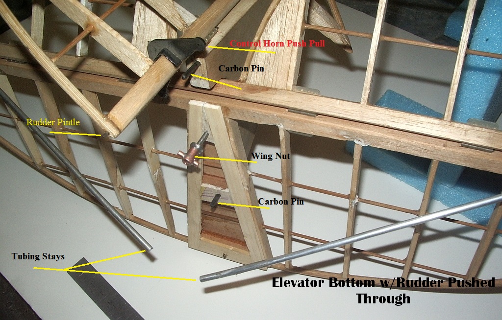

Got the empennage assembled this week. It had to be thought out and tried before changes were made. This will make transporting and other movements easier. First I had so much animal or insect damage in the tail structures. I had to repair the ribs in the rudder and elevator in many places. The vertical rudder post had to be replaced and then the ribs. The elevator had one side all replaced and the other spliced in areas.
I found that I can make an access door under the elevator to place the wing nut inside and give it a firm mount. The leading edge top screw goes into a blind nut. I think mounting can be done in less than 5 minutes. The tail stiffens up considerably now. The rudder is a pull pull system. The elevator was the same but I am changing it to a single pushrod. It would have complicated the removal. I have to make an elastic for the tail skid as a shock absorber.
I am going to move on to the head rest next so I can get it mounted and fair in the plywood sheeting in that area. There are other parts to make like the dash panel, gun sight and speed indicator. These can go on after covering though. There is also a windshield that can be made later after covering also. There will be some skipping around to do.

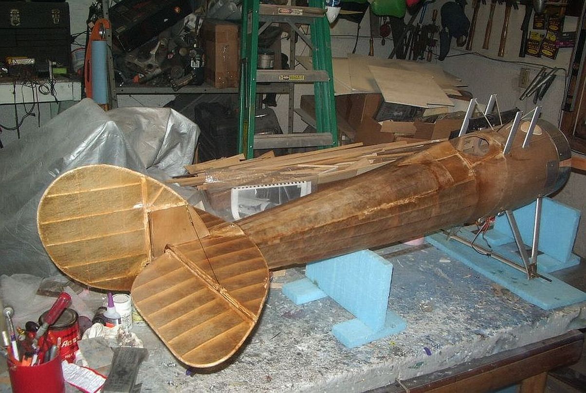

Re: Nieuport 28c 1/4 Scale - Fuselage- tail covering

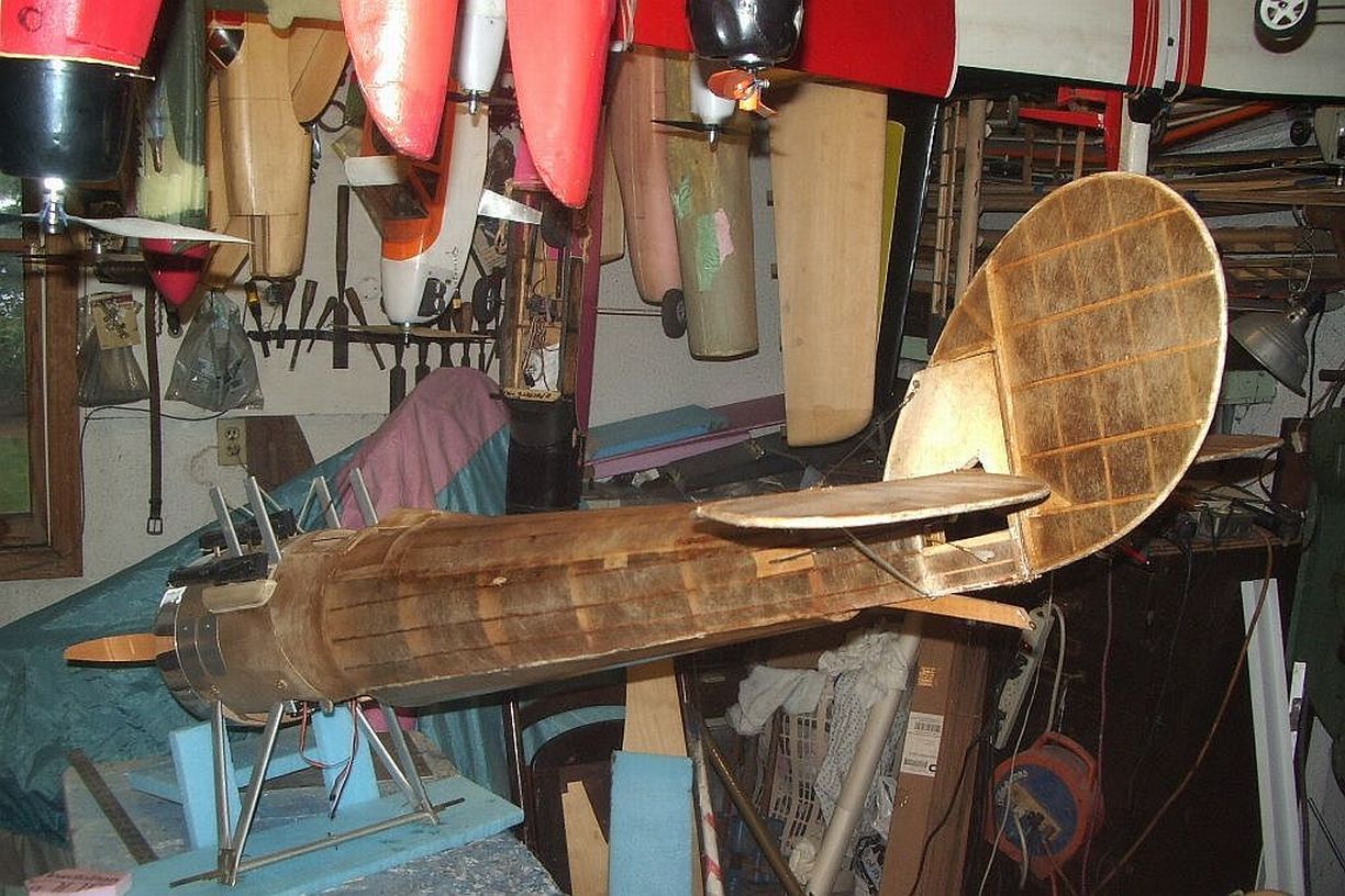

Today I finished sealing the covering of the tailplanes and fuselage with Dave Brown SkyLoft nylon covering. It is a nylon fiber covering that is very tough. It looks like silkspan and is very light weight. You cannot push a pencil through this material easily. It is very hard to work with. it goes on wet and has to be put of with a coat of clear dope. I used some Aerogloss that was off color as it had been hanging around a while. Consistency was very good though. In many cases I had to use CA to make a bond while wet. As the material dries it shrinks tight. This will be a good base for my 4 color camouflage.
I am going to use waterbase paint to finish the plane. The fabric has a nice resilient feel like silk but looks more like the silkspan though. For my next covering of the wing I am switching over to Polyspan covering. It uses StixIt from Sig to bond the material. It goes on dry and is tightened with heat. It is similar cloth material like Skypoly but will be better under the wing with the under camber ribs.I work on the plane now when I am not flying or repairing my field damages. There is no rush now as the season is here to fly now.
You can notice the opening under the stabilizer. It will have access plates held with a alignment pin and magnets to help facilitate tail removal. I am using heavy duty ball socket connectors for quick removal for transporting the plane in my truck.

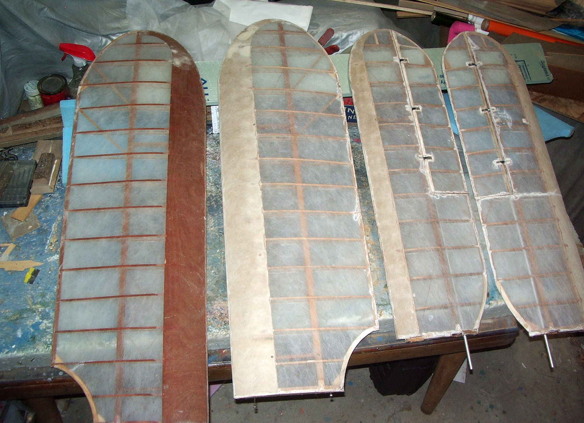

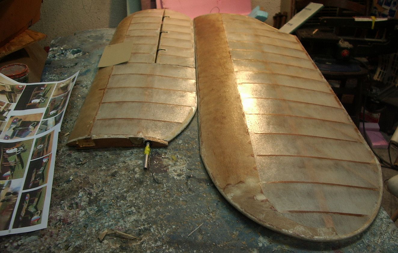

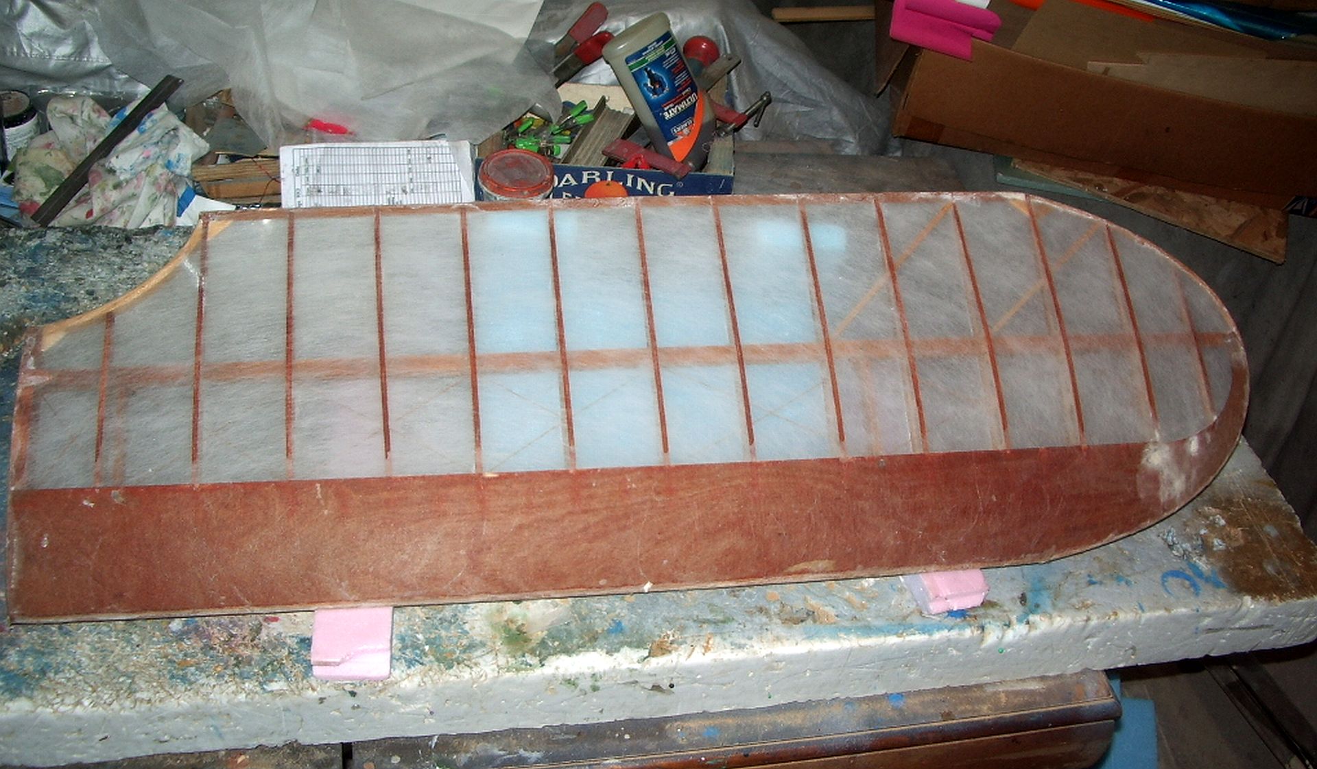

Well in the last week I finally caught up on the small repairs to my field basher and indoor planes. So I brought the 4 wing halves down from storage and prepared them for the Skyloft coverings. I spent the last week sanding and repairing some mice damage over the years from the previous owner storage. Skyloft was not easy to work with but it is very strong and looks and feels like silk. It is a poly material. Silk is catapillar insect matter and breaks down after many years. The Skyloft has to go on wet and grows after 10 minutes. It is stretching and and pinning and water spray it to slow the evaporation until it gets bonded.
The old way was to paint the wood with clear dope a couple coats. Then lay it up and give the Skyloft another coat and hope it bonds before drying material shrinks and pulls away. I came up with an easier way of using thin CA glue while wet. It dries fast and bonds well. It makes the whole job faster and easier. You can see a whitish line. It is the CA when dry from the water. When the Skyloft tightens it is beautiful and I bet you can bounce a quarter on it too. So smooth. Now I have to get ready to paint the primer filler to prep for the finish waterbase painting.

I have a picture here of my sealed wing panel. I tried to get a reflection to show what it looks like. It is very tight and waterproof now. This is as I say my first trial with Skyloft and I am happy with how it came out going at it almost blindly. It is as good as I have hoped for. Here is what I found out that made it succeed for me.
In applying the Waterbase clear Miniwax Poly-u it continues to wet the Skyloft and make it loose again. It was necessary to do it in order to get the pores in the material closed up with lots of talcum powder. I did all 4 panels of 8 sides and then hung them for the night using a 1 inch chip brush. I also did use my heat gun backed away to warm it up and evaporate the water and retighten up again before the next panel got a coat.The next day I repeated the same ritual and hung again. This was necessary because the wood was still damp. I just did not want to over shrink the material.
Next day I sanded every panel with 400 wet dry paper. The sealing looked good except a couple flaws that white glue and talc took care of. Waterbase poly does not allow the material to harden up to sand the fuzz off. The next 2 coats were shot with my small airbrush using Miniwax Oilbase Polyurethane. It took me about 2 hours to get it all done and I hung to dry. Before the next coat the paint tightened and waterproofed all the panels. I could sand the fuzz down now. The next coat was a repeat and that is where I am now. Skipped work today and I will sand tomorrow. I still do not recommend Skyloft for a newcomer.
