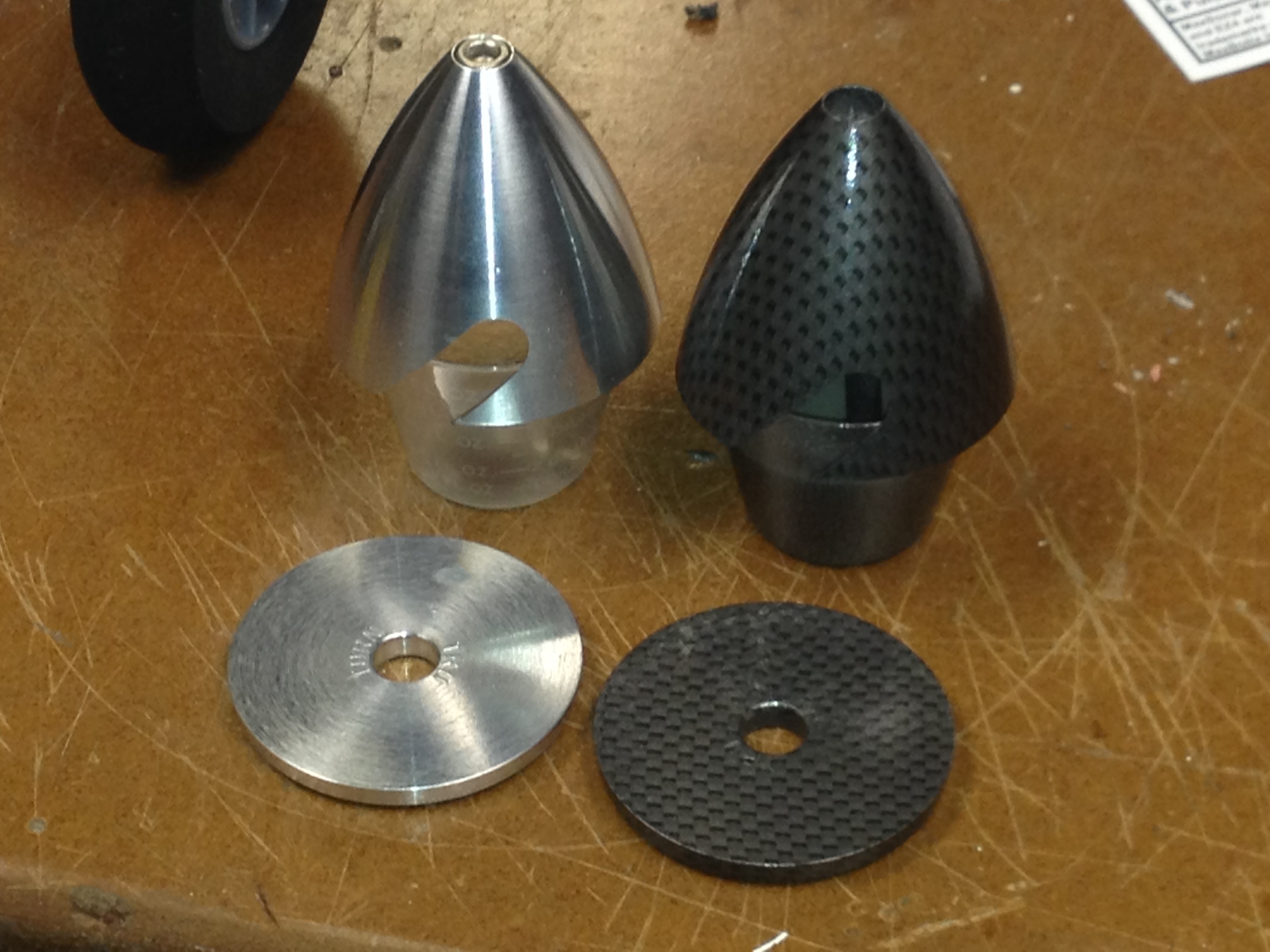

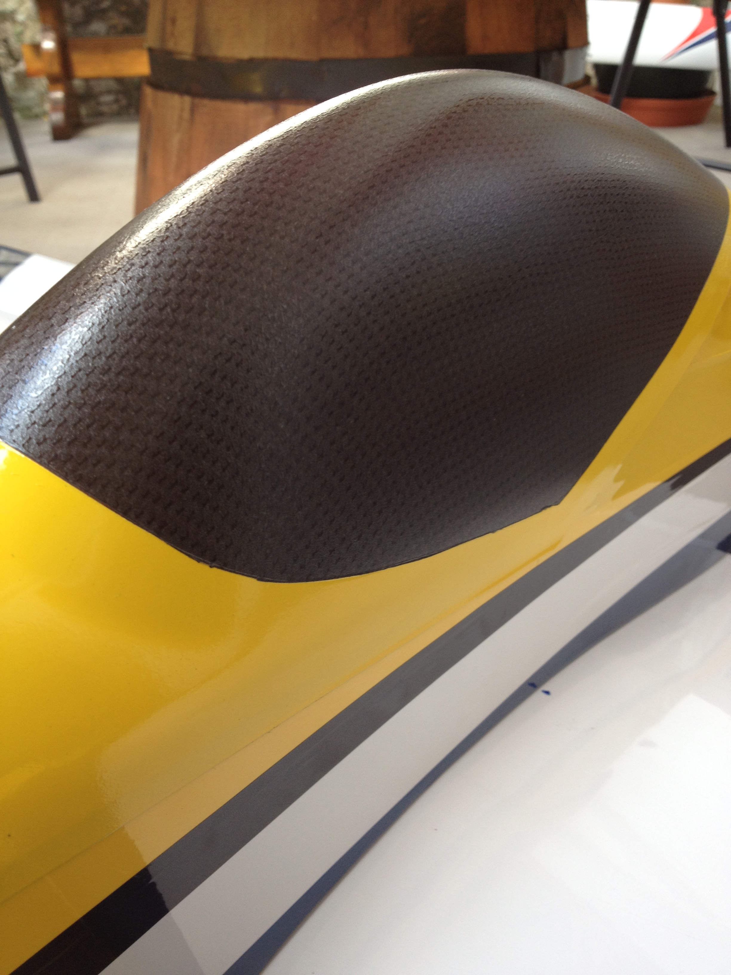

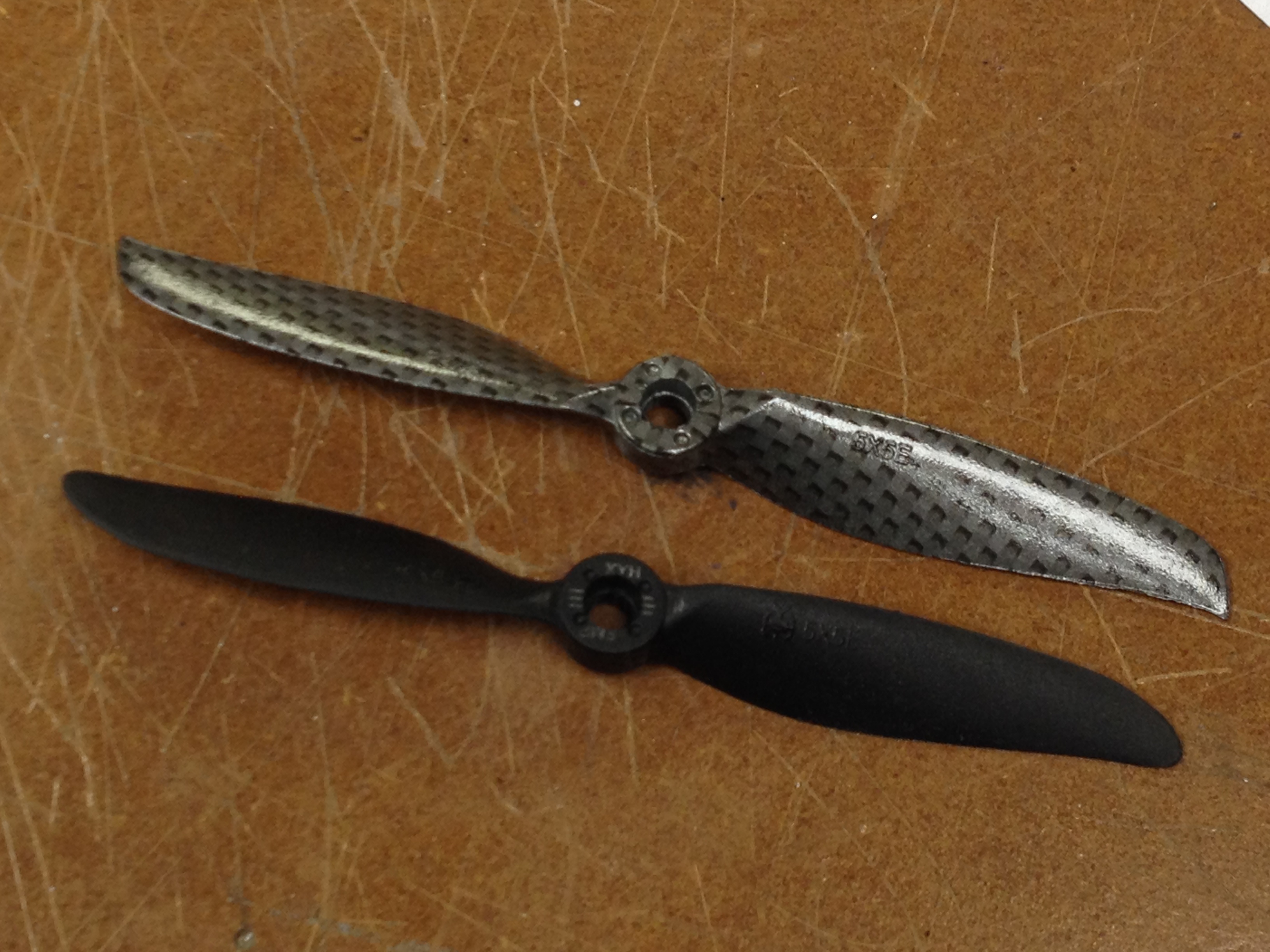

I also attached some pics of some of the objects I tested it on... cool shit!!!??
