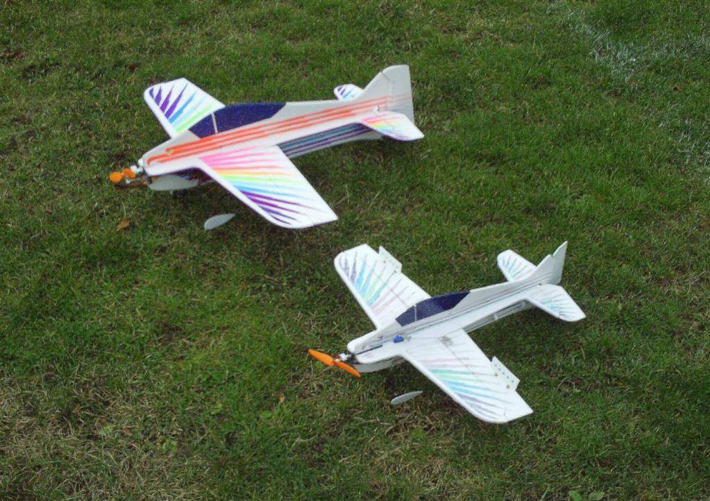

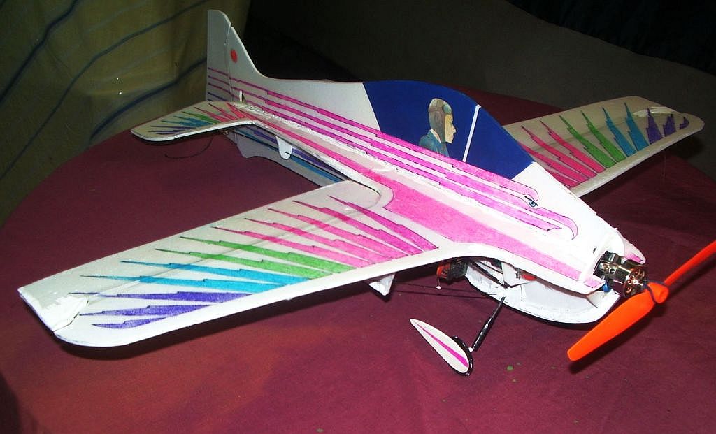

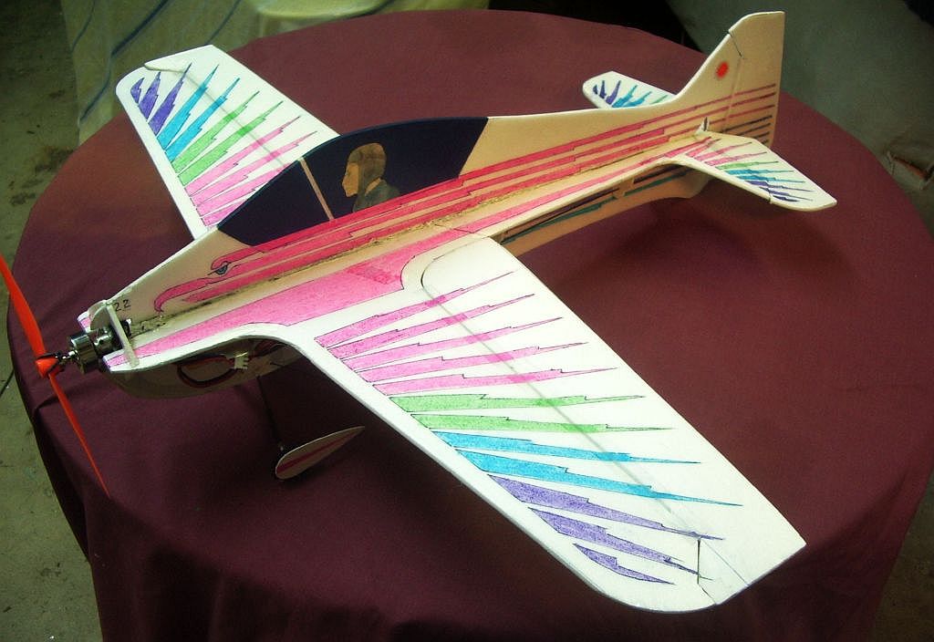

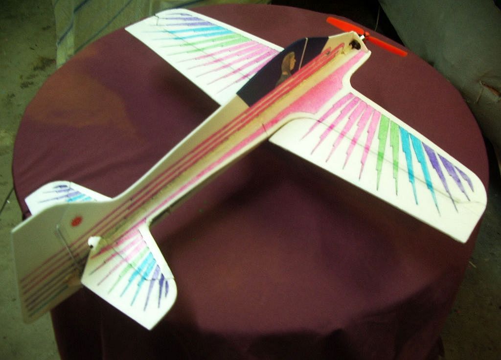

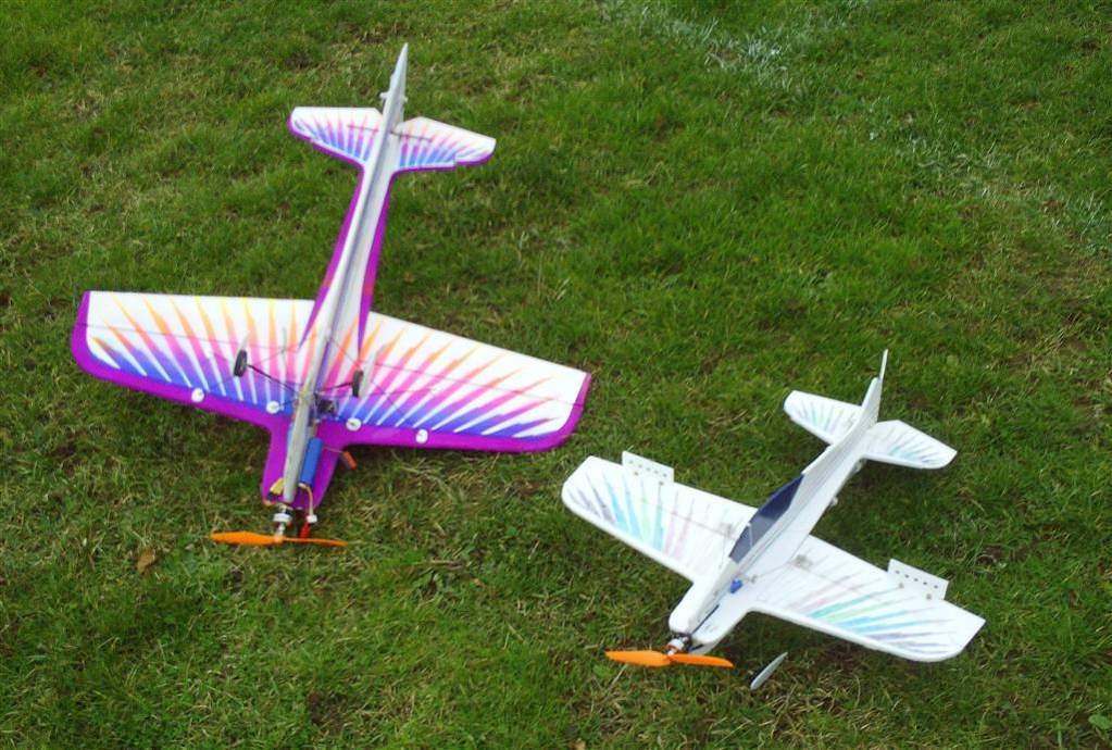

My first one was over built and heavy for it'os small size. Not that this one is super light weight at 5oz. The older one was 9oz and I stripped it clean and finally trashed it.

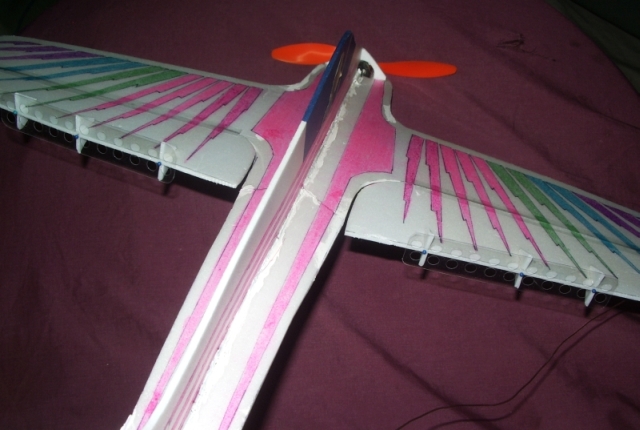

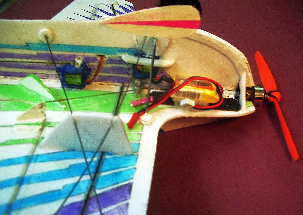

I needed a new smaller Index 3/4 size plane.This is my 3rd one. I made 1 fullsize I still fly a lot outdoors.. So I built this plane in 3-4 days this past week. My last small one had some bad flaws and it was heavy at 9oz. This one ready to fly is 5oz. I did not try to save to much weight as I do no compete. I just sport fly. Some mods I did were a full length 3mm CF rod from in the motor mount to the rudder in the fuselage. I made the wings 2 inches longer.

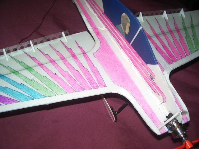

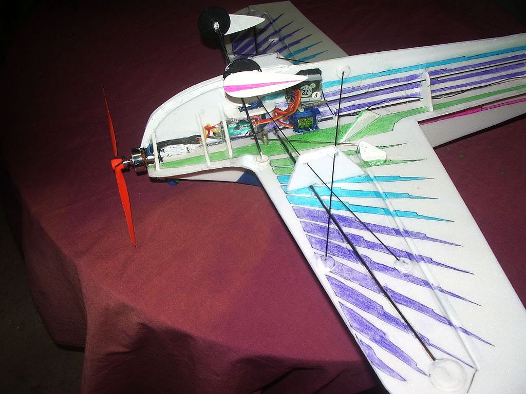

I made a wider edged nose under the motor to reach past the landing gear. It is capped with 1/64th plywood. I also radiused the aileron wher it meet the fuselage to give the fuselage more strenght in that sharp corner. They seem to break there easily. The wing bottom has a long additional CF spar. I left out the smaller CF fuselage twist rods out. I am sure I could have easily dropped the weight down more with smaller servos and cut down the wires and use lighter glue. I would rather have it slightly overbuilt for my type of flying though. Notice there are no electronics on the top of the plane.he landing gear CF rods pass through thin ply pads now. It used to tear the foam here.

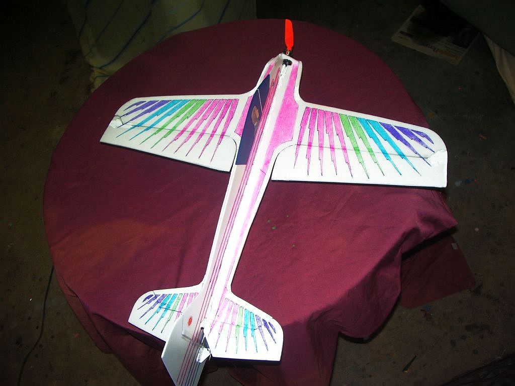

The artwork is a copy of Ampbombers paint. It is a stencil I made and use color pens. I sealed the color with a light spray of clear waterbase poly. I may have to add air brakes for the indoor yet.

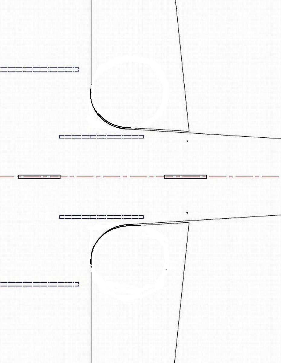

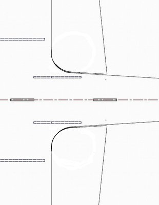

You can also get the free fullsize plan here. This is a 70% plan.
http://www.rcgroups.com/forums/showatt. ... 1326110417

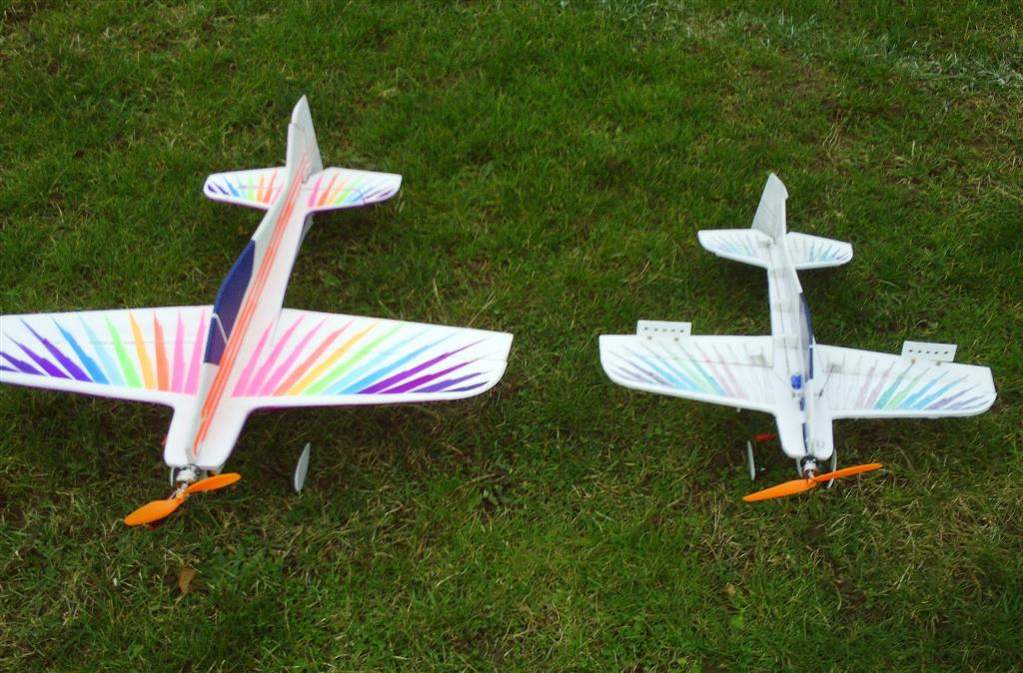

These are the first 2 Index 3's I built. I still fly the fullsize Index but slowly dying an aged death from many flights and bangs.. I will have to make another one sometime. The smaller 70% is the one I broke it up to make the new one above. The larger one fights wind real goodd-. It is a good plane.

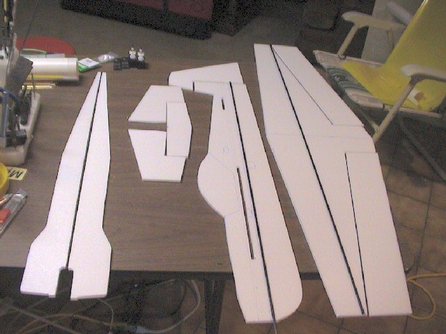

Hey Tom,

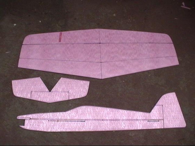

That is neat. That is the way I build all my profiles. I use blank CF arrow shafts for the spars in larger foamies. The smaller ones I split the arrow shafts down the middle. I still have about 10 sheets of the first generation pink foam Z-fold left. I am very careful now how I use the remaining sheets. The original pink foam is smooth and flawless (8yrs. old). The new stuff is all pin pricked and warped. Not good for my planes except if it is hidden like ribs and formers. I may have to buy blue Z-fold when I run out. I wish I could find a bundle of the first older pink foan with no marks on it again.

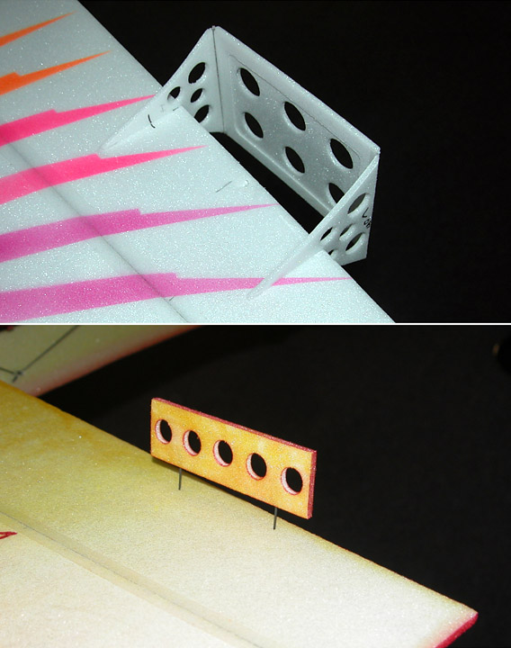

I am trying airbrakes That function with ease of mounting and removal. I am using thin clear plastic and 3 Depron angles glued to the control surfaces for the pins and to hold them flat. Just run the pins in to hold the plastic brakes. The plastic has paper punch holes on it in 2 rows. I am trying the rudder and elevators also the same way but not too wide. I believe it is going to be a good slow down without to much of a loss of handling. This will be most helpful indoors.
