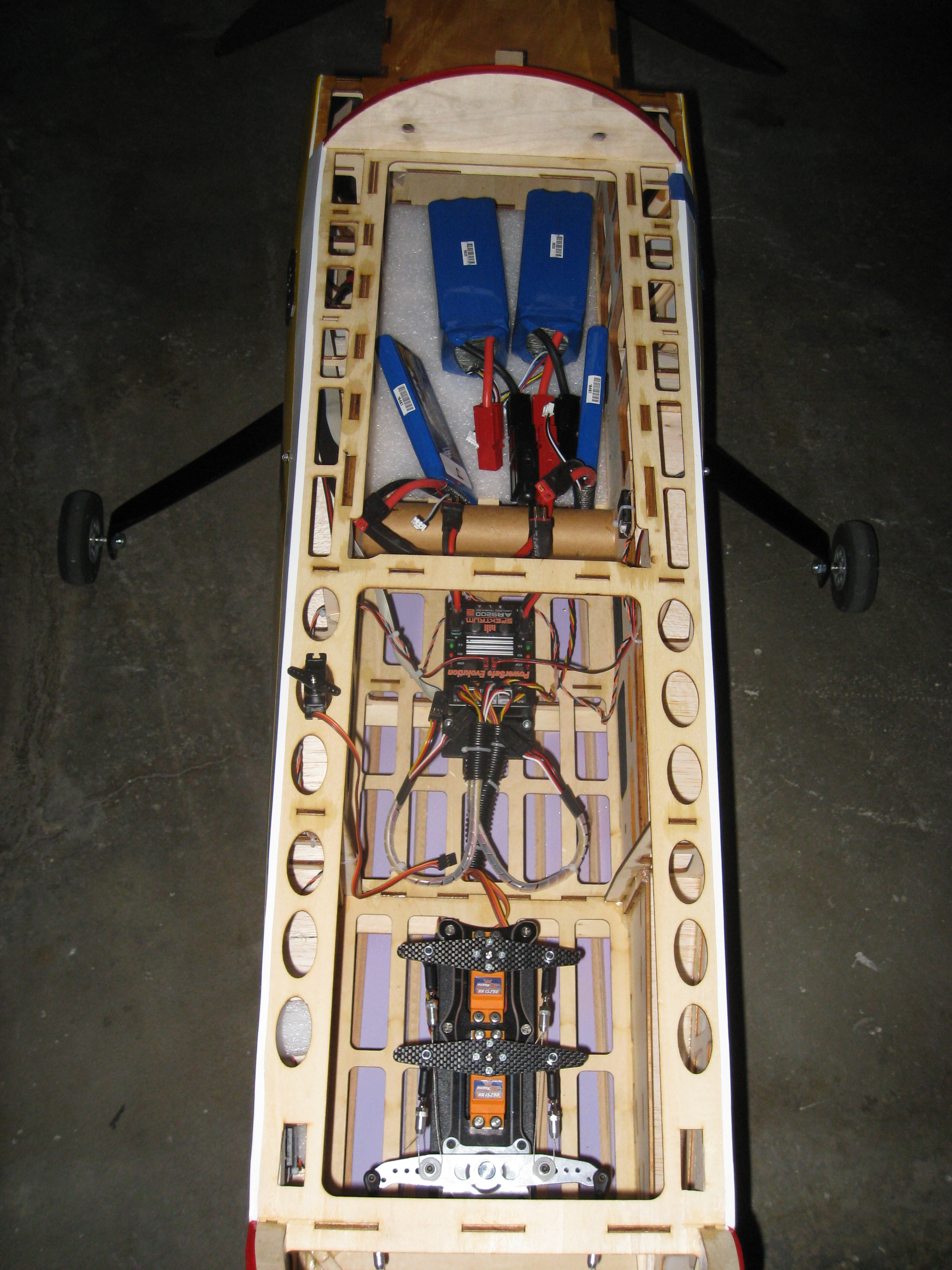

Here's a bunch of other build pics I've taken in the past... this baby should be ready in a few weeks I'm hoping (just have wing servos installation/setup to complete)

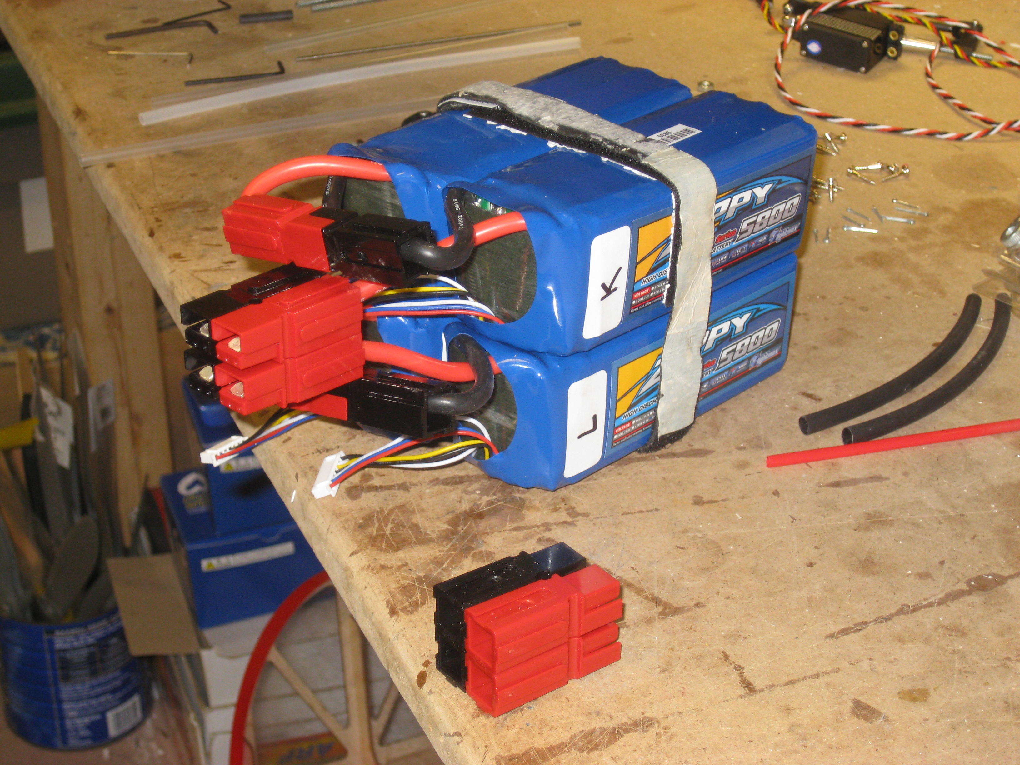

4 -5800mah 3s tied togethe. Big 8awg silicon wires, mega Anderson plugs. Great equipment well beyond anything I ever used, This is one very costly model. I guess I am a very conservitive builder compared to this. Great work and well thought out build you have done.
Re: 101" SU-26 Sukhoi - 100cc Electric Conversion
Neons wrote:4 -5800mah 3s tied togethe. Big 8awg silicon wires, mega Anderson plugs. Great equipment well beyond anything I ever used, This is one very costly model. I guess I am a very conservitive builder compared to this. Great work and well thought out build you have done.
Thanks Bob!
Actually, it's four 6s (not 3s) packs (5800maH each) :o Eventually, I plan to use four 6s 5800maH packs for propulsion, and two seprate 3000maH 2s packs for powering the receiver/servos (those you might had seen in one of the pics (one each side of the plane). With four 6s packs, I'm figuring around 28 pounds! :shock:
Price isn't all too bad actually... did lots or research... overall, probably a little cheaper than going gas (ie 100cc twin) - granted the prop alone cost $160 :cry:
I plan to make it's maiden in a week or two... and plan to use only two 6s packs vice 4 (12s, 5800maH instead of 12s, 11,600maH)... I want a light maiden, though it'll be a short maiden too.

I'm still fuguring out the CG on this beast... borrowed a huge plane balancer from a flying buddy today and determined that I need to scoot my batteries behind (towards tail) the main wingtube instead of in front of it as I had hoped... O well... I now need to move the receiver, regulator, etc... back a bit... what a pain! Hoping to maiden it next weekend down the Tiverton field if I complete the modifications. I might also order new batteries for this plane... instead of using four 6s packs (5800mah), I'm hoping to use 2 6s packs, but on the order of 7-8000maH. Should give me 7-9 minute strong flights.
