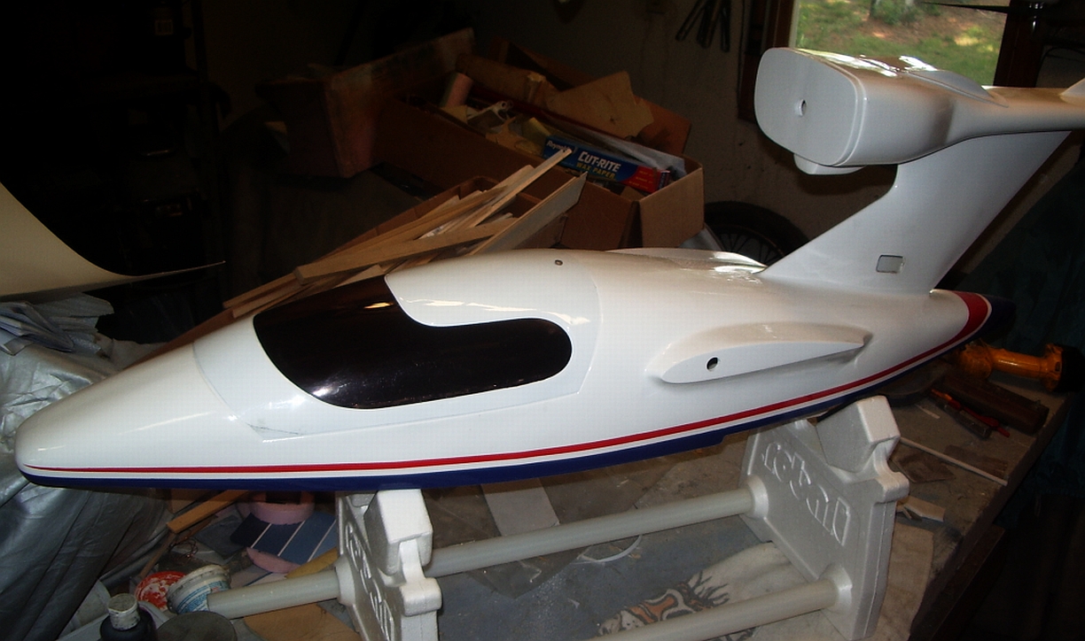

Carlos,
I have finished the canopy. It was a canopy from hell. I think that Nitro Planes should have given you another one. I moved it forward and the back was off 3/8" and I moved it back and the front was off. I had to compromise to save as much plastic edges as possible. I had to add a small piece in the lower ront edge as seen in the picture. To make matters worse, the whole stbd. edge was paper thin from the vacuum form that it was like a washboard. I had to put in long clear plastic with clamps to help stiffen and straighten the edge out flatter. It was a nightmare. You never would have got it done. I also got the top hatch mounted with a lip and 1 screw. Glad to see this one go. At least the worst is done. Shame on Nitro Planes for letting such crap accesories out the door.
