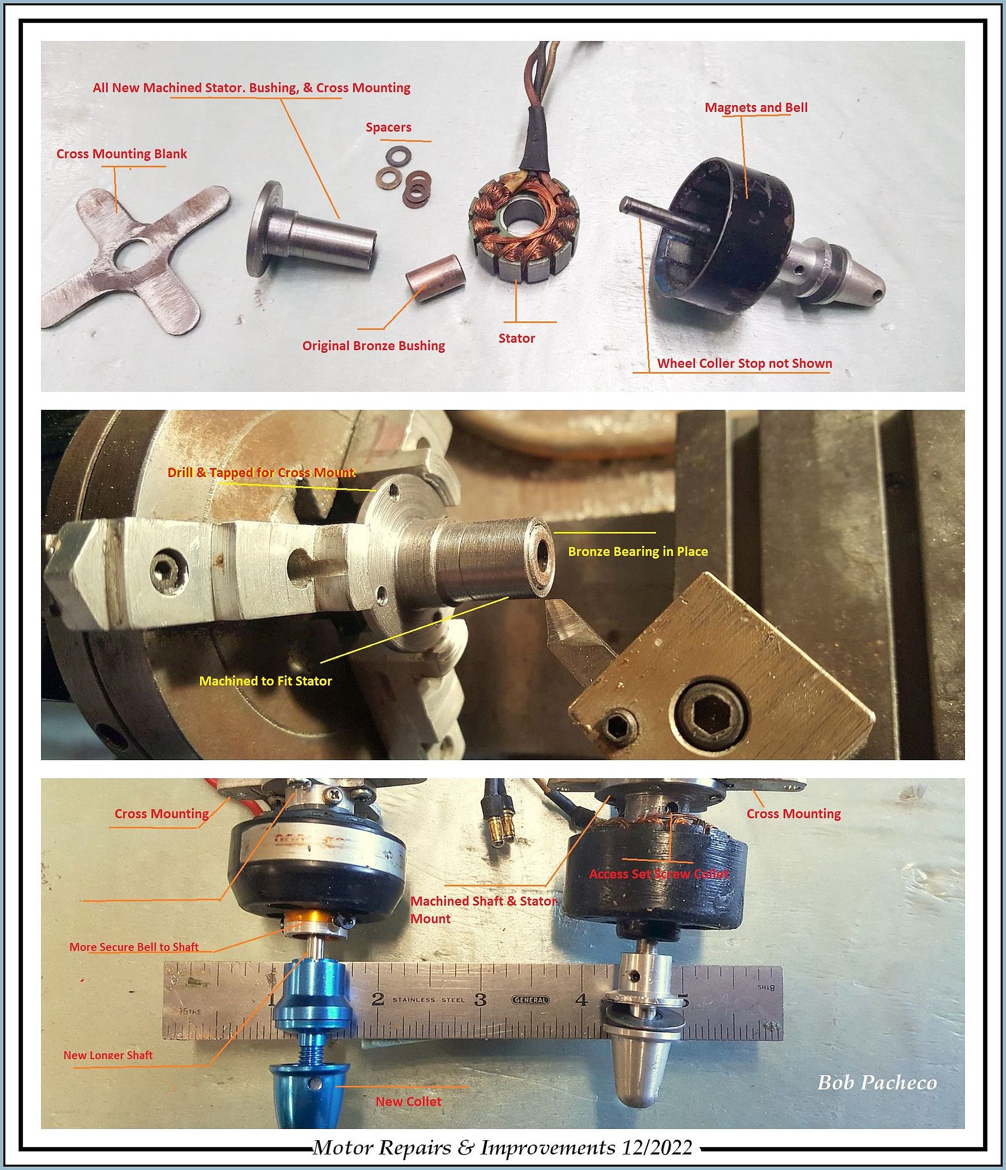

I had 2 motors that are torque producers that had problems after long usage and crashes. The blue collet motor had a short shaft and a loose bell. That got a new fitted bell collet and new mounts with light machining.
The silver collet larger motor was badly damage white metal mount that just broke like cast metal does. I machined a new internal bearing and stator mount which is flanged to take a new cross mount. Both motors are low rpm but throw 11 -12 inch props. These will be a plus for my motor supply.
Both are running very nice again.
