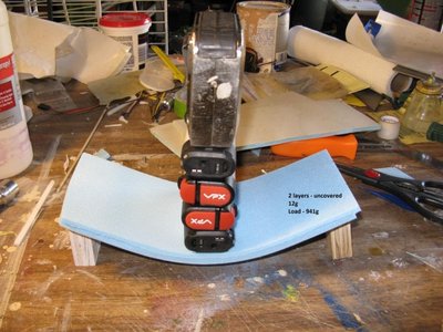

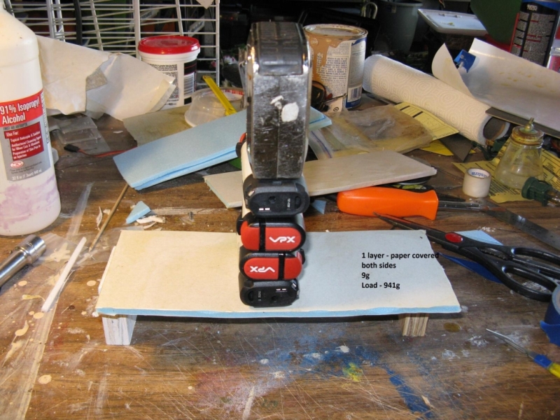

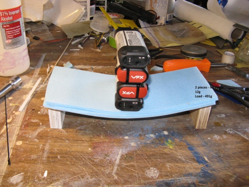

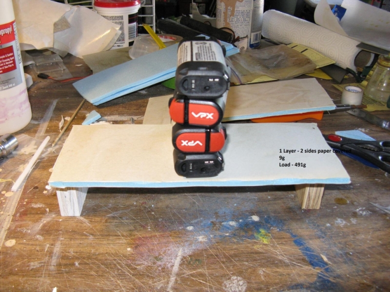

So lets look at just a paper covered wing compared to a similar uncovered wing. How strong is it? I think for most usage on a home made plane it is quite strong and could sustain a load of stress. This does not even have a spar in it. Here we look at a simple experiment to show how much strength is achieved from covering a foam wing with paper.

Click Pictures once to open a picture and twice to ZOOM

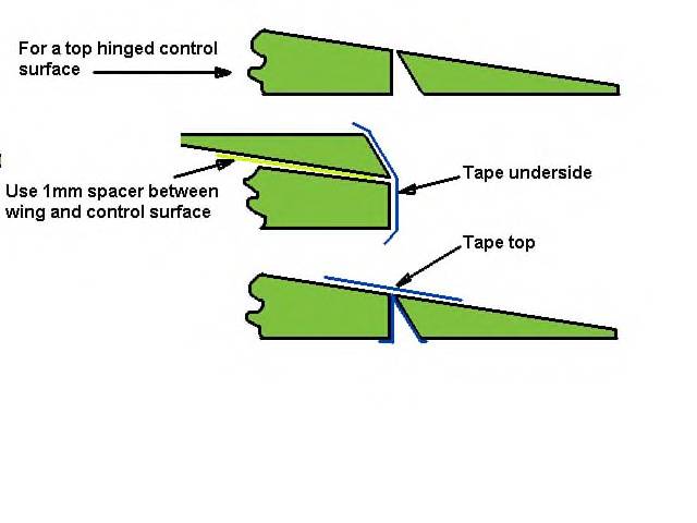

Do You Know the Correct Way to Hinge a Parkflyer?
Here is the very best way to hinge your parkflyer control surfaces. Make sure the 2 glue surfaces contact each other along the seam and it will last the life of the plane. The best tape is a medical tape called Blenderm. It is kind of elastic properties in it. It is not like stiff plastic package tape. It has a super sticking glue also. I feel it is the best product too use. You can get good deals on it by searching Google or go to your favorite hobby supplier. Du-Bro sells it as hinge tape. Remember do your painting first then tape. Paint will not stick to the tape.
The picture shows taping the bottom first and then fold over and do the top. I find if you do the top first you will have better control taping the bottom after. Leave no more than 1/16 inch gap when doing the top first. Then again, make sure the gap contacts each other. This is also known as the "H" pattern hinging
Thread here:
http://www.rcgroups.com/forums/showthre ... =tape+hing

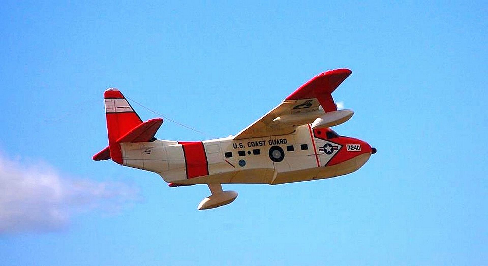

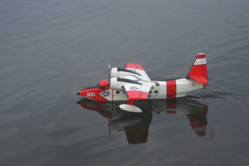

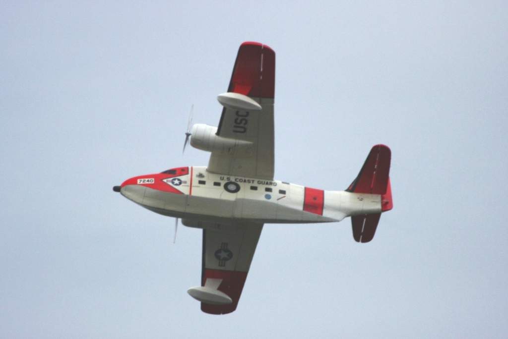

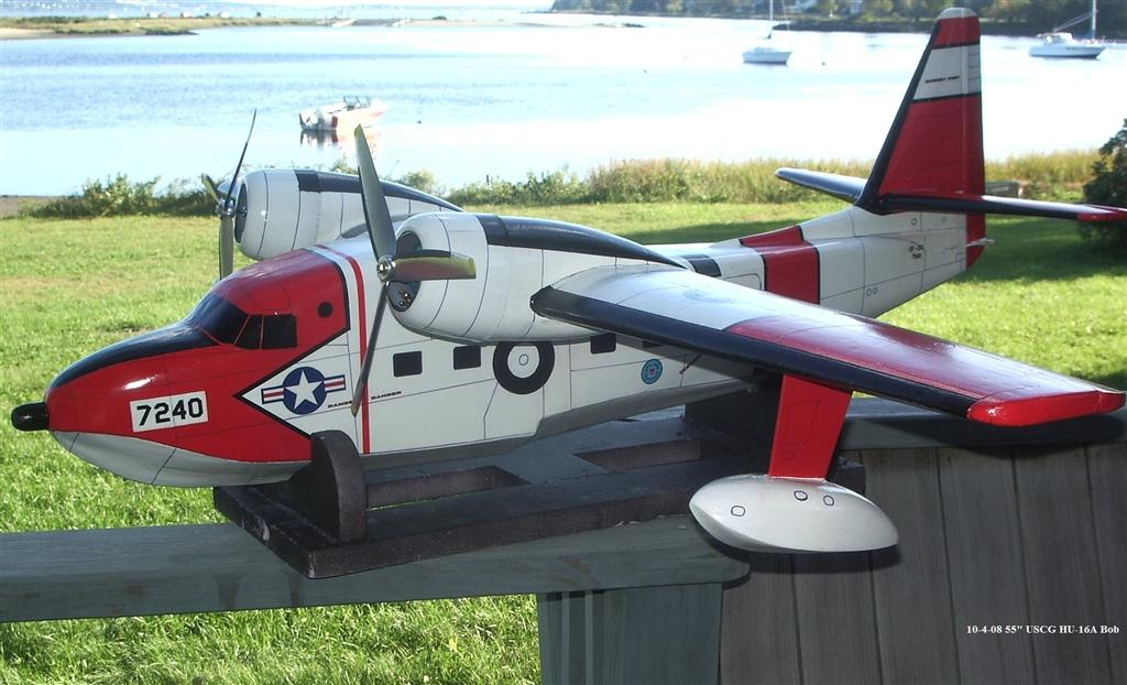

Grumman Hu16a Albatros Seaplane- Scratch Foam Built
10-24-10 Albatros Best (1a).jpg[/attachment]
Here is a totally scratch plane I have built using Pink foam. A detailed model book I put together for your use. This famous plane was built from 3 view drawings easily available. There are now some kits being made in the RCGroups Seaplane thread.
The Hu-16a Albatross I built in 2007 is a model of the U.S. Coast Guard seaplane that was stationed at Quonsett Point , Rhode Island down Narragansett Bay a ways.
