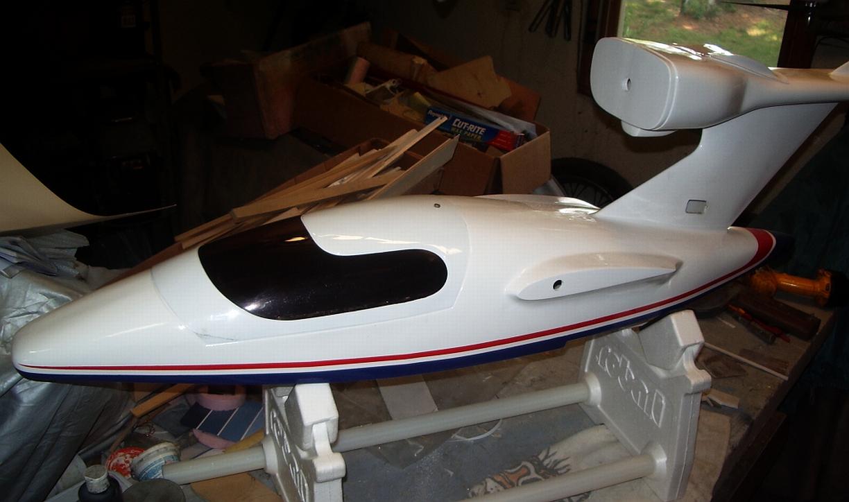

Back to your thread. I have both canopies framed. I have it spruce framed and 1/4inch foam floors. I am almost ready to cut Carlos plastic canopy and glue it on. I will post some pictures maybe later. I may be done on this plane later tonight.

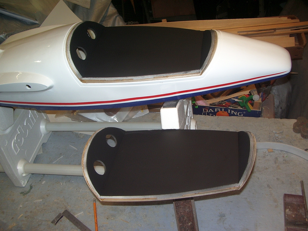

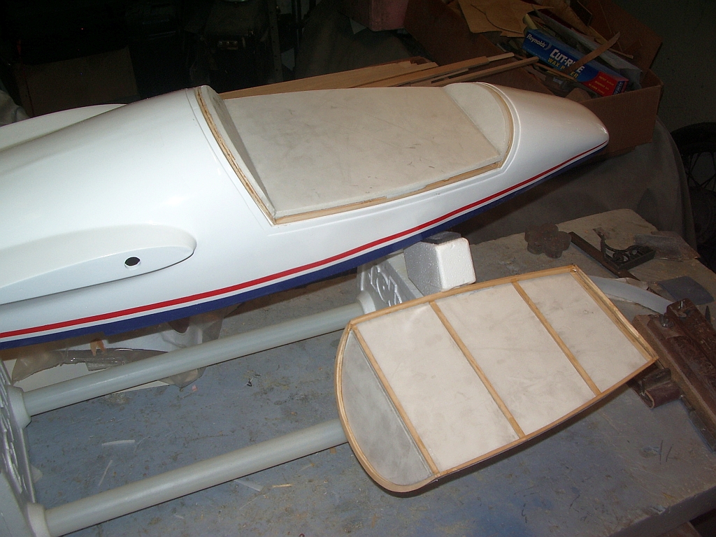

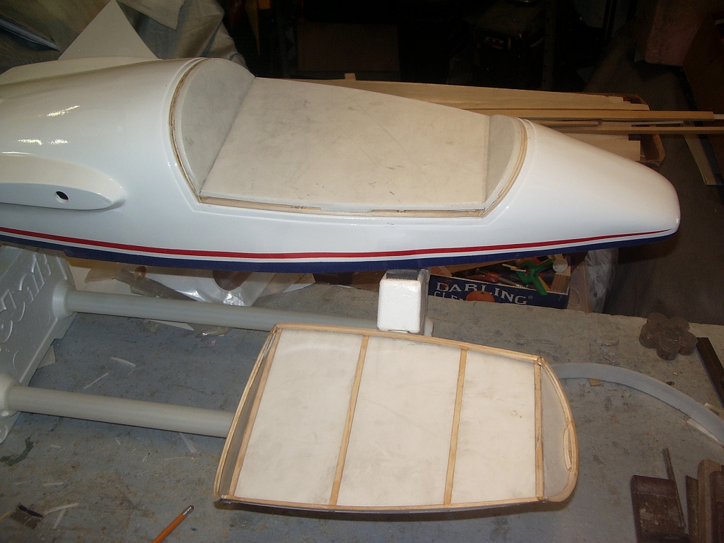

I was able to make the 2nd canopy frame today.What is done? Frames are 1/8" X 1/4" spruce. The angle ends are laminated ply and jigsawed to the arcs. Then I added the angles and floor in 1/4" Depron foam. Very rigid now. I have keyed the front edge to lock down the framed canopy to the hull. I have to cut 2 large holes for airflow in the rear angle. Then I am ready for the flat black floor. After that it will be glue up the plastic to the frame nd trim the edges. I have a change in plans tonight and have to go out so I will continue tomorrow. Provisions for magnets and a lift latch also have to go in.
In other notes. Ed needs magnets for his canopy. I do not have any. I also noticed the plywood frame for 2 servos under the canopy. . My recommendation is to place the rudder and elevator servos in these mounts and cable them to the rear. Dis regard the rear mounted servos. Why? Weight is a problem in the rear of the plane as you have the motor there.. The battery may not get the balancing CG correct. Better to mount as much as possible in front of the CG. For every ounce behind the CG you may have to add 2oz. in the nose to counter it. It will also mean that adding gear forward of the CG will make a lighter plane and a better handling model.

Bob,
You are truly amazing!!!! It looks fantastic I can't thank you enough...........
How many magnets do you need for Ed's plane? I will bring them with me to the float field on Sunday if your there. I will be at my cottage all weekend starting 20 minutes from now.
Ed is amazed at your expertice. I do have one question. If we use the front to mount servos and I believe that is a good idea, How do we plug the hole thats precut in the fusalage?
