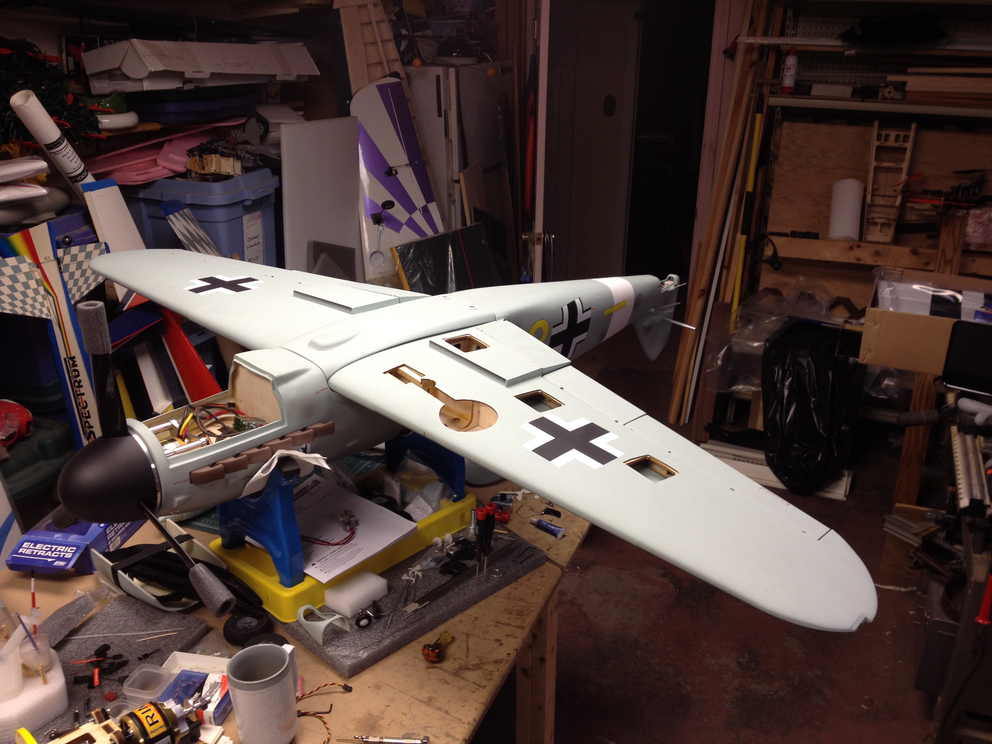

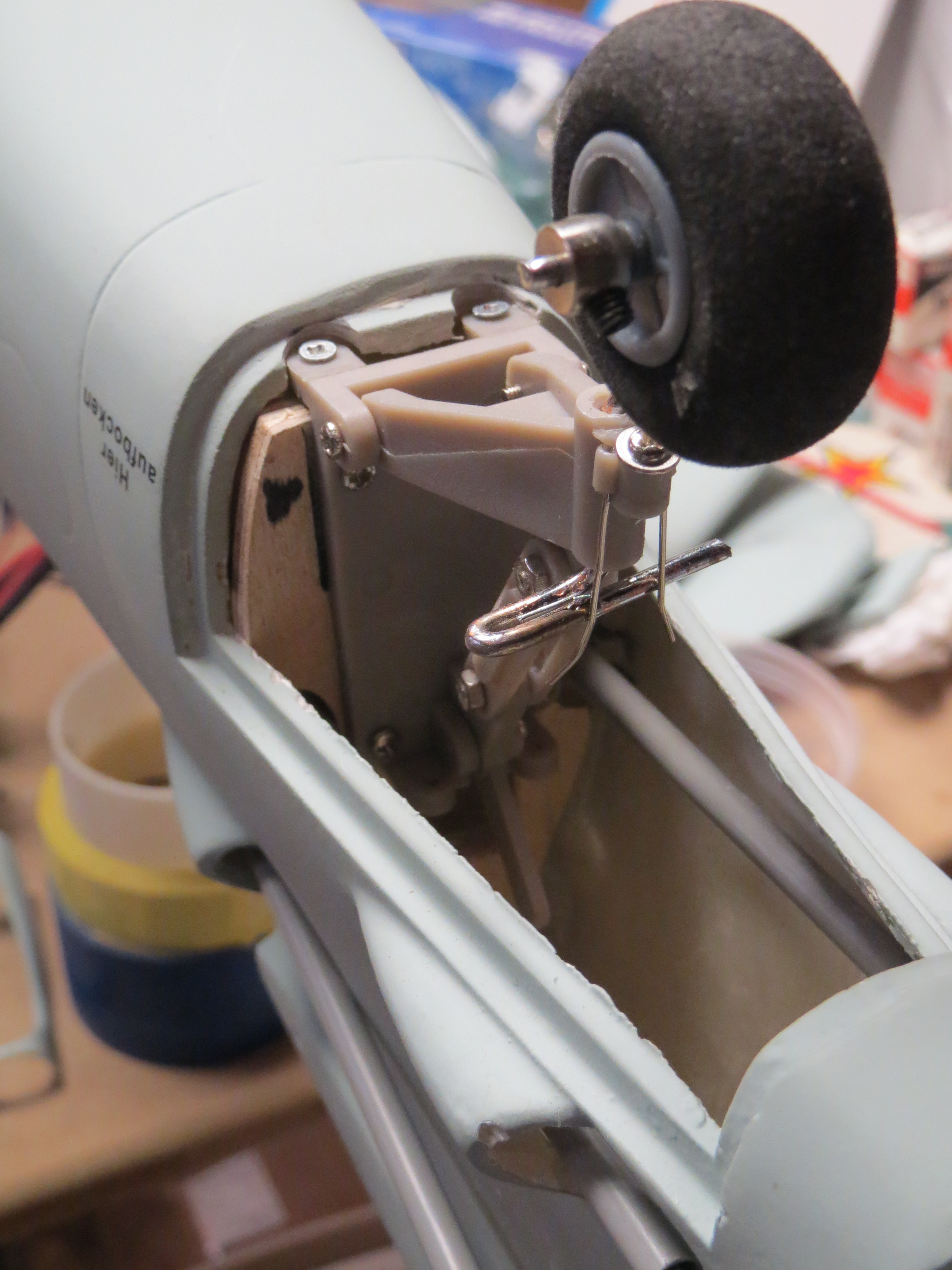

Actually, I have in fact been working on the BF-109F Wings at least... all 6 servos and 2 retracts worth...
L/R Ailerons, Flaps and split drag brakes... got all the mechanics sorted out, including a custom electric retract tail-wheel.
Just need to sort out mechanics in fuselage (2 servos for rudder and elevator)... then get figure out where to mount batteries for good CG (looking like right over wing tube which would be cool)
I'll try to post a few more pics soon... it's going to be a pretty plane when finished... nice detail out of the box.

Looks great. I forgot what Bf-109G series that actually started to have a retract tail wheel. The earlier Fritz was fixed. Probably after the Gustav G-6 series. They had planned on full wheel covers also to grab a bit more speed too. It was already to late.

Thanks Bob...Neons wrote:Looks great. I forgot what Bf-109G series that actually started to have a retract tail wheel. The earlier Fritz was fixed. Probably after the Gustav G-6 series. They had planned on full wheel covers also to grab a bit more speed too. It was already to late.
Supposedly, the "F" versions were fitted with semi-retractable tailwheels... The last production G-2s were fitted with the enlarged mainwheels and tailwheel (no retractable tailwheel due to lack of room) while the first of the G-4s used the smaller wheels with tailwheel retract. All K-4s were to be fitted with a longer retractable tailwheel ... and I think I read all A through D variants were fixed tailwheels.
Here's a quick vid...
Re: Electrified CMPro BF-109F Messerschmitt Warbird...
Very nice setup. I watch that retract and I visualize retracts for a Grumman Goose type or PBY fuselage retracts. Of course they would be larger and the wheels facing 90 degrees to the opposite, It would make a nice amphibian setup in jumbo size..
